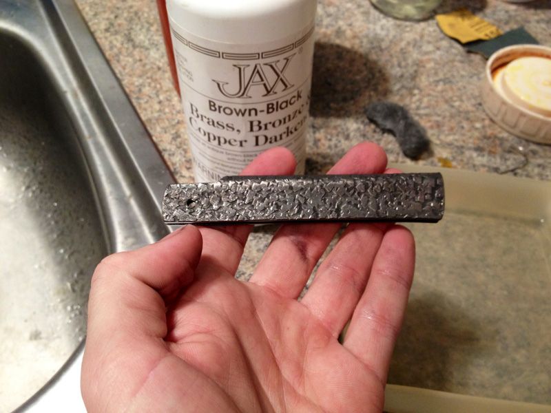

Gave the handle a patina. I like Jax better than liver of sulfur for copper.
The problem with Jax chemicals is that they're almost all considered hazardous when shipped.
If you can find it somewhere you can pick it up do it and save all that shipping.
Took the black off the high parts by rubbing pumice over it with my thumb.

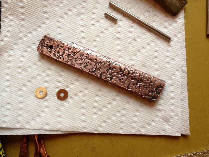

Everyone is here. Well, that is just a working pin. I'm going to cut a new one in the next step.
I use a long length of pin stock for this part. First, I mark how long I want the pin to be.
Now I put one of the washers in the handle and on the pin stock.
The blade goes in, and then I slide the other washer in.
I position the washer with another piece of shim stock until I can push the pin stock through.

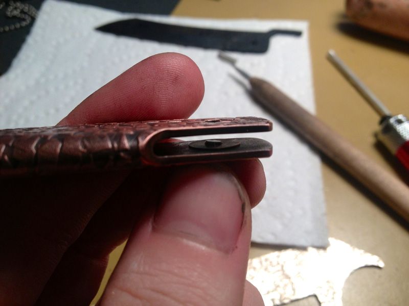

When I pin these together I slide another piece of shim stock around the pin to keep from getting too tight as I peen the pin.
I also tape the blade shut so I don't have to worry about it moving around.
I peen the pin evenly on both sides with the shim in. After I have a good head on the pin I take the shim out.
At this point I take the tape off so I can move the blade around and check the snugness.
Now I carefully peen more to tighten the pivot.

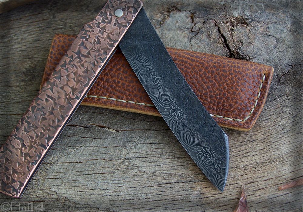

So here it is.
• twist damascus (15n20 & 1084)
• textured copper handle
• bronze washers
• stainless pin
• leather pocket sheath
• 7 3/8" open
• 4 3/4" closed (including the flipper)
• approx. 3/4" wide (excluding the flipper)
• 3 1/8" blade (plunge to tip)
• 3/32" thick at the spine

I may have missed this, so forgive me, but is there anything that holds the copper channel open for the handle (it seems like anything would get in the way, but then copper folds sort of easily at times)?
Would it be ok to put the copper around a piece of sacrificial steel and texture it after folding and shaping, so you could get a nice work-hardened effect on the copper?

nothing holds the channel open besides the spine of the copper piece.
i guess i didn't specifically mention it, but the folding process does work harden the copper.
and the further flattening with the rawhide while it's on the steel plate hardens it more.
i've made several of these, and they all seem to harden up well. and i haven't had any issues with it wanting to close up.
if you're still worried you could try a different material for the handle.
i've made a few with just mild steel as the handle, and i'm working on a stainless one at the moment.
those get in to different issues mostly in the folding because you have to fold them hot.
brass would harden more than copper, but i'm not a fan of brass.
and you could texture it after you fold it, but then the spine wouldn't really have a pattern.
hope i answered your question somewhere in there.

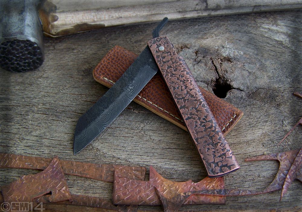

I might have missed this among the gorgeous pictures of the manufacturing process, but does the blade use the ricasso as a stop against the handle when closed, or does the edge hit the back of the handle?
I'm aware that the question might be asinine, but I've got several knives in which the edge hits the back of the handle or spring (I'm looking at Buck knives here) and I can't figure out if this does the same or if there's any risk for it after a while if the ricasso digs into the metal.

Depending on the shape of the blade either the edge will hit the back of the handle or the ricasso will be the stop.
Some people will put a stop pin right near the spine and the inlet for the flipper to keep this from happening.
I don't usually because sometimes it lifts the point of the blade up and I'd have to compensate with a wider/fatter handle.
