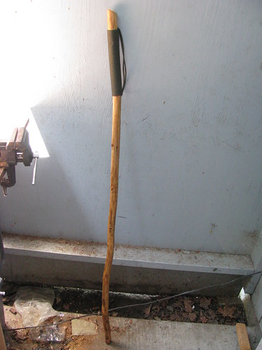

Personally I use a coating that I made that contains linseed oil, pine pitch, and cut with turpentine.
I coated my wife's staff this way, and use a copper end cap like you say. I don't think you will need the 6" pipe or any other wrapping. The finish dryed pretty hard, but that may be due to the addition of the pine sap? Either way, it is pretty waterproof and durable, and adds a nice darkening to the wood that tung oil won't.
I wrapped a section of paracord for the handle area and left a lanyard loop.
Here's some pics:
