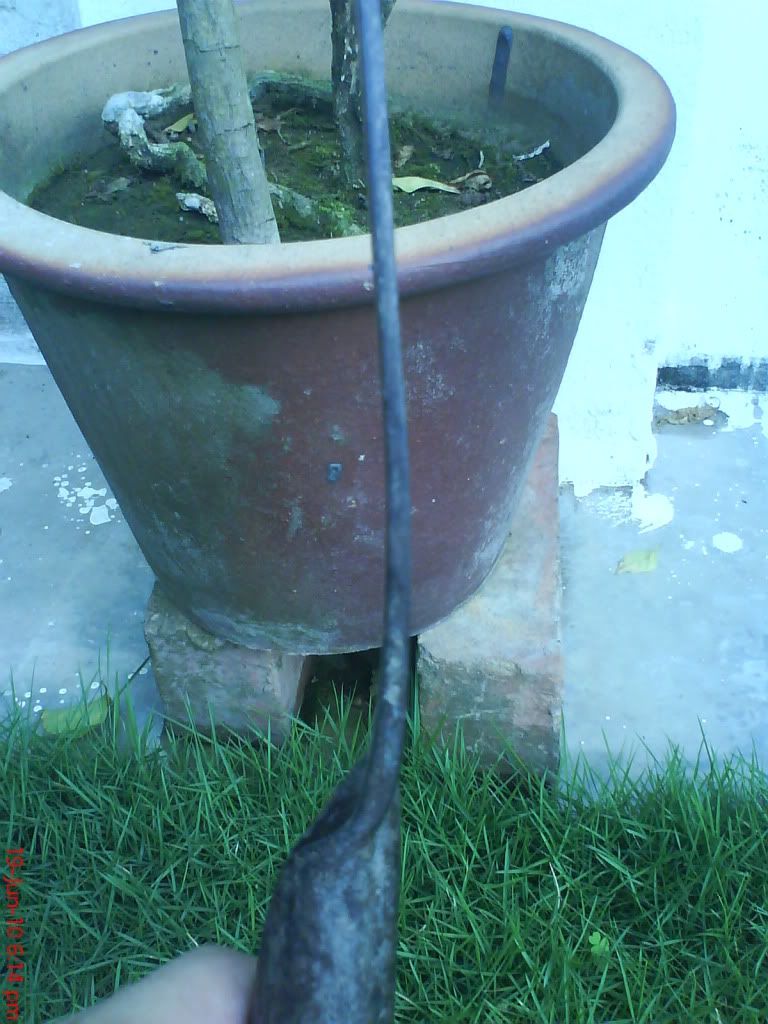

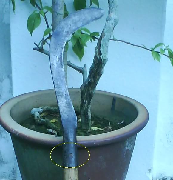

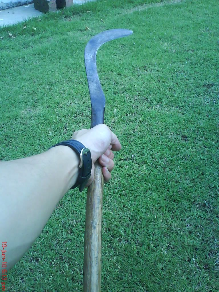

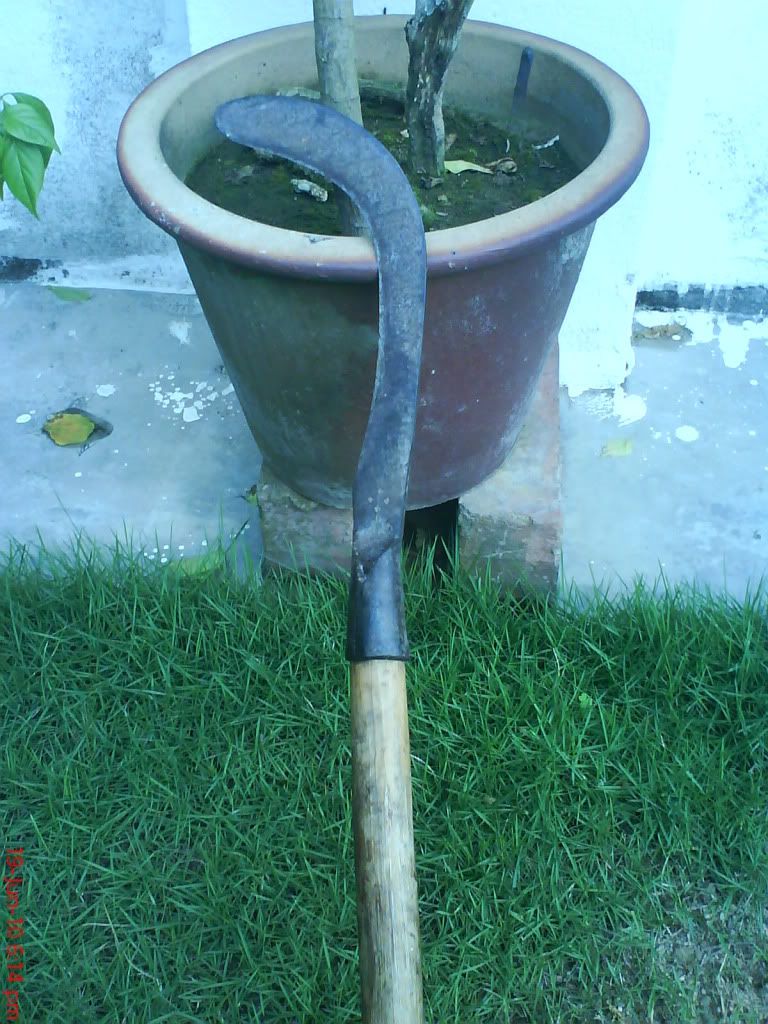

Was helping my grandpa with some weeds off the tree and used his old sickle/blade (in Malaysia we called that SABIT) he's been keeping sharp for many years. The tool was bought 40+ years ago.
Pardon the bad camera pics
Notice the tiny hole (inside the yellow circle) so you can hit a nail onto the handle
He chose a branch off a guava tree for the handle (termites and moisture-proof, as the humidity in Malaysia is high).The longer handle makes it easier to maneuver the blade.:)
If needed i will take more detailed pics.
