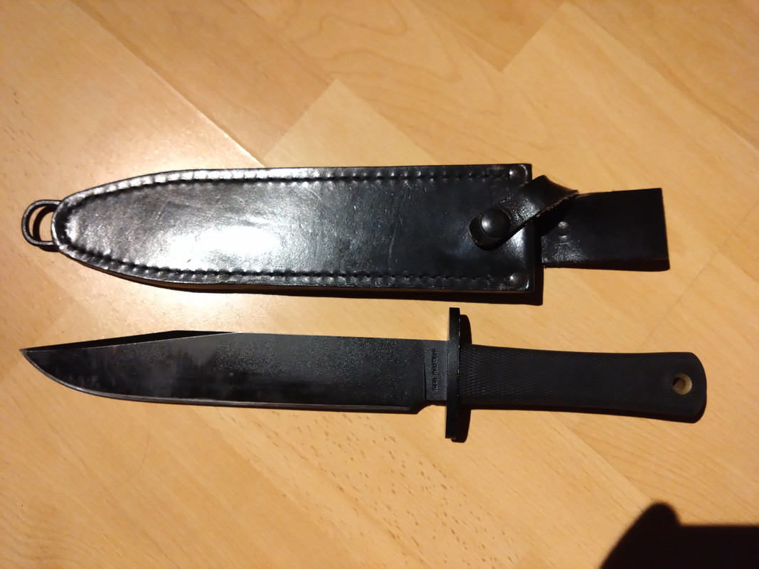

I aqcuired an older Trailmaster on the aftermarket two years ago. It looks exactly like the model "16CB" depicted on the first picture in post #3 (and the one depicted in the official catalog from 2005, page 25) -regarding stamping, choil, sheath etc.
The coated blade is not stainless, so I'm pretty save to assume it's carbon steel (if it's really from 2005 it should be Carbon V)...
The lanyard tube is brass.
Since the knife has obviously been quite heavily used by its previous owner, the coating has come off the guard in some spots.
The metal exposed on the guard is of silver colour and doesn't look at all like brass to me. More like steel or maybe nickel silver.
Also, the exposed metal on the guard does not tarnish like brass does (...the lanyard tube is tarnished and its brass looks completely different than the guard).
[I even filed off some tiny flakes to chemically check if they contain copper, the main ingredient of brass (I'm a pharmacist and able to access some chemicals...). The test was negative - I don't rely too much on this test, though, since the amount of shards was very small, hence it was maybe not sufficient for a proper detection... I did't do a blind or comparitive test.]
All in all, I assume the handguard is not brass. Which brings me to this statement from the opening post:
All carbon TMs (Carbon V, SK-5, O-1) have brass guards and lanyard holes, even the guard on the black epoxy-coated version was brass underneath. All stainless TMs (AUS 6A and SMIII) have stainless guards and lanyard holes.
Is there actually a source for this information? I didn't find anything, anywhere else about that.
Of course, it might be possible I acquired a fake version. But the knife doesn't look like the other fake versions you can find online. Also, the dealer is long established and reknowned in the "knife scene" over here; and he doesn't sell fakes or other crap.
(The price was reasonable for a sought-after knife like this in such a used condition, even if it's not in Carbon V.
Moreover, it doesn't seem very likely to me to use brass as a metal in the first place if one plans to cover it with black coating afterwards (...normally brass is used because it looks like -you know- brass...). I can't think of any other example, where brass has been used on knife hardware and was coated afterwards.
Anybody else who owns a carbon version without a brass guard?
Thanks in advance for any help and/or information...

You're probably right... 😉
Knife with sheath:
Handle for camparison lanyard tube/guard:
Close-up guard:
Close-up lanyard tube:
Stampings - just for reference...
Sorry for the crappy pics. Had to take them with my mobile since I don't have a proper camera at the moment.
I hope the difference in the colour of the metals is recognisable.

I definitely agree that your guard isn't brass. Can you test it with a magnet to determine if it's ferrous? It's just my supposition, but I believe it's probably aluminum. I say that based on Cold Steel's past use (though both rare and brief) of aluminum guards on the Tanto.
Here are another member's photos of his uncoated Tanto guard in aluminum. (The pommel was also aluminum.)
While I don't know it for a fact because the coating is pristine, I'm fairly certain that my blackened version of that knife also has an aluminum guard (and pommel). It definitely doesn't feel like brass.
It seems to me that aluminum would be easier to coat than either brass or stainless steel. It certainly would be cheaper than both.
If aluminum was used instead of brass or steel, I wonder if Cold Steel was even aware of it. I'm not making any accusations or questioning any company's integrity, but an unscrupulous manufacturer trying to cut costs could swap the materials used on a coated part without ever informing the client. (However, I have to believe that the rigorous testing to which Cold Steel subjected its knives would expose such fraudulent actions pretty quickly. Evaluating manufacturing quality was one of the reasons that Cold Steel conducted the destruction tests.)
-Steve
Geez, ...why didn't I think of that. 🤦‍♂️ I am so screwy and nerdy, that I think of filing off shavings for a chemical analysis instead of going for the much simpler solution. 🤪🤓
To make it short: Yes, the magnet sticks. Not quite as strong as on the blade, but it sticks.
Thanks.
So it's not aluminum after all but some type of stainless steel. Good to know!
