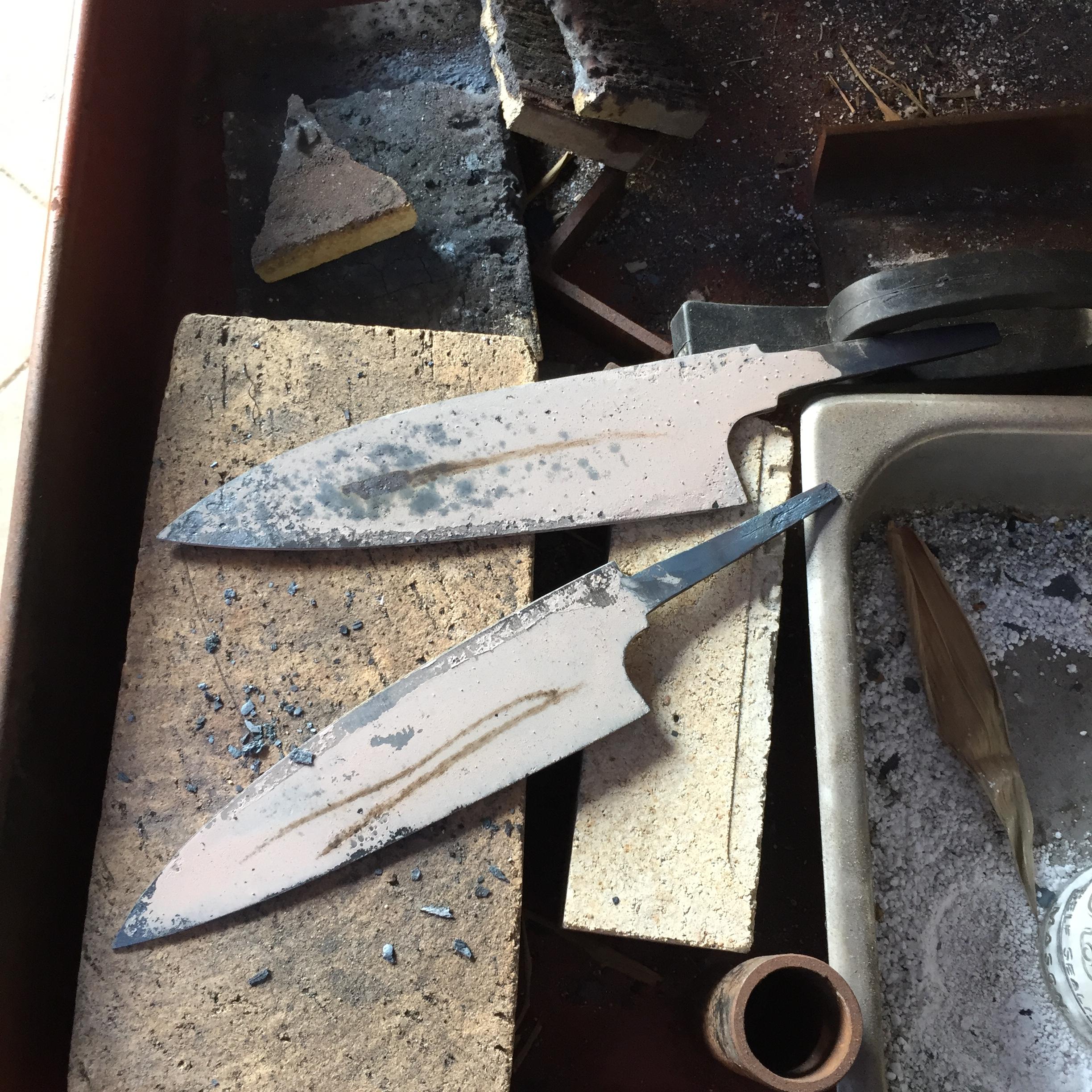

I just finished quenching 2 white steel #2 blades I've been working on.
Before heat treatment I normalized the blades each blade 3 times. For that proscess I used what I saw in a video by Murray Carter, setting the blades in ashes to insulate the heat while cooling. I did a 5min soak in the gas forge, paying extream attention to the color of the steel (I have been practicing this for almost a year now). I was afraid to do a full water quench and crack such a hard to get steel, so I did a interrupted quench. The quenching solutions were warm salt water and warm canola oil. I quenched for 1 second in the water then finished in the canola oil. No pings and no pops.
After the quench I rushed to get the blades in the tempering oven as fast as I could. I was very afraid that the blades would develope micro cracks if I didn't temper them right away. On the way to the oven I noticed that there was what looked like to be a hamon. It was too high up to be the separation between the core and cladding, the cladding comes about 3/16th from the edge.
After doing the second blade I noticed the same features while rushing to the oven. My thoughts are that this is carbon diffusion from the normalizing cycles I did and soak. I did not forge the blades because of how thin the stock came, I only did stock removal. So I didn't expect carbon diffusion to happen this fast. I wasn't sure if only 30min toatal of normalizing would actually have a great enough effect of the carbon displacement.
If this was carbon diffusion, does that mean that when the steel is joined with the cladding at the Hitachi mill some carbon diffusion also occurs? I assumed that was a process that takes much more time.

If it was a honyaki White #2 blade, I would say that it was an "accidental hamon."
First thing you need to tell us in a question like this is exactly what the steel is.
Since you mention "core and cladding", I assume the steel is a san-mai with a #2 blue core. If the sides are low carbon steel, then there will be no hamon. Carbon diffusion take a long time at high temperature and has to have many parameters met. It doesn't happen to any measurable degree in a HT.
Second thing we always need to know is how the HT was done. What type forge, times, etc. You gave part of that.The image shows heavy scale.
It looks like the HT was done with a very oxygen rich atmosphere. All we can see right now is scale, which tells nothing about any hamon tat may or may not be there.
Last thing we will always need to see ( especially in a hamon question) is the blade ground clean of scale and decarb. Preferably anclean ground photo at 400 grit and then one with an etch in FC.
The steel is Hitachi white steel #2 with mild steel cladding. I use an oval 2 burner devil's forge propane forge with a 100lb tank and 0-20 psi regulator. When heat treating blades I use the lowest psi possible without turning off the forge. I brought the blades to the color that I would quench at then stuck it in a large can of ashes to cool for 10 minutes (did this 3 times on each blade). For the quench I brought the blade to a shade over non magnetic, then very slowly moved it left and right from the forge lining and the center of the forge. This keeps the edge just over one shade above non-magnetic (which to me looks like a medium-dull-orange). Once I begin to see the color stabilize I start a stop watch on my neck that counts down 5 minutes. I keep moving the blade left and right from directly under the burner to up against the forge lining. This keeps the color from changing. For the whole soak I look directly at the blade and use the color of the forge bricks, spine of the blade, and edge of the blade to monitor the color and make sure it isn't getting hotter or colder.
I had the salt water and oil 1 foot from the forge. Once the timer beeps I hold the blade still for a 3 count to compensate for the time from the forge to the quench. Once I dip the blade in the salt water solution I count "one" out loud then quickly move it from the water to the oil (heated to 120 degrees using electric hot plate and a thermometer).
I didn't think that carbon diffusion would have a chance to occur, that's mostly why I was confused. I posted this to see what else it could be. I only used the word hamon as a description, I know there is no way the cladding formed a hamon.

Sound like you should have a good blade. All sorts of colors and things can show up on the surface after a quench. Most are either a scale or decarb effect.
The other thing is the difference between hardened steel and unhardened steel. This is sort of what a hamon is, but it can also show up in a lower carbon steel where some rapidly cools enough to form a pearlite-martensite mix and the rest stays pearlite. Even 1018 will harden to some extent in a water quench. I see it when I dunk a too-hot bar of mild steel in the tank to cool it off. You get bands/zones where there is clearly a difference. I have had 1030 snap in half be becoming too hard and brittle in doing this. We often forget that just because it won't make a knife edge doesn't mean it won't get hard.

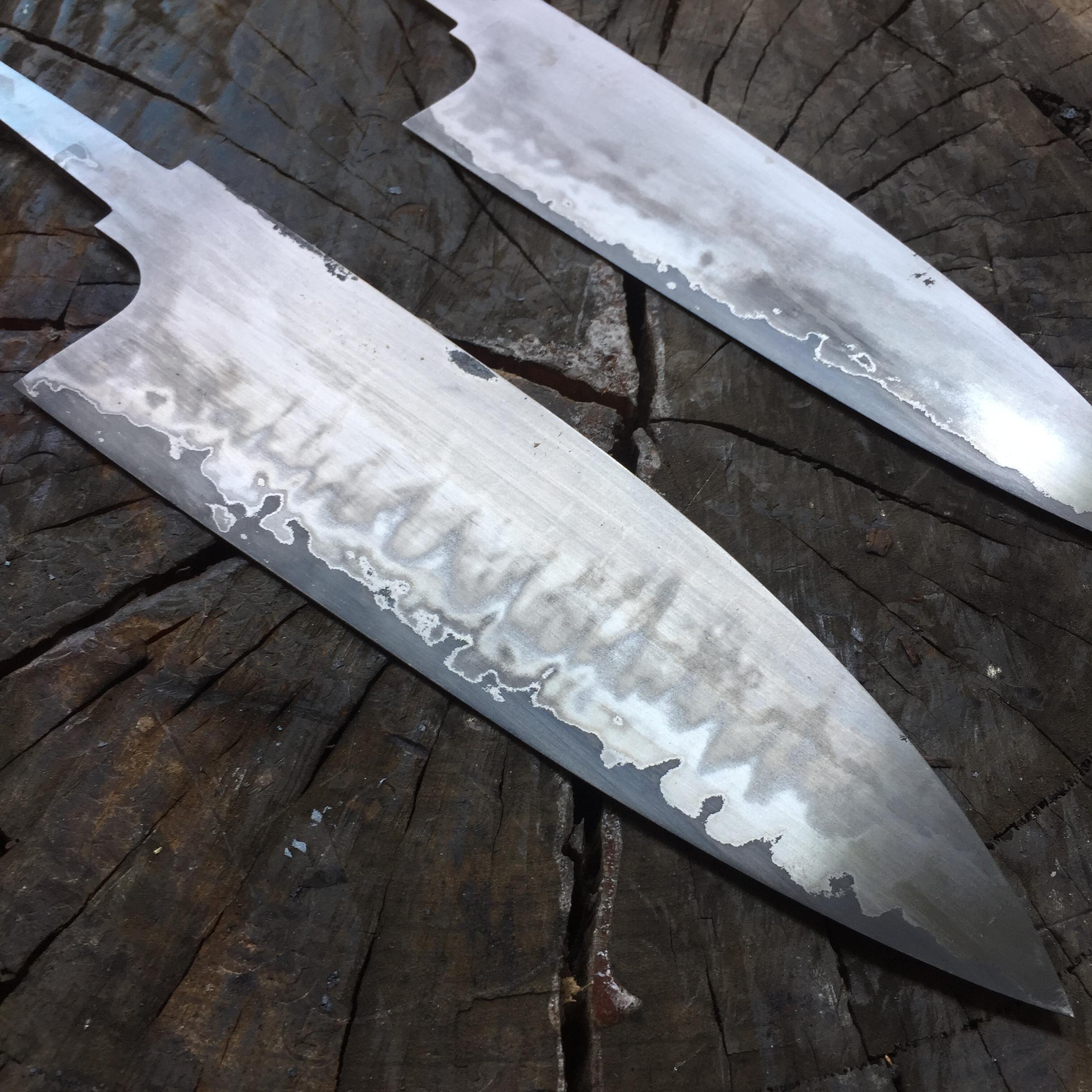

I'm working on hand sanding the blades and I'm at 600grit right now. I'm starting to clearly see the hamon like line appearing.
Here are some pictures I took of the blade I am polishing. On the edge you can see one section that is the white steel 2 core, then you see a middle section which is the mild steel cladding that hardend, then finally on the right you can see the section of un-hardened mild steel: https://imgur.com/a/ecOeq
I am absolutely amazed that I was able to do something like this. I can't even describe how proud I am of how this heat treatment turned out. I will be fallowing up with more pictures as I polish both blades.
I'm considering doing some differential polishing when the blade is all done to show off the contrast between the 3 sections of the blade.

Here is an update of how the blades are coming. I sanded by hand instead of using my grinder because of the familiarity I have polishing is greater than grinding. So this fallow up took a bit longer.
I brought both blades up to 800grit then etched in my FC ( 1/6th FC 5/6th water) for 5min. After the etch I lightly brushed each blade with 1000 grit sand paper. Here are picture of the results: https://imgur.com/a/8VOjd
The drop point blade has a larger gap between the lamination line and the "hamon" line we were astringent before. Where as the sheep's foot blade has a much smaller gap, closer to what HSC described in his pictures.
I noticed directly after the etch that the white steel blended in with the mild steel next to it. This made it hard to see where the core is in relation to the rest of the blade. What causes this to happen? Is it from carbon diluting close to the white steel? Or did the mild steel harden to a degree where it was thinner, closer to the white steel? (Both blades have a full flat grind).
Next I will be sanding both blades to 1000 grit, etching, brushing with 2000 grit paper, sanding with 2000 grit, etching again, then differentially polishing the hard and softer steels along with some light etching. I will keep posting pictures as I go from here.

With san-mai, there is almost always some variation in the two sides. If the difference is as little as 1/8", it is probably well within normal. As long as there is 4-6mm of hard steel ( ha-gane) showing the knife will perform properly.
