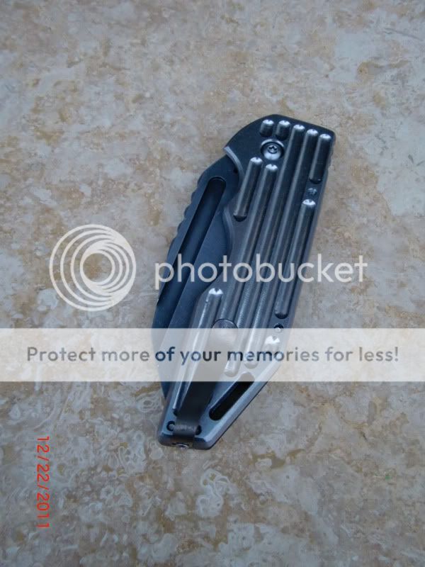

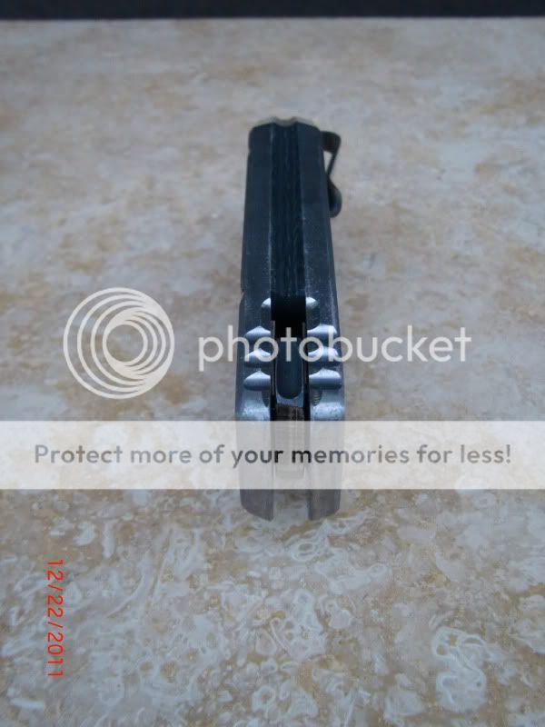

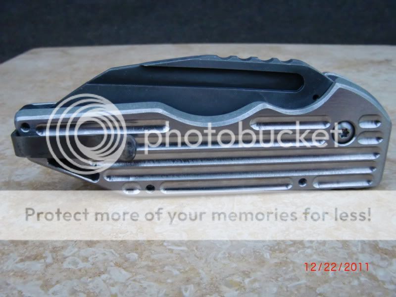

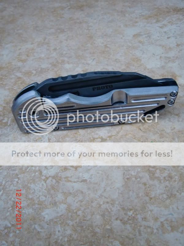

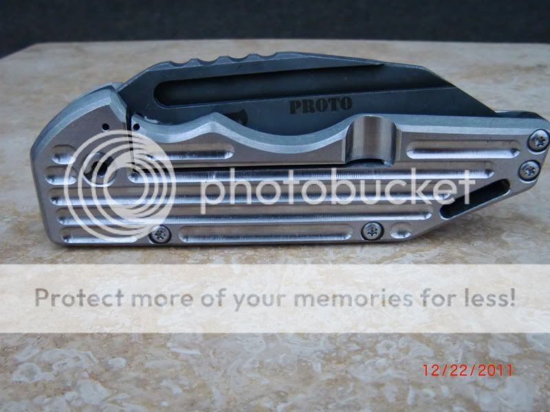

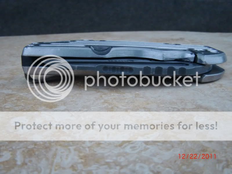

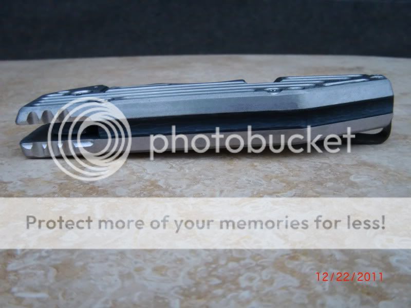

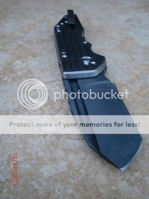

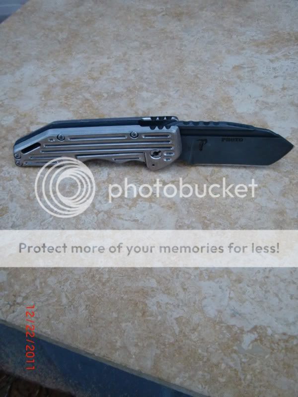

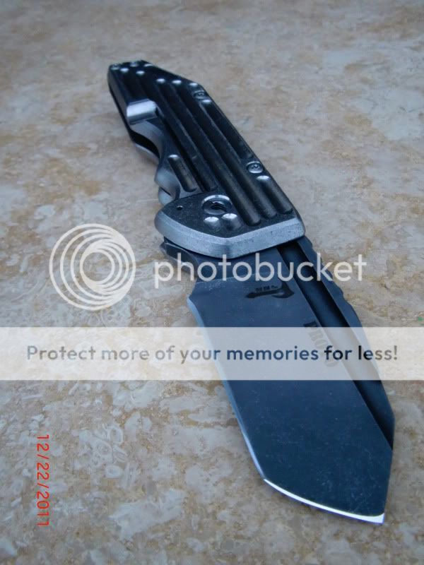

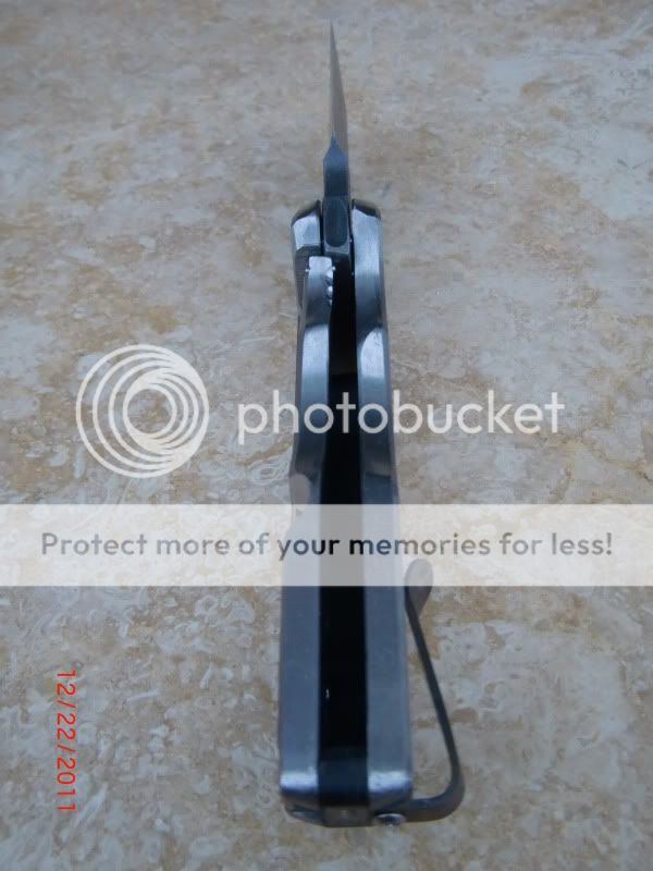

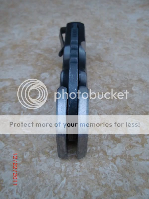

Well I got her done:) Shes gonna go out to Chad, maybe to some friends too:mc101:
.195-.200 thick 6AL-4V titanium slabs
.197 thick CPM154CM blade
Carbon fiber back spacer
4 4-40 screws holding the frame together
internal 1/8 thick tungsten carbide stop pin
Bearing system
1/4 hardened pivot
Red tritium dial in the carbon fiber back spacer.

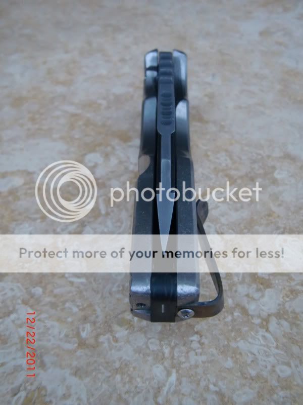

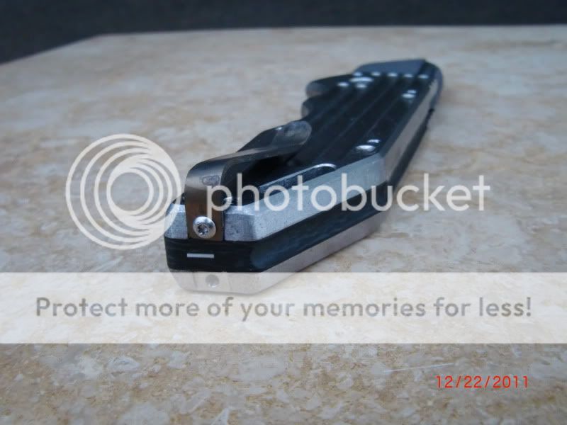

2 clips come with the knife, one for each side of the end.
Beef!
The next batch of these will come with a touch longer blade. Prob 3.75" or so. I will also come up with a easier to make clip system that doesn't involve 2 clips.
Verse inside: John 15-13 Greater love has no one than this: to lay down one’s life for one’s friends.
sorry the pics are a little dark
You used a fuller design like the Spyderco Vaporware (until it's in my hand) Tuff. That's very interesting to me, and you seem to use it in place of a thumb stud or opening hole, I've had the same idea for quite a while, and was hoping somebody would do it. Great work!
Honestly have never seen that knife:) very cool though. Thanks for the compliment
No, no, brother. I wasn't saying anything like that. I think it's a great idea to use a fuller which doubles as a means of one hand opening. Very jealous of the guy who ends up with this one. :)
No offense taken at all man:) any day I can even come close to being compared to spyderco is a great day!

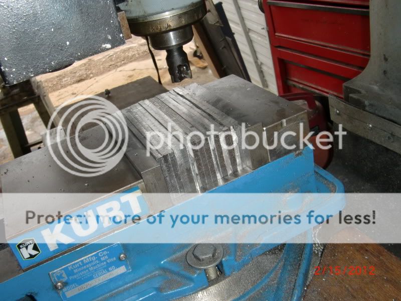

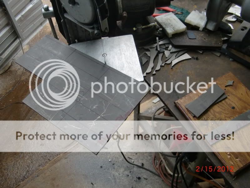

Getting some work done on the orders! A little teaser to wet your appetites!
15 or so Lbs of titanium!

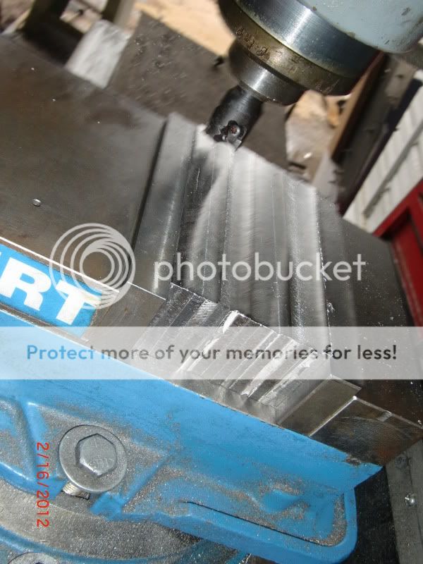

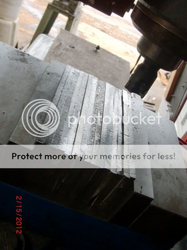

facing them all to the same size

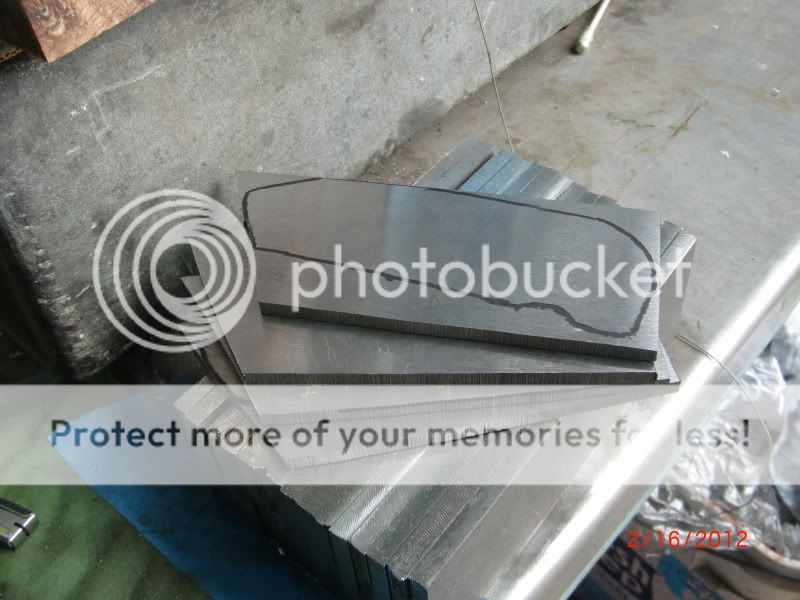

blanks and blade cut outs, 3v goodness!
