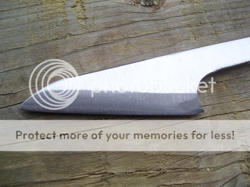

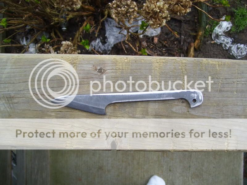

Well... It's time for the next installment of the SRM (Skunk/Rescue Mike) Faux-Poon..
Overall, I have removed quite a bit of material thinning the blade down, and have the handle pretty well shaped.
The Blade is finished with major grinding..
And I put a 25 degree edge on the cutting edge..
Tonight, it sits in a 400 degree oven (twice) and then off to paint and wrap! I'm using a Yellow Enamel, and Black paracord..
Whew! Lots of work! More pics in the morning!
