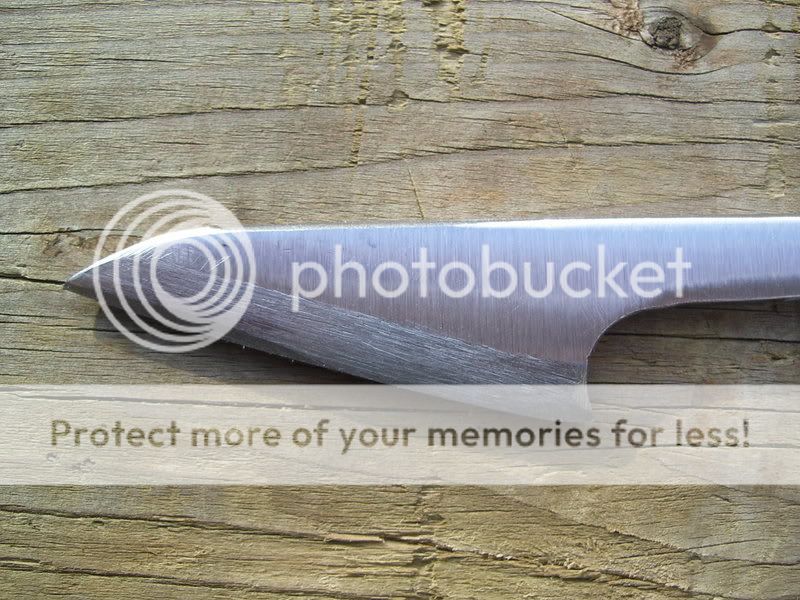

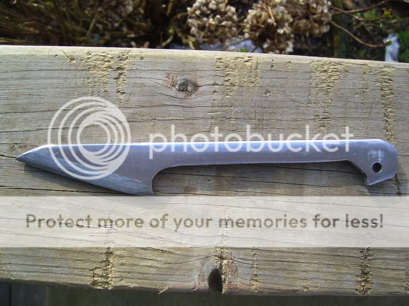

So after a day or so of grinding on my Fake-poon.. This is what I have got so far..
Spent quite a bit of time on the blade, thinning it out, and starting to shape it into a "blade" that can be used as a utility blade.
I have also ground down the back end of the blade, forming kind of a choil.. This should provide a nice finger rest, and allow you to use the blade as a utility blade , as well as a hooked edge to prevent it from coming out when used as a harpoon.
This may take a while, but I am actually trying to take my time and be patient!
I also got the enamel I am using as a finish.. Bright Yellow!!
I like the 'choil' ricasso area junction thing. It looks like a gaucho knife almost IMO. I love Gauchos.
Looking Good! :thumbup:
You have been doing some grinding! :eek:
Also look at the orginial Harpoon, they have some file work on the spine.
i think that is intended to help hold the catch, and provide for a place for the thumb when using as a knife.
They way I make these, is like this:
-With ruler, mark their desired location.
-Take a small cold chisel & hammer and "dink" the spine where the marks are.
-Take a triangular shaped file and file across the spine a bit, the 'dinks' keep the file from wanting to travel laterally. check that each of them are same size/depth.
I like to take a small round file (Like a chainsaw file) and round the tops of the grooves a little. In the case of Fakepoon, I'd leave them triangular for better "grip", in case you were to stab a nice Salmon. ;)
Way to go Mike, looking good! :thumbup:
Hey Mike, you might want to use some "etching" primer when painting it. Can be found at automotive stores. Can give that extra adhesion to the steel.
ALso, in that case, use 220 grit wet dry paper, and sand in 2 directions, or in swirls, that also makes better adhesion for the base coat.

Am I the only one who thinks the tang should have a couple holes in it for lashing to a stick?
Usually when I hear "poon" a knife isn't what comes to mind. :D
I was thinking about that.. I'm going to draw it out and see what it looks like.. But there definately needs to be something..
