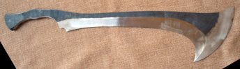

Here's my favorite zombie killer, and once I contact the maker and if I get his permission to copy his design for my personal use, my next project, and it looks like a great forging funtime.
Just a very cool blade.

Holy Crap!! Those Zombie Killers are awesome! Pure Business!! No Glam! Get the F**K out of the way! The book 'World War Z' talks about the practical tool the Marines invented to efficiently be-head zombies... something that was part shovel head, part spike... i can't remember exactly. Great book though.... the oral history of the zombie apocalypse!

Blade is remniscent of a Nepali kora/kuhda used to behead sacraficial goats and water buffalos.
