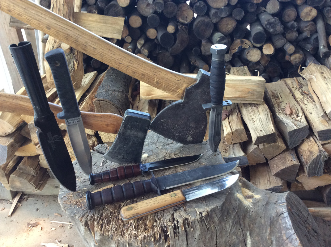

Andy Pomorski and I are beginning discussions about a spear collaboration. I'm looking to have him forge out some blanks for me, similar in concept to the Cold Steel Bushman series, in that they will have a hollow sleeve-like handle that can be used as a knife, or attached to a pole with a screw for use as a spear. If this project gets underway, we'll use thicker stock than the Bushman series so the points will be "stab a car door" durable. Most likely the alloy will be 15N20 at 61 HRC with lean grinds at the edges, increasing in the last couple inches to more robust point grind. Blade shape and size are not yet determined, and I'm considering keeping that open to custom requests. These will not be available in stainless.

DocJD DocJD what's the inside diameter at the base opening where the handle would go in?
Thank you
My best guesstimation is about 1" tapering down to .75" .
This is the shaft I have mounted : https://www.amazon.com/gp/product/B005KDD0XQ/ref=ppx_yo_dt_b_search_asin_title?ie=UTF8&psc=1
Nominal 1.25" diameter but measures ~1.1" at the opening . It tapers . Fit pretty easy , IIRC .
It's stuck in there , very stubbornly , after throwing into wood targets .
Plus I have the whole thing wrapped in silicone tape . So can't really measure the ID directly .
