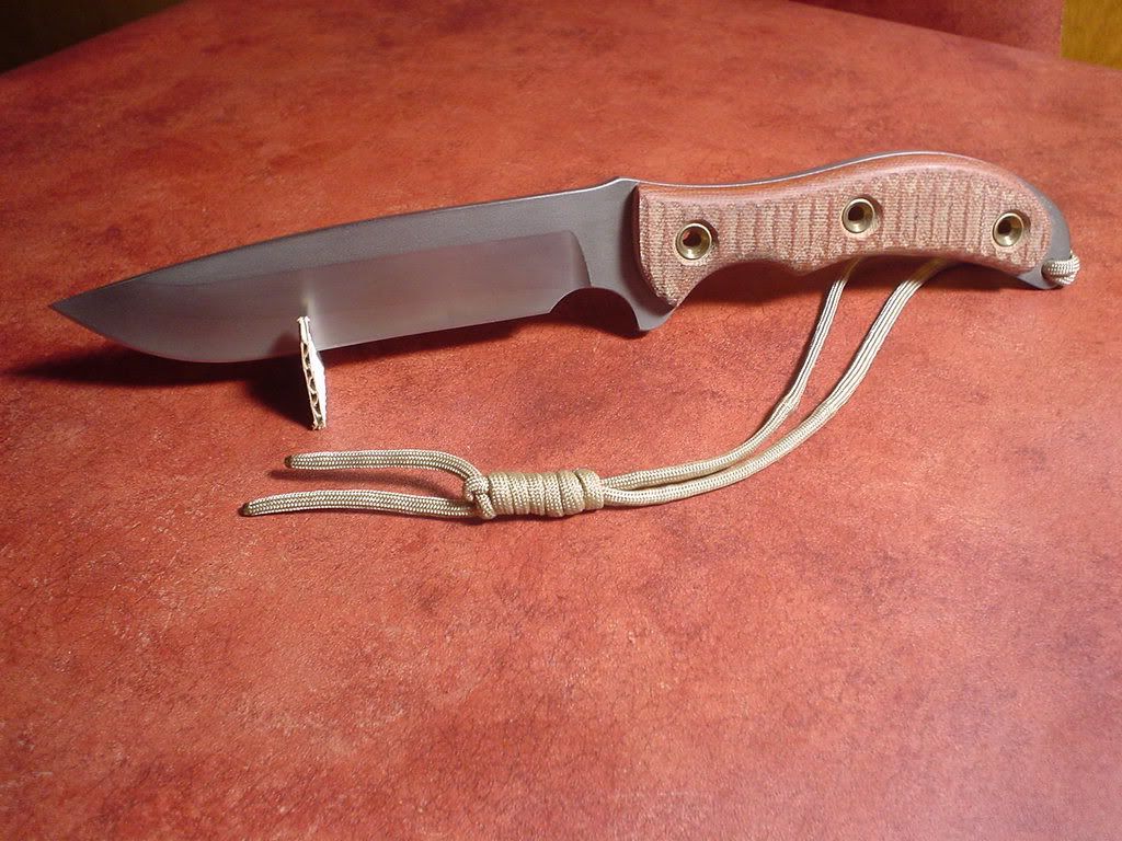

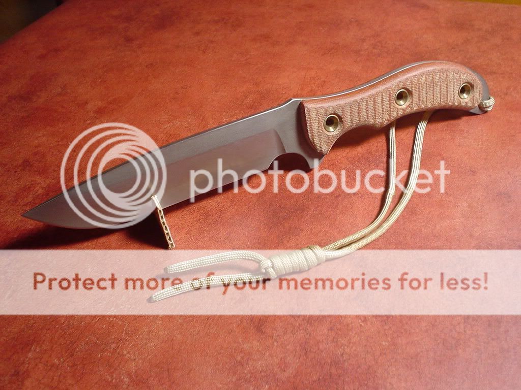

That blade is looking very nice.
Personally, I would put a few more minutes into cleaning up the ricasso if you will see it. (... yeah, I know - probably another 30 - 60 minutes....)
I wouldn't worry about the areas under the slab.
I have stripped a Bunch of my Busse and kin blades (all that I choose to keep!), but I have yet to have removed the scales. I showed you my SJTAC probably a couple of years ago when I got this:
Wouldn't you know.... out of all of the Busse kin knives I have stripped, this was the only one without Pecker-Treks!
The pits are actually pretty unique on the Desert Jack. They have a pretty interesting and decent looking orange-peel look that is very uniform. So, this is also the only Busse and kin knife that I didn't sand down the pits on the flats.
I hate the pecker treks and the streaky stretched looking marks.
The SJTAC is actually still not finished...
I have done more to it and it is pretyt close. But, I want to remove the scales to finish it properly and have been holding off because of the scales. I might add same micarta spacers to make the handle thicker while I am at it (???).
Talk about MAJOR pecker Treks! The Convex shape of the SJTAC actually has CNC cutter blade treks all over both sides of the entire primary grind. Apparently, the SJTAC was machine "Cut" by CNC for the convex shape instead of flat grind like most Busse and kin blades.
You can see these types of machine marks on the AK-47's blade as well.
But, there are a lot of pits around the ricasso that I can't get to and I want to take the scales off and do it right. I have been trying to find out more myself about how to do it right. But, there isn't much info.
