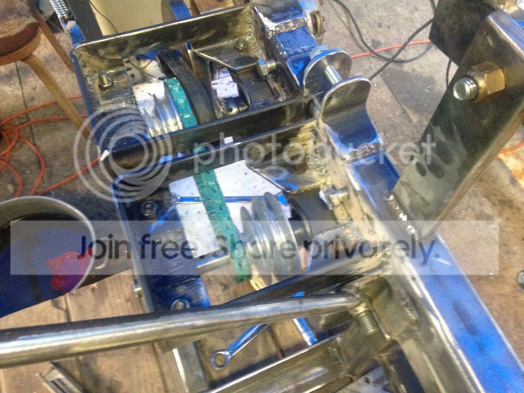

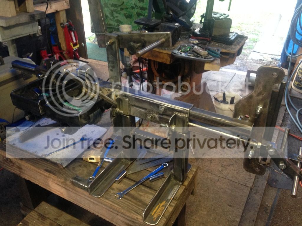

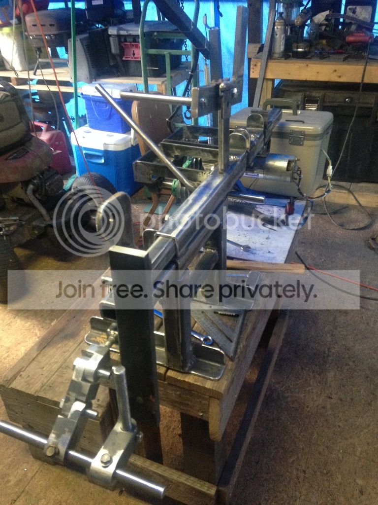

I'm not gonna lie, the first tool rest I built sucked and I hated it. This is a bit better. 2 days of work with the tools I have. A bandsaw, drill press grinder.

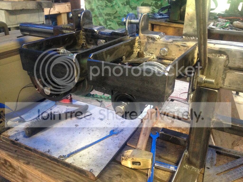

Made a change to the shaft mounts. There was a lot of lateral leverage from both of the belts and the bearings were heating up and want them to last a good while. The additional weight actually makes it a little easier rotating to the horizontal position. I do need to either extent the back leg extensions or secure it down in the front with a fastener to the table. If I pull the platen and tool rest of it tips up as it's very back heavy without them. No biggie.. Probable extend the legs so in case of ever needing it moved or whatever I don't have to worry about it being fastened down to whatever it's sitting on.

The hinge came from the door to and old industrial Biro meat bandsaw. I have a second one if it doesn't, however the hinge pin is a min of 1/4" thick and I have tac welded the barrels of the hinge closed. Most of the tension being exerted on it will be in the downward vertical direction. It is fastened with two 1/4" by 20 bolts. It's actually a lot heaver duty than the image does justice for It's made of 3/16" metal. The door that is was originally mounted to was quite a heavy chunk of cast aluminum. The base from it I'm using to mount my drill press, 30" belt grinder and 8" wheel grinder to. It's probably close to 200 plus pounds. You can see it in this image.
In the event that the hinge is a complete failure I will salvage the tracking hing from the met saw. It still currently still has the 14" cast iron wheel attached to it but the bolts are frozen and I have't taken the time to use the impact driver or drill them out to remove it from the upper part of the old saw.
