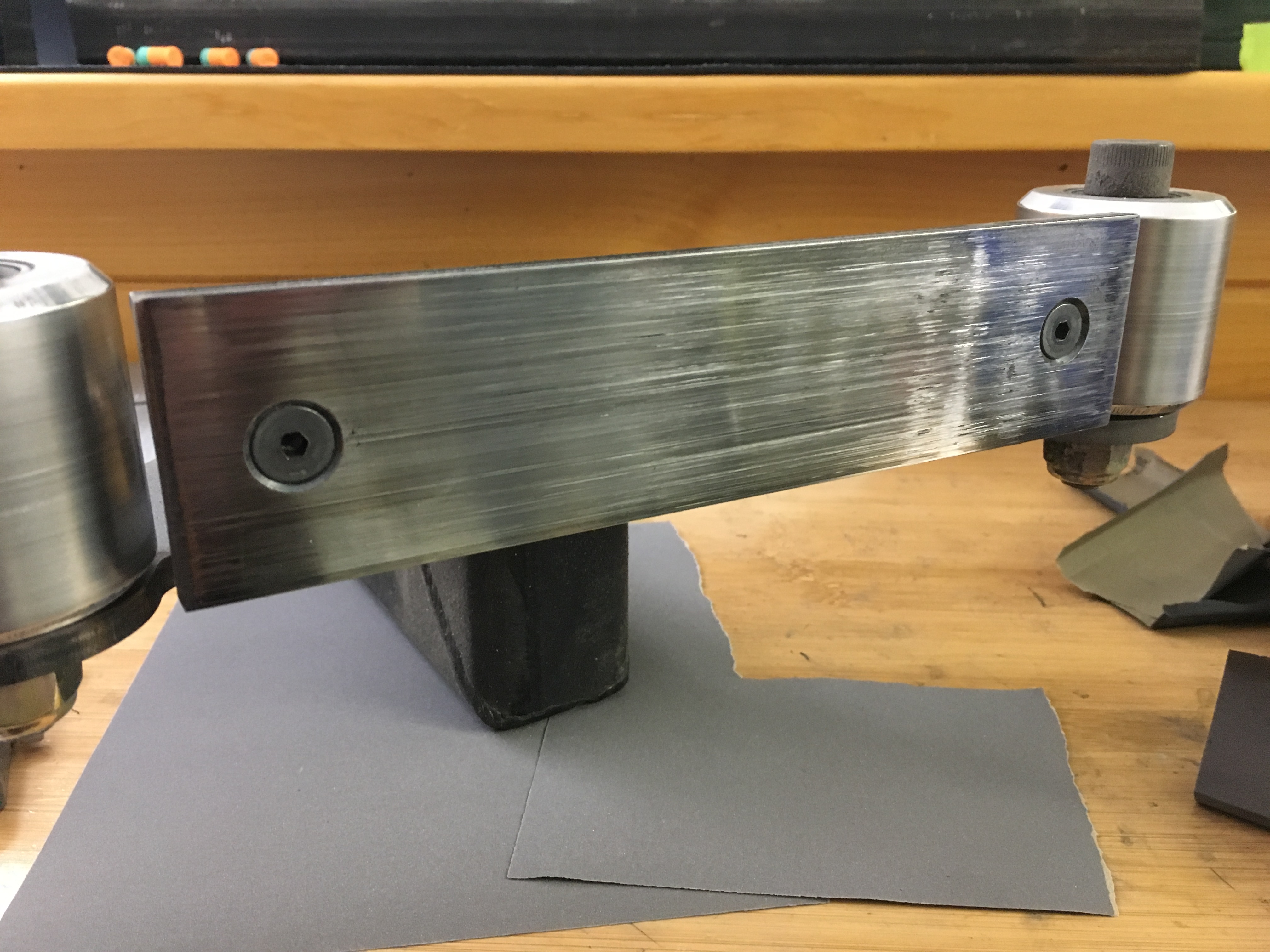

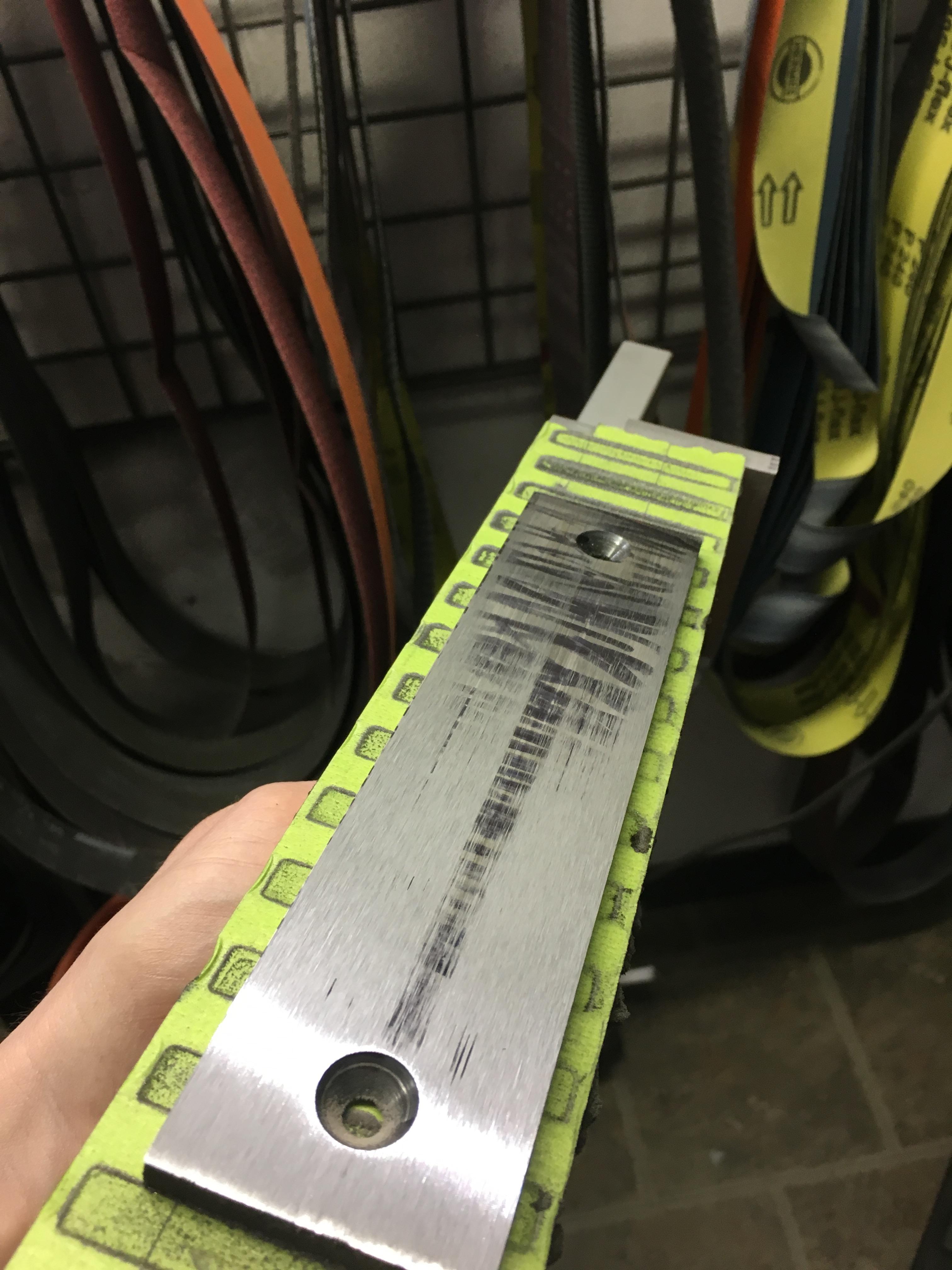

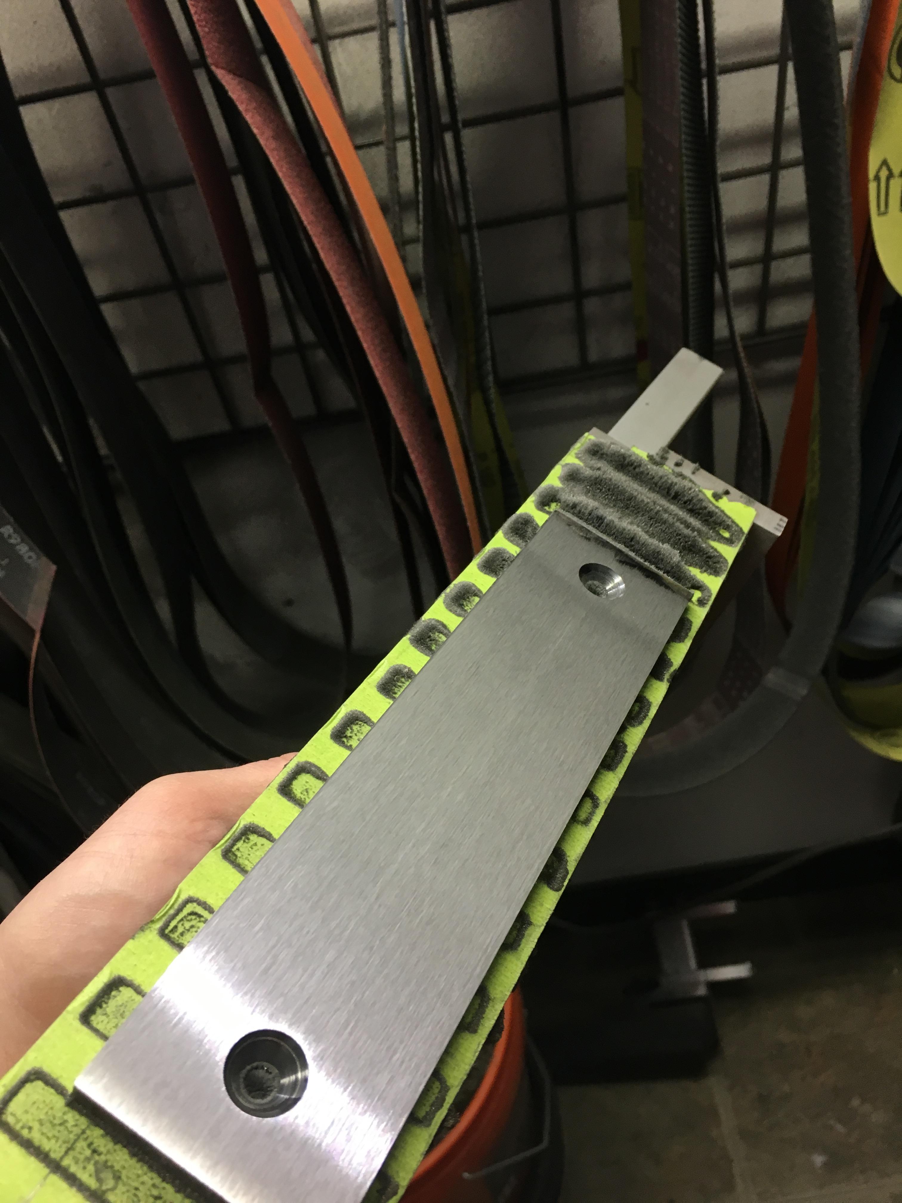

What does everyone do to mitigate belt bump? Some of the 3 inch belts (180-240g) from Phoenix leave a wavy finish. Enough time with a Norax will take care of it but that's a pain.
i have noticed the cheaper the belts, the bigger the bump :rolleyes: they have some type of tape across the back of the seam. i have heard those green gator belts make no bump at all. can anyone confirm that ?
I can confirm that! I have 3 different grits in gators and their all perfect. Best belts I’ve ever bought for the task I use them for. Also have cubitron II and Blaze belts, neither of those bump at 60 for the cubitron or up to 220 for blaze. I still seem to not get as clean a finish as handsanding at 400 grit. The surface grinder finish still seems to not have a straight scratch mark from end to end rather than a bunch of start/stops all the way
Some of the tactical knife makers surface the flats and leave that start and stop look. Depending on the knife, I don't mind it at all.
On my next batch of knives, I am going to try the cheap AO belts, and sand down the grit over the splice.
The next time I surface something I’m going to try and turn down the speed to near 0 and see if a fast pass helps.. maybe even on the last stroke or so shut the grinder off and make a few passes holding the contact wheel from turning.
