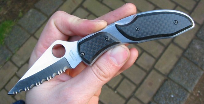

Well, just something I did to a delica II.
I got it in used condition, so I polished out the small scratches. Next, I took some Carbon Fibre and make some scales.
Just drill some holes, tap for thread, and off you go....
indeed! i would love to hear what particular technique u used to fabricate the carbon scales. Do u buy a slab of Carbonfiber and saw away? How about that polishing?
Great professional work!
Yup, buy a piece of Carbon Fibre and saw away...
Finish the slabs with a Dremel tool.
I used sandpaper to polish the scratches out. Didn't take very long.

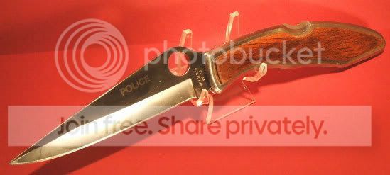

Here's mine, modified by STR:
I customised the TI clips on both of my salts
Pacific salt clip done - Atlantic salt clip still stock
both clips done and fitted, the colours dont look all that great in this shot

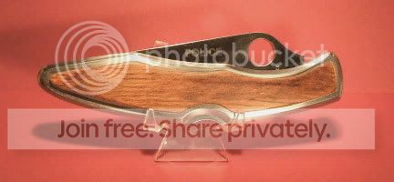

nice.. what kind of wood is that?
how does it stay on.. epoxy?
Wood is cocobolo - yes, it was epoxied on with Devcon/30 min/2 ton. Bit of a pilot project, in one sense. Currently, it's been sanded to about 600 grit and then I used a polishing stick with green rouge for the final finish. I like the Police, but it was too slippery for my dry hands so I was trying to figure out a way to make it a little grippier and not wreck the SS part if something didn't work out:) I still might thin it down more, but we'll see if the epoxy holds thru some EDC things for a couple of weeks and see if the wood dings up or not. Once I get where I want it, I'll probably finish with tung oil and re-polish to a satin finish.
Hope this helps - gord
