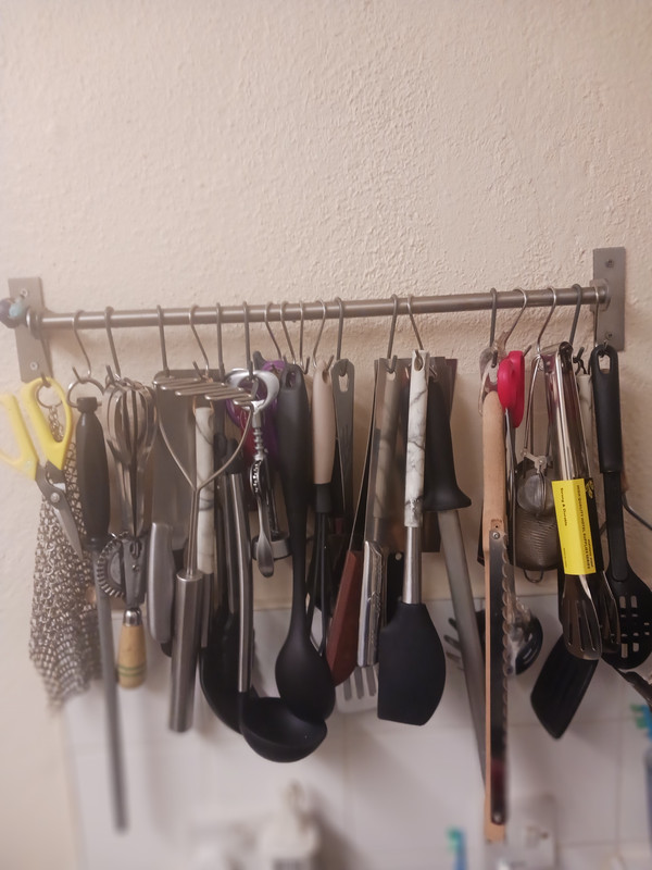

I have two steels for my visiting cooky neighbours and chefy mates - one tri-cut carbon and one diamond but I never use them - they`re just hanging on the wall rack - for spiders to work out on.
Somewhere on there is 5 cleavers, a bow bread knife and 4 pairs of scissors.
