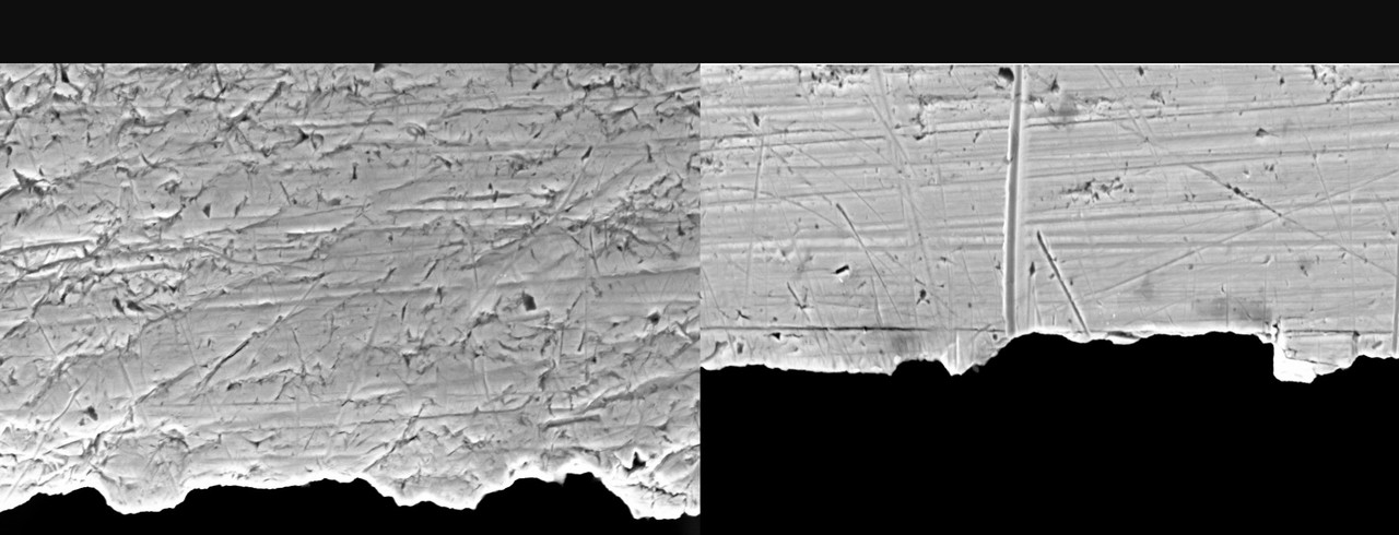

We can argue about the antecedent all the way down to atoms I suppose, but the conclusion "or they wouldn't cut" is simply not true. Fundamentally a sharp edge acts to concentrate force into a tiny area of pressure sufficient to overcome the strength of the material being cut. No serrations or other irregularity are necessary for this, though irregularity can further increase point pressure and introduces the mechanism of mechanical keying.
This is just my anecdotal experience but I have seen an edge with a USB 120x microscope and when the tiny serrations wear down - it`s like using a butter knife.
Like this for example -
Razor blade magnified
Here is a straight razor edge done with a Shapton 15000 at 3000X magnification with the burr removed.

As I often do I'll refer to the work of Todd Simpson on his scienceofsharp blog. I think in the case of shaving, tooth is counterproductive.
Here is an SEM image of the edge of Feather razor blade.
"Side view SEM image at 5kX magnification following the stropping progression."
It`s not totally flat but I stand corrected Mr. Wizard and Cementite.

I don`t dispute those photos but at the time they were $55 an hour to set up a long time ago and I don`t believe they`re typical - just my opinion.
They are still not perfectly flat are they and no doubt further magnification will reveal even more irregularities.
This is not just my findings and a cursory glance at science of sharp did not persuade me or alter my initial conclusions before I had access to the relevant scanning electron microsopy results.
Is it perfectly flat ? - No. Why ? What is the relevance ?
Nearly straight with microscopic shoulders is not perfectly flat is it? and that`s just at 50000x - lets move the goalposts and go to half a million magnification - I think that`ll be slightly revealing but too expensive to show - especially nowadays.
In a word - microscopic saw - I rest my case.
Believe what you want to believe but the point is it isn't the presence of serrations (no matter how small) that creates a keen edge. As Mr. Wizard said it is a matter pressure vs surface tension simplistically speaking. I would recommend reading all of the articles and studying the SEM pics on scienceofsharp to gain a better understanding, but plainly speaking it is about the apex width not the level of unevenness. Unevenness can create conditions where an edge can perform better and last longer but the cutting ability of an edge doesn't rely on that unevenness.
Flat means no irregularities whatsoever at any magnification.

OK, but the "tiny serrations" are not what enables a cutting edge. The width of the apex does.

Again I would recommend having a good read and look at the images at scienceofsharp.com.
The image from that site that Mr.Wizard provided shows that the width of the apex is a lot smaller than 1 micron. A 1 micron apex would be what most would consider dull.
