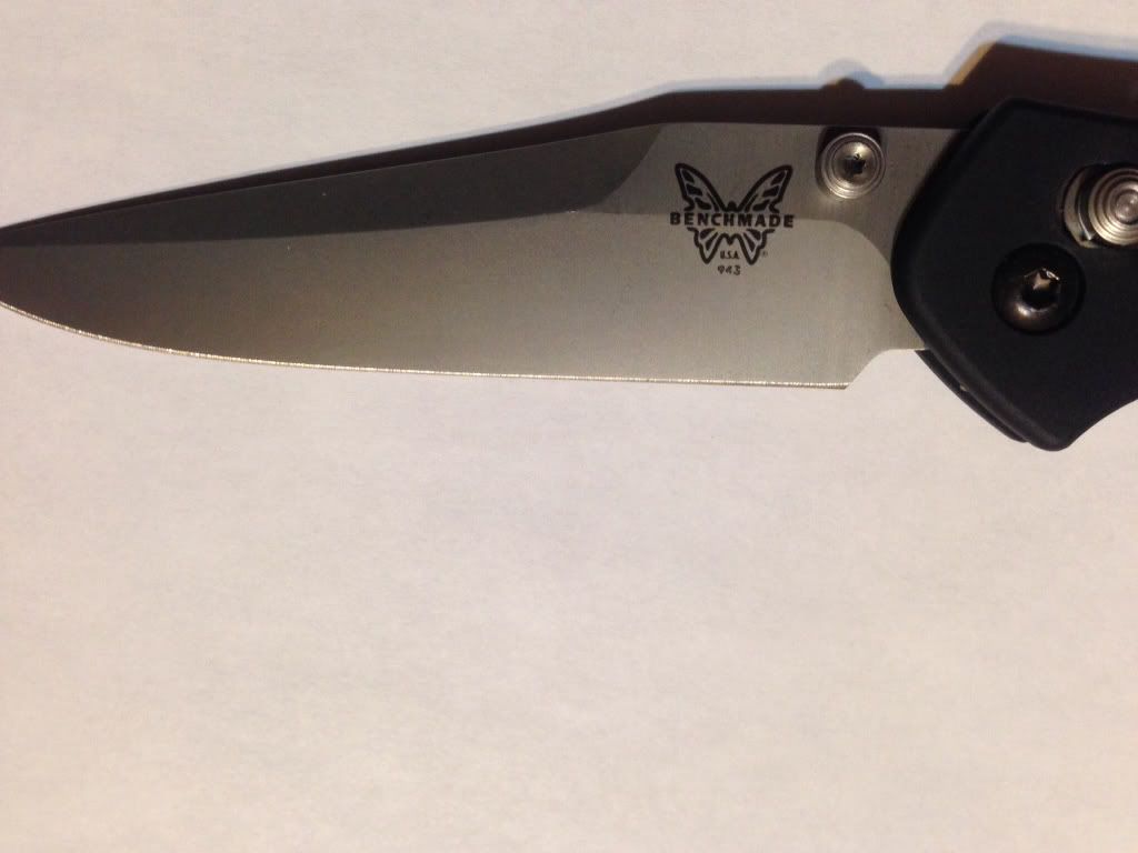

Before benchmade decided to be part of Blade Forum I had posted that benchmade did not wanted to be part of this forum because they did not want to hear how bad there QC . I hope that they are not hearing this but listening and paying attention MAP price for the 943 $170 check the grind on mine . Looks like a chisel grind angle .

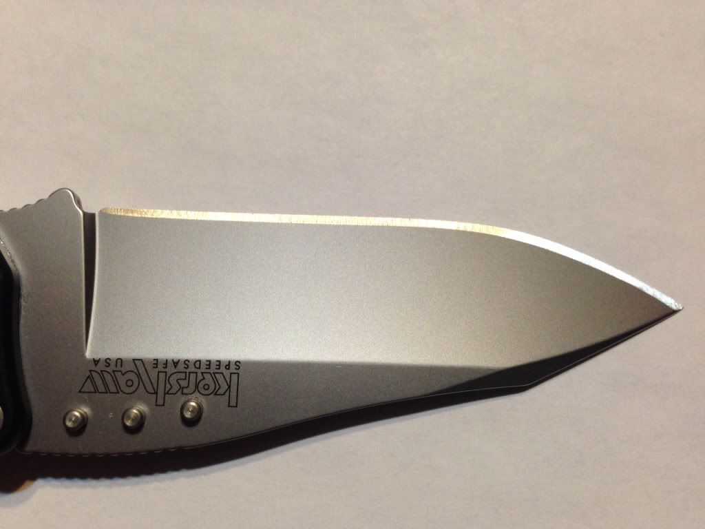

Now it looks like benchmade hire there grinder out of high school and when they get the experience they go right around the coner and work for kershaw . This is how it's done benchmade learn .
Yes I'm talking about the edge of the knife . There is no angle to it it's sharp but the ground is horrible . Can I fix it how can I the knife doesn't have an edge angle . It's like putting an edge on a butter knife .
It could be me but I like to see a nice edge like the one on the kershaw . Also excuse my lack of knolege when it comes to grind , edge , angles I'm learning as I go . Thanks
A) Benchmade does not use a machine to put the bevels on. They use people. Every Benchmade knife is hand sharpened at the factory, so there will be inconsistencies between knives. It's just the nature of how it's done. The problem is that they aren't investing in jigs to help those sharpeners hold a consistent angle. They need to either do more training/get jigs for the folks, or they need to invest in some sharpening machines that will put consistent bevels on and have the sharpening folks run those machines (so no one is out of a job).
B) They have publicly stated in the past that they put about a 25º bevel on each side, so it will be more obtuse at the start and wont' look like the bevel on the Kershaw.
