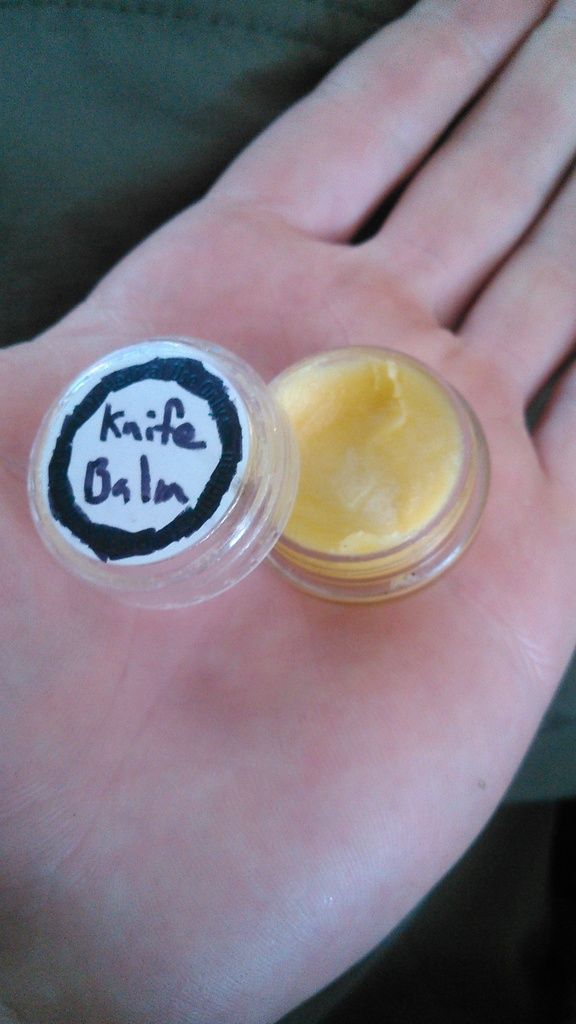

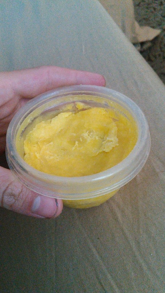

Ndog, I'm not sure the exact ratio, but I like to make it pretty firm; close to 1:1 or 2:1 mineral oil if I had to guess. I usually just eyeball it and then mix "to taste" if you will. My goal is to make something that stays on for as long as possible, while also providing hydration, rather than something that provides lots of moisture but has to be reapplied often. For my EDC or hard use blades, I still only put knife balm on every week or 2, and it goes on the whole knife, blade and handle. Actually, I was originally calling it blade balm, but decided that was a misnomer since I was using it for the whole knife.
I talked about it in an older thread, including some of my process. I'll put up a pic and link to that.
Ok here it is, posts 25 and 39 have some relevant info on what it is and how I make it, respectively. Not much, but it's something. I can post more about it if you're curious, it works great for me.

No problem man. I had to channel some Steve to find it, but I did. The solid vs liquid was something I took into heavy consideration, but just to clarify, I still do a BLO bath or at the least wipe the handle down with mineral oil a few times before the knife balm goes on for the first time. Goal is to add moisture, then lock it in.
It also goes into little containers easily, for them camping trips you were talkin bout, as well as giving to friends/family. It makes great lip balm as well!
