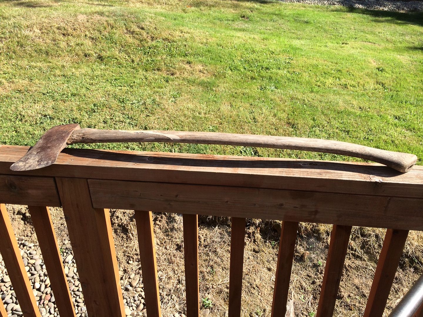

This handle has been in my work area for a couple of years. Every time I have used BLO or BLO/stain, I have wiped my hands or gloves free of excess on this handle.
Would be fun to try to straighten it and it's not going to happen with anything I've tried so far.
Yes JB I go a little past straight as they will spring back a little.
That one actually would not be to much of a challenge as its a nice slow bend, but will take a couple of heats as its over a wide area. I would just use a larger pot of water to maybe get it in two heats. My best guess would be that you may not need any additional blocks and just a flat surface. I would just sight down it to decide where to put the clamps and how much you will need to move it.
I reserve the right to be wrong and how much further you need to go past straight is a guess that you will get better at with practice.

I do it like this. I always clamp the haft very slightly past straight. I've pushed them too far before and had to undo some of what I had done.
I also recommend finishing your haft with your BLO, tung or whatever before straightening. It's the heat you want to do the work. You don't actually want the water to enter the wood.

I'd never hold someone in account for giving helpful advice here. I did notice the heat gun there in your picture. Did you clamp it and then heat it while it was clamped or start your clamping and then heat it until it gives a little then tighten the clamps?
Thank you Square_peg. Between these two posts I have something to experiment with. Seems like you would have to do it several times and gain some experience before a guy can just heat it up and clamp it and expect it to "bend to your will". I bet every handle responds differently to a point. Gives me something to try out. I have some pretty neat old handles that need a new life.
