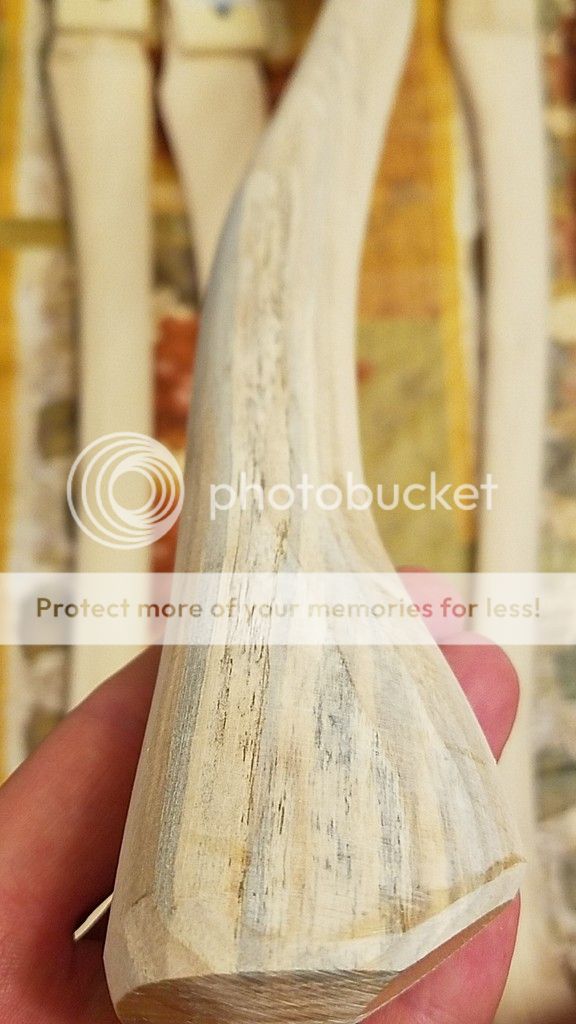

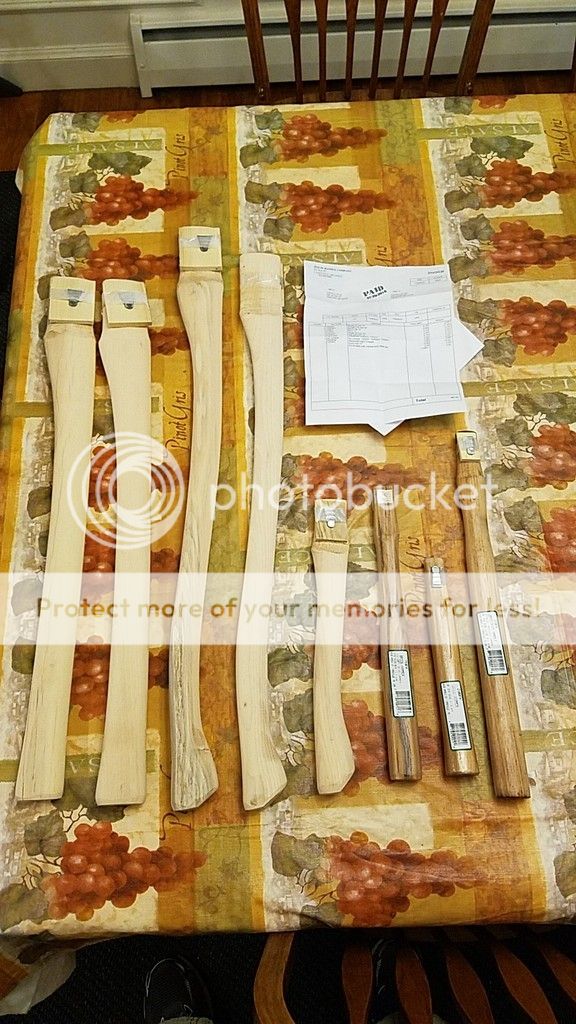

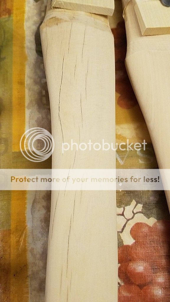

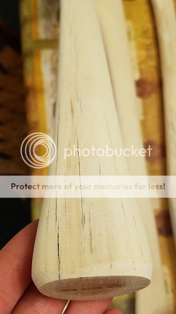

So this is my latest, and likely last order from House Handle. After my last order and seeing what crap their FH axe handles are (I still think the FH hammer handles are very good), I tried one last time and ordered AA handles with no lacquer and paid extra for hand selection on the 32" handle. This represents $60 shipped for 7 handles (the hatchet handle was a free replacement). Knowing about my last order and already having to replace things, it blows my mind what happened here. The hammer handles are good as usual, as is the replacement hatchet handle. The 30" curved axe handle is good, as is one of the (STUPID THICK) 28" straight handles. BUT, one of the 28" AA straight handles is loaded with cracks from top to bottom. This was ordered with no lacquer, which means that someone actively had this in hand, worked it, saw all these cracks and still put it in the box. Worst, the 32" AA handle, which I also paid the hand selection fee for, has fungus spalting. Based on these two major flaws on handles that required extra scrutiny, combined with the fact that they know how bad my last order was, I can draw no other conclusion that they literally don't care and will put zero effort into any kind of quality control. I've already given them more chances than is reasonable. I may still order hammer handles as those have been consistently good and well priced, but for the big stuff I'm probably done. I feel like Charlie Brown trying to kick the football with these guys.
