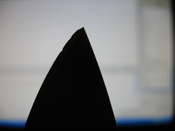

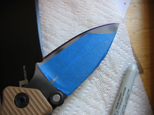

Here's something I posted over at the JD as I currently have a modified AR on passaround there and thought it might fit here too. The AR was dropped directly on the tip and had some damage and some dings too. Ask the guys there who had it how well it cuts, it's a monster.:thumbup:
Doh. There was some edge damage that Mark (10x) contacted me about so I've got the AR today. I figured I'd take a whack at fixing it before I sent it to the Striderguys for just a little damage. It was dropped on it's tip which blunted it oddly and had some weird deformations a little further back on the blade.

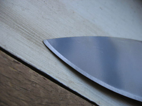

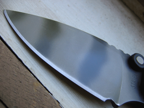

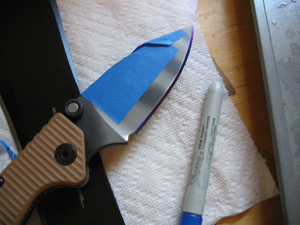

Tape up the AR blade nice and pretty so I don't scratch it up on the Edgepro platform. Blue markered it at this point too so I could match my angle and do the whole edge. The AR is a great knife to sharpen on an Edgepro because of the fairly short, fairly straight edge.

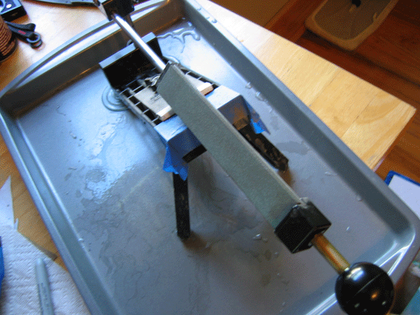

Edgepro all slopped up and ready from the Outcast I had just reprofiled.

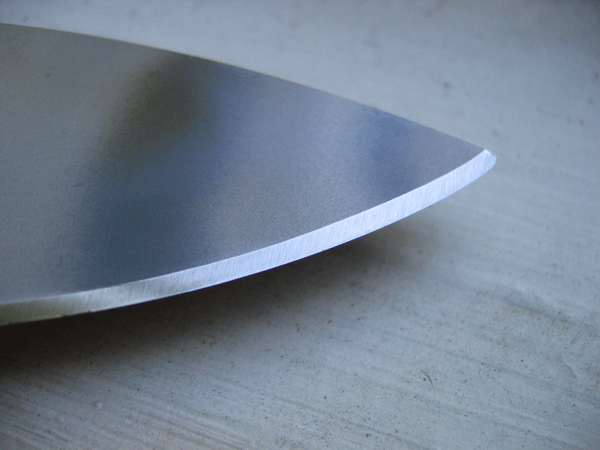

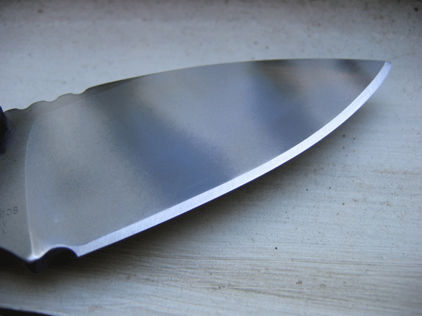

Finished product. It's somewhere below 30 degrees total (Had the Edgepro on the 15 degree mark but laid the AR down on it's flat so the angle is a bit steeper than the 15.) done on the Edgepro with just the 120 grit water-stone and then micro-beveled with the ultra fine ceramic stone on the Sharpmaker at the 30 degree setting. Zips through cardboard and stuff lickety split again. You can still tell the tip was a touch funky if you look real close but I didn't want to take any more metal off than I had too. It's sharp all the way up though.
So... I'll get it back in the mail Monday. Thanks to Mark for letting me know immediately when the damage occurred.
