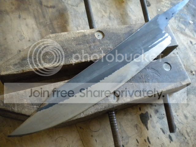

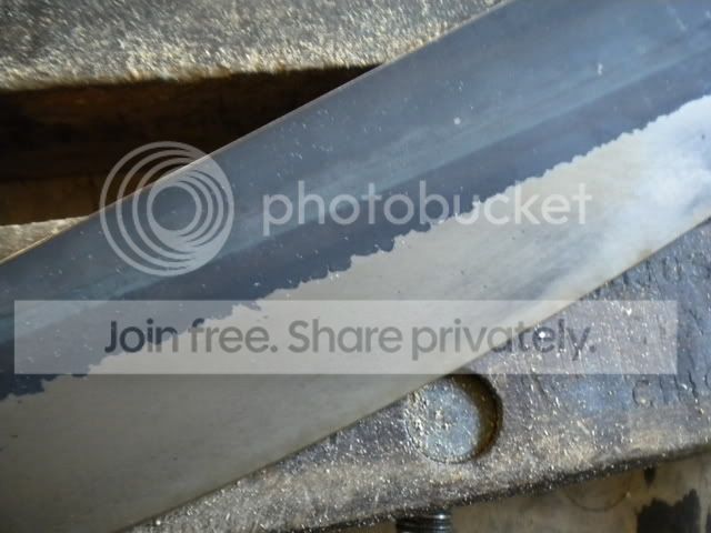

Here's one that came out of the quench real pretty,... 1095 in canola. I was shooting for a relaxed subtle "rainbow" above the primary quench line and to get the primary quench line to fall just under the grind line. I took the pics to see how closely the quench line follows the detail where the "black oxide" (not hard fire scale, just a thick heat patina) popped off.
Judging by the way it popped the oxide film off, and a quick hardness test,... it quenched the pee out of it! :)
