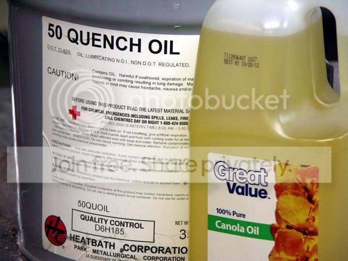

How close to "full" hardness from quench w/ canola and 1084?

Canola oil and a proper HT will get 100% from 1084.
I am reasonably certain that's true. 1084 is not a "super steel" (cheese and rice, I hate that term, but there it is again) and is probably the very best choice for makers who don't care to invest much time or study into HT.

If canola oil will give full hardness of 1084, rest assured you are reaching full hardness with it in O1, assuming you are following the recommended heating temperatures and brief soak prior to quenching. You can get your target hardness just by choosing the proper quench medium and skipping the tempering step, though very few would recommend it.

1084 and canola are a good combination...... CPM steels and a complex HT with quench plates is a different animal....and W2 and parks 50 is another option. Each has its merit....and its limitations.
Posting that canola is crap is just as wrong as posting that only a commercial quenchant will work. They both have their use.
