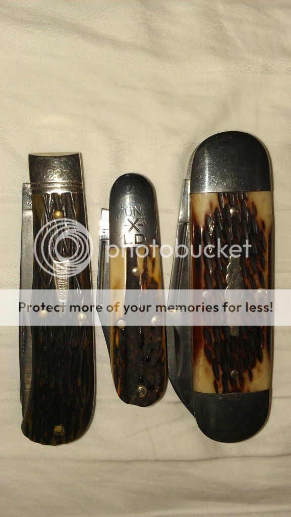

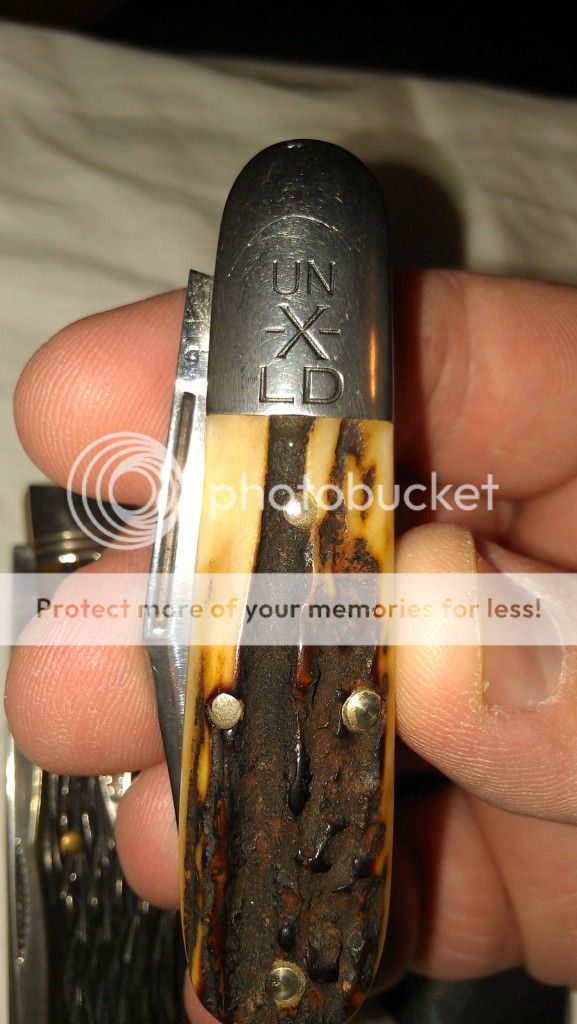

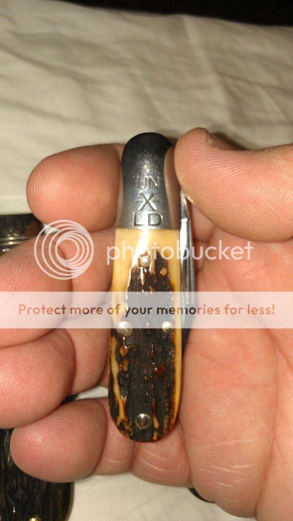

I have two. The burnt stag barlow with long pull, and the Sunfish with brown bone.
Love them. I don't polish or protect the bolsters, and they are getting a nice grey color to them.
I can't really capture it in the pictures, but it is there.
Hard to capture with just my cell phone.
I can tell you one thing, if you drop them into a pocket with a D2 folder, the tang on the D2 folder will give them some wicked scratches! (I don't do it on purpose, but occasionally it happens).
I need to take some of them outside in the sun some time.
They feel really solid. Honestly, they feel more solid than the other GEC I have with the brass liners.
