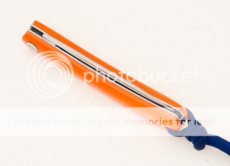

Trial run:
-O1 Tool Steel
-57-59 Hardness
-Orange Delrin
-***Updated 125 low carbon cold rolled steel liners
-***Updated "Pivot is 125 low carbon steel with bite washer pressed on pin design"
-3.75" Closed Length
~1/2" handle thickness measured with ruler
~6 13/16" Overall length measured with ruler
~Measured Spine thickness 0.094"
~Measured thickness just above the edge bevel 0.014"
