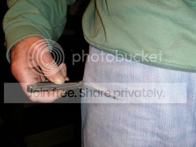

Been closing my Schrade stockman slipjoint on my leg since mid 1960's. Haven't 'stuck' or 'cut' my leg or my fingers yet. :D
I pinch the blade with my thumb on one side and my index and middle finger on the other. Of course I don't use slip joints any more so I usually close one handed using my leg like BSA's use their palm.:o
I've closed slipjoints as saxon mentioned, by pressing the spine against my leg or hip. If I use the knife enough I should know the spring tension and what to expect.
Ya know, I do the same basic thing. I often close against my belt as well with a slippy. If I am comfortable doing so with a particular knife (ie. I know where my fingers are by feel), I have been known to close slippies by pushing the blade closed with my index finger while grasping the knife with my thumb and middle finger and bridging my palm over the spine.
