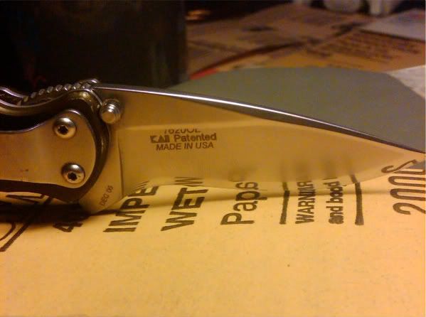

The buffer probably worked because the angle at the very edge is more obtuse than you think. The soft surface of the buffer easily conformed to the pre-set bevel and made contact with the higher angle at the apex of the edge. This caused a convex shape to be applied and if you try and switch back to stones you will need to re-set the bevel to a V grind. What you were probably doing is trying to sharpen at one angle but after not getting a sharp edge decided to reduce the angle thinking it would make it sharp. Without grinding the bevel completely to the apex its my guess your edge looked more like one that was overly rounded or un-intentionally microbeveled. You can grind all day on a bevel like that and never make it sharp.
Making it look pretty is not always the goal but its been my experience that the better it looks the better it is. Weather it be at 600 grit or 60k grit the better you use that stone or tool the better your edge will be and look.
With hand sharpening often its said to hold a consistent angle, though this is important its not really telling the whole story. As your edge makes contact to the stone it will always be at a slightly different point and never makes complete contact between shoulder and apex. To even out the scratch pattern many strokes must be made to blend the bevel together. If you look at the bevel after your med or fine stones you will see many horizontal lines on the bevel, these are all the single points of contact from the stone made on each pass. If the lines do not evenly flow from shoulder to edge apex its likely your edge will have a number of issues with the main one being a dull edge.
Its not controlling one angle but blending many. Feel and sound also play a big part in letting you know when the apex has been reached. If the med/brown stones are as coarse as you have I'd suggest getting a coarse diamond hone or some 220 and 600 grit sandpaper to wrap around your SM rods. If your edge is not sharp or at least close from initial grinding then progressing to finer grits will be of no help, usually it just makes it duller.
