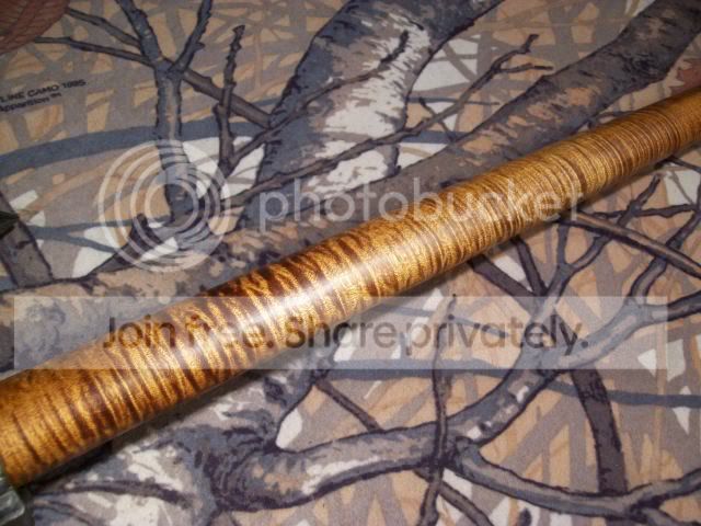

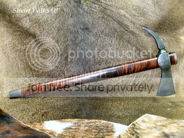

I like it the way Chuck Burrows of Wild Rose does his with the old fashioned vinegar and iron stain....it is super nice and historical too!:D:thumbup::thumbup::cool:
Actually I mostly use ferric nitrate (aka Aqua Fortis - iron dissolved in nitric acid - it's available pre-mixed), but vinegar and iron comes close to the same look - here's a couple examples only thing the stain is SO much better looking in person since it's tough to see the depth of the chatoyance......
The finish on these is an historical heat polymerized linseed oil based violin varnish - a common finish on guns, knives, etc. during the 1700's and 1800's.
In over 40 years I've yet to find a combination os stain and finish that works better on maple.
Deep curl and striping. It depends on the grade of maple what you'll get..Aqua fortis on these..This first one if amazing in real life. Pics dont do it justice..
