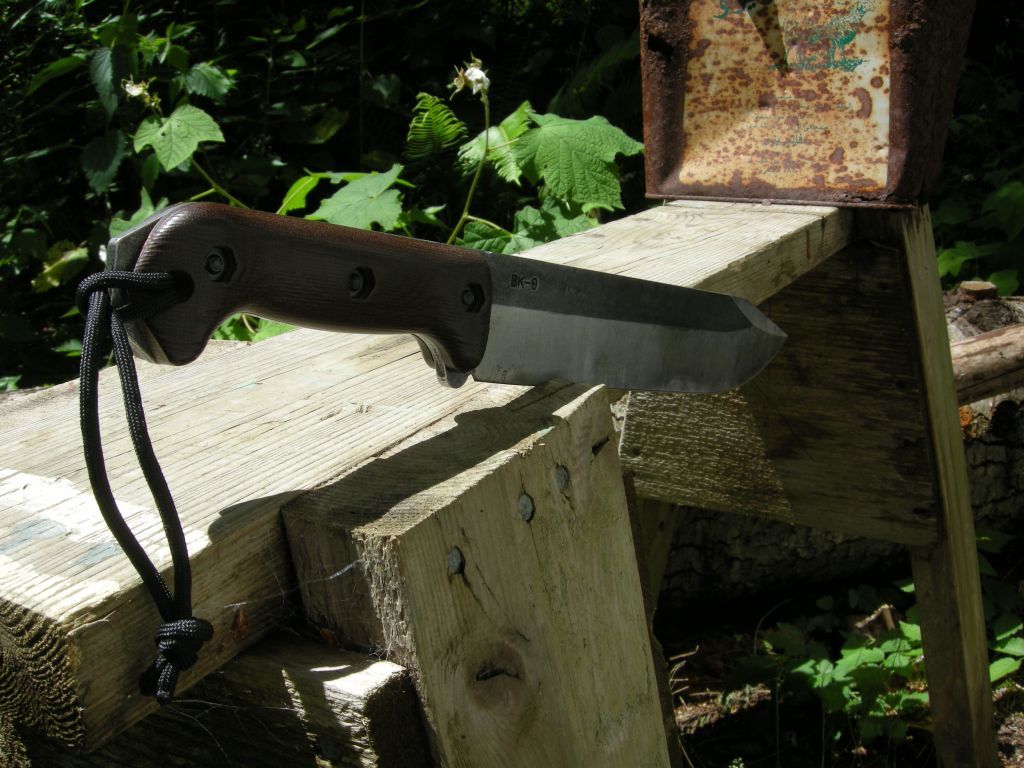

I've pretty much fallen in love with the BK9. I have two now, and have another on the way.
The first one, I stripped the coating, applied a mustard patina, and put micarta handles on it.
The second one, I stripped the coating, dipped it in acid to form a patina, scuffed up the handles, and recently polished up the blade.
Now for the third one, I'm not sure what I want to do with it. How hard is it to do file work on the spine? Any ideas on things to do to it would be appreciated. I've thought about leaving it "stock" but what's the fun in that? Also, post pictures of your modded BK9 if you'd like.
How much further do you guys think I'd have to take it to get the grinding marks out of the blade? I started with 400, then jumped to 1200, then 2000, followed by Flitz polish. I was doing this in my spare time at work by hand, so it was a somewhat rushed job.

I say start over, and go from 400 all the way back to 2k. It will get rid of the marks this time I think.
To get rid of the marks, you'd need to start over with a much coarser grit, the coarser you start, the sooner you finish... i'd try 60 If i could find it in something suitable to sand metal. sand until all the grind marks are gone, then go to the next higher grit in the opposite direction.

Wet/dry sandpaper while wet is the better bet for shiny metal. I would only go as low as 80, maybe even 120 though. Then work from there. Remember, you don't switch to the next grit until the only marks on the knife are from the grit you were using. And treat the sandpaper like it is free, otherwise you will be at it for a long, long time.

Haha I'm pretty sure they're mine. Is it one of these?
Only up to 120 grit so far. I probably wont take it past 600 or 800... but wanna get a good sheen on it... no need for mirror polish. The etchings really show up much better without the darker patina on it though.
You could go and get all artsy on this one. Nice thing about etching is you can still use it and not mess it up.
