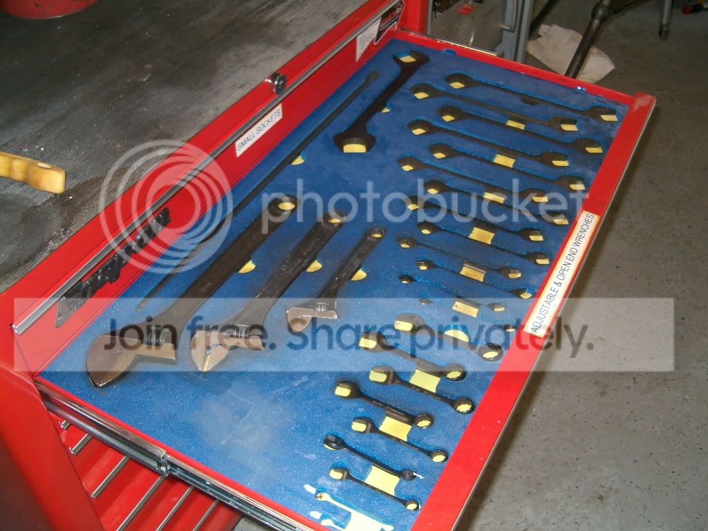

As a jet mechanic I have to account for all of my tools when I'm done with a job, so I use foam cutouts with a colored background.
