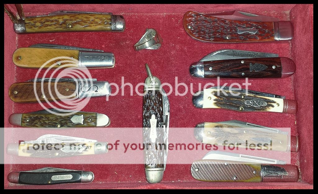

Nice display for your users tho. I like seeing pictures!
