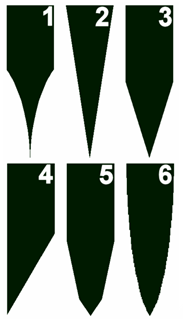

Hope this helps. . .
1. Hollow
2. Full flat
3. Sabre
4. Chisel
5. Flat
6. Convexed

It would help if it were correct. However I don't think this is right. As diagramed (and assuming scale and proportion may be exaggerated for clarity), number 3 would be what is generally refered to as "Scandi" and number 5 will be the sabre. I cannot imagine that "flat" and "full flat" are different...and regardless, there would seem to be nothing flat about number 5. I hope this helps!
A full flat grind will taper from the spine to the edge in an uninterrupted flat with a secondary grind to produce the final cutting edge.
A saber grind will begin it's flat taper approximately 1/3 to 1/2 of the blade height down to the edge and have a secondary grind to produce the final cutting edge.
A scandi grind has ONLY the grind to produce the cutting edge and no other grind to reduce the thickness of, or put taper into the blade. The varying height of true scandi grinds is most frequently due to the stock thickness used by manufacturers. Variance due to grind angle will be less noticeable unless there is a severe angle difference which will alter blade performance significantly.
Any micro-bevel at the edge of any of these grinds is usually to remove the wire created in sharpening or as a means of somewhat reinforcing a delicate edge structure.
I believe untamed is correct. The confusion may be because 5 and 6 are being compared to each other by calling 5 flat. In other words, 5 has a flat primary bevel with a secondary bevel, 6 is a smooth curve all the way down.
Seems to me most people don't even use the term sabre grind. They just say flat grind, which implies a secondary bevel. And unless it states full flat grind, you can assume it's partial.
If there is actually a difference between flat grind and sabre grind... well I need it explained to me like I'm 5 years old because I just don't get it. And if there is some mystical defining ratio for bevel heights and whatnot, no one seems to be able to produce anything.

1. Zero ground hollow scandi or Zero ground hollow sabre
2. Zero ground Full flat
3. Zero ground flat scandi or Zero ground flat scandi
4. Chisel
5. Flat scandi with secondary (edge) grind or flat sabre with secondary (edge) grind
6. Convexed
Well that just implies sabre and scandi are interchangeable terms. Any time I have heard sabre grind being used, the knife has a secondary bevel. I've never heard of zero grind sabre. That's just scandi.

The sabre/scandi difference remains a mystery to me. I believe the unground portion of a scandi is larger than that on a saber.
1. zero edge hollow grind
2. zero edge full flat
3. scandi
4. chisel
5. sabre
6. convexed
IMO 1 and 2 would be "hollow" and "full flat" if they both had secondary edge bevels. They don't in this diagram so you need to qualify them by saying "zero grind." A scandi by definition is a zero grind so that qualification isn't necessary.
And I personally see no difference between a scandi with a secondary edge bevel and a saber. They are the same thing only the angles and length of the bevels are slightly different. But that would also hold true comparing one sabre grind from one maker with a sabre grind from another maker. So IMO, a scandi with a secondary edge bevel IS a sabre grind. Only badly made because the intent of the primary grind is to provide a relief for the material you're cutting to pass around the blade. A scandi with a secondary edge bevel is a poorly made sabre because that relief from the primary grind is generally steeper and less efficient then a traditional sabre.
