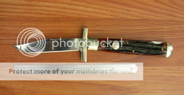

I think Queen Cutlery might be partly responsible for the notion that D2 takes a crappy edge and holds it forever. I bought a 2007 Queen Light Hunter that had never been used or sharpened. It had a lousy, obtuse edge. Just plain crap! I bought some DMT diamond hones and brought the edge angle way down with the coarse hone, then used finer hones and finished with my butcher's steel. It went from being unable to even begin to slice paper, to a paper slicing, hair shaving, toothy skinner! I can't wait to use it skinning a deer next season. Really a nice knife once you correct the edge. No rusting, and the Queen mirror finish is beautiful.
Joe
