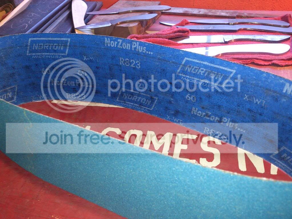

Hey Strig, I have been using a 4x36 with these belts.
I think Truegrit stocks them and I have found them in 10 packs by searching for Norzon R823. These are 60 grit Zirc belts and last a long time. I have not bought them myself because I get them from a materials testing lab that uses them to prep samples before going to the spectrograph. Get this, they have to use these belts because they won't contaminate the samples and they can only use the belt on one sample. The sample is little lollipop shaped puck less than 2 inches diameter. They then have to toss the belt and put on a new one for the next sample. They don't do this test very often but one of the guys is putting back some of the belts for me so I plan to continue to use my 4x36 for profiling and flattening among other things even after my 2x72 is finished being built.
