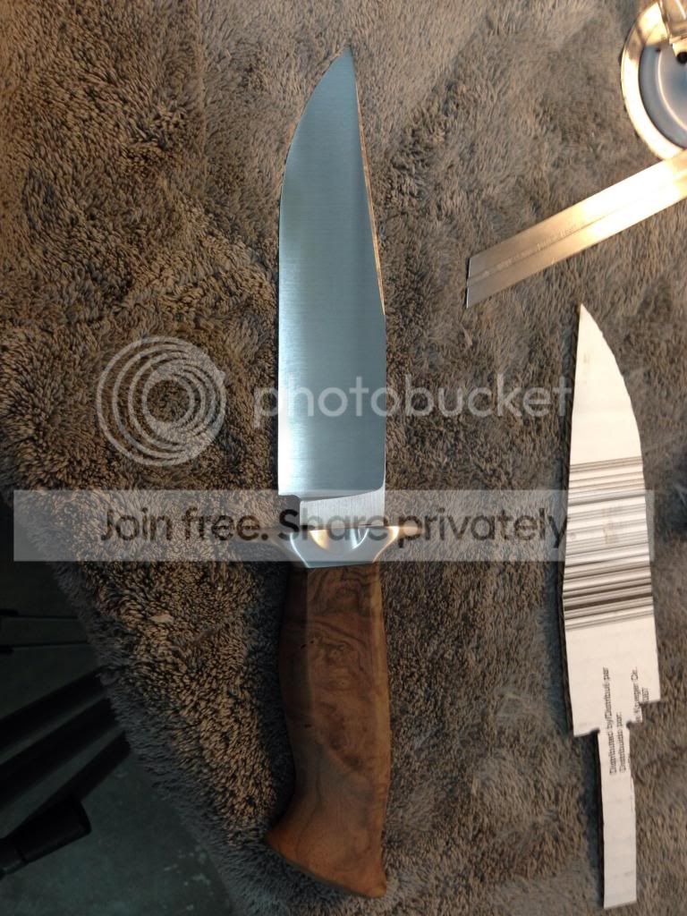

For me a Jig is my best friend. This is my 5th knife, the reason I took the picture was because of the grind. It’s not close to being done in this picture (please no judging) I just stuck it all together to see what it looked like. I was very happy with how smooth and even I had made this. Each knife I do, I seem to improve on how clean the grind gets. I considered leaving it alone and going straight to and edge. Some guys don’t approve of a jig but no more knives than I will make the jig is my friend. Just a note Bob I am using the same grinder you built.
For the guys that prefer to hand grind, more power to you I just don’t have that kind of time to invest. I doubt I could do as good even with years of practice.
