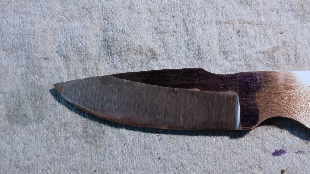

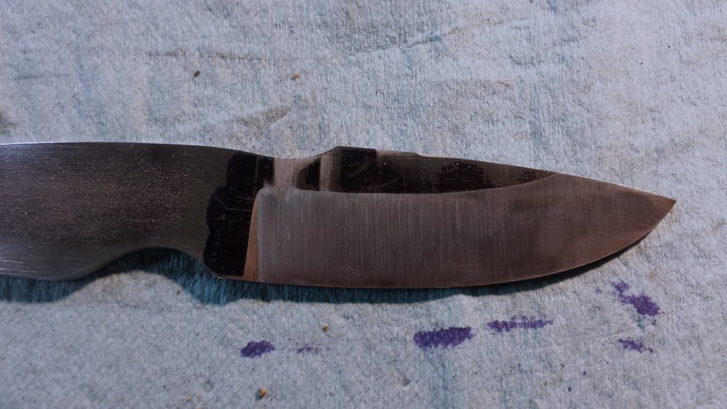

Today I ground blade number four. I am doing this freehand on the flat platen. I roughed it out with a semi worn 50 grit Blazer then went to a 120 grit Blazer. It was looking okay so I decided to try a 220 grit J-flex and things went downhill. The bump of the thin J-flex was giving me hell. After I had it looking pretty bad with the J-flex, I decided to try something new and threw on a A45 Trizact. The Trizact was real smooth and ran cooler allowing me to get the bevels back to half way straight again. By this time I was well past my scribed lines on the sides of the blades but I decided to keep experimenting to see what happened. I went back to a 220 AO belt this time that was a little stiffer than the J-flex. I felt like I was getting a feel for things with the Trizact but the AO belt kept chattering on me. I turned up the speed and did the best I could with it. Here are pictures for everyone to critique.

Looks pretty good, getting there. A nice sharp new belt is always a good thing. I know they cost money, but trying to push a warn belt especially when you haven't developed a feel yet will facilitate mistakes.
I can see where you are laying your edge down and rocking it onto the bevel. Using your body so that the hands stay constant helps this a bit. From there its just a matter of nice, smooth and even pressure all the way through. Reducing just enough as you come off the tip and making sure you follow through the stroke.

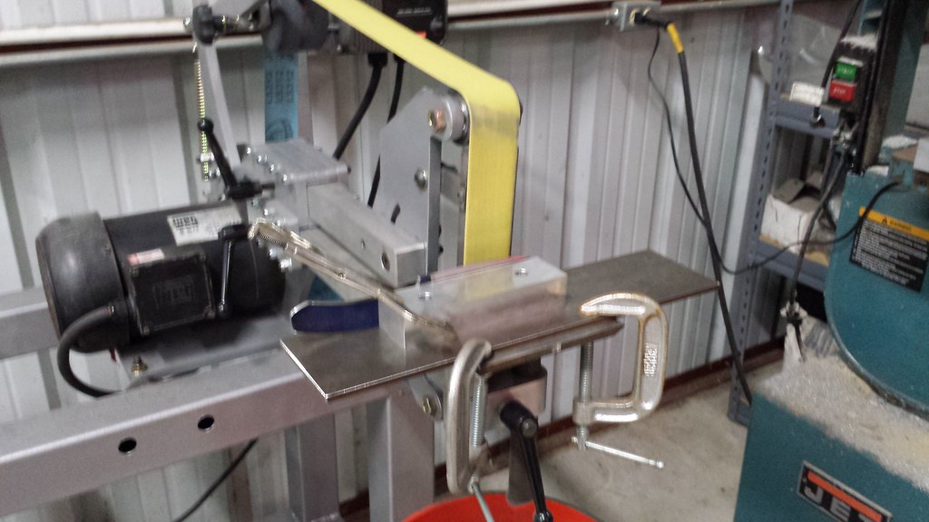

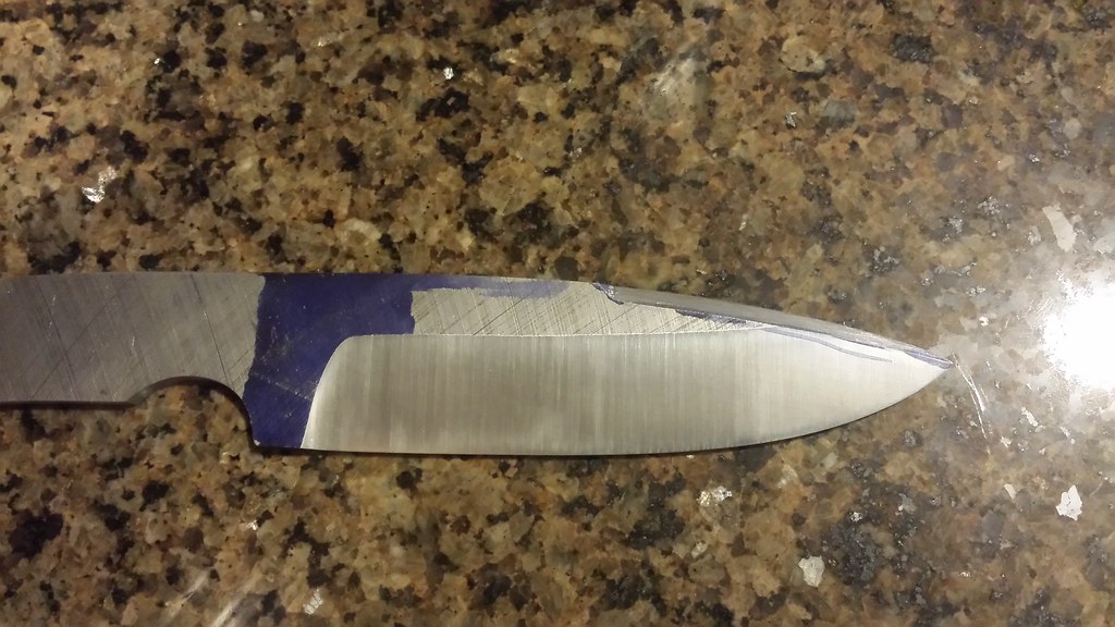

I was thinking about making a jig so I could produce something that I would feel was halfway decent. After a lot of thought on it I decided that I could just tilt the flat platen forward and clamp the blank to a square block. Below is a pic of how I set it up. The platen is set at 8 degrees. I knocked the edge off the bevels freehand with an old belt then clamped the blank and ground it with a new 60 grit Blaze. I'm really glad I did this because it taught me a lot about how the grinder works to produce the desired bevels. It really helped me to understand how you need to angle the tang back as you get to the tip. Obviously, that is just one way of doing it but it gives me a better reference to build from. It also showed me how careful you need to be when bringing the bevel back onto the belt. I found that the area just behind the belly was the best contact point for re-introducing the bevel to the grinder. The down side of using a jig setup like this is that you can't easily compare the two sides for symmetry. If I use this technique again, I would add some scribed lines on the side of the blade to give some reference for the top of the grind.

Lighting. I should know better.
I have to hook up another 110 outlet for the power feed on the mill anyway, might as well make it available for a grinder light.
