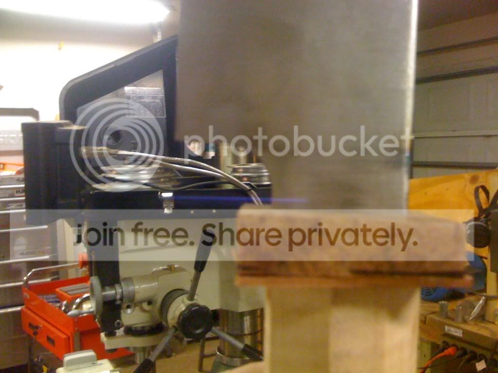

Heres one I soldered stainless to stainless- fore and aft thats dirt at the joint, the solder
is clean. I'm with Nick on the time- takes me a bit longer to do a good hole thru the handle.

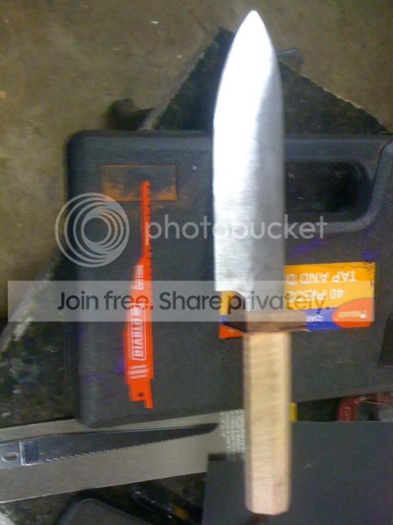

Well I ran to home depot and grabbed a few 2$ saw blades and made some ghetto style broaches and man did I not know what I was missing! I still want to find a nice 1/8" broach somewhere but these sped things along real nice!!! Making my wife a japanese inspired chef's knife. Now to heat treat the blade and finish some sanding on the granite to get everything perfect but this is what I have so far.
Knife and ghetto broach - knife is 1/8 1080 with curly maple .060" copper spacer and rosewood spacer at top
About 95% of my knives have been full tang so im kinda proud of mysefl here. Look MAW no gaps
Just got to sand and finish final shaping of the handle and take some time to sand on the granite I have so everything is perfectly flat and mates up well.
THANK YALL ALL FOR THE ADVICE!!!!!! This is for my wife's b-day at the end of the month so this knife is especially important to me and I appreciate the help to get it as nice as I can!
