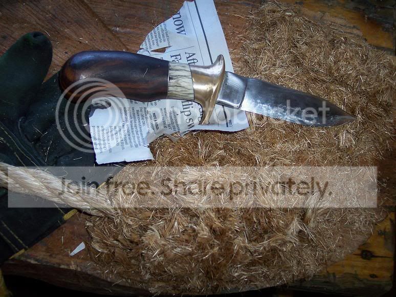

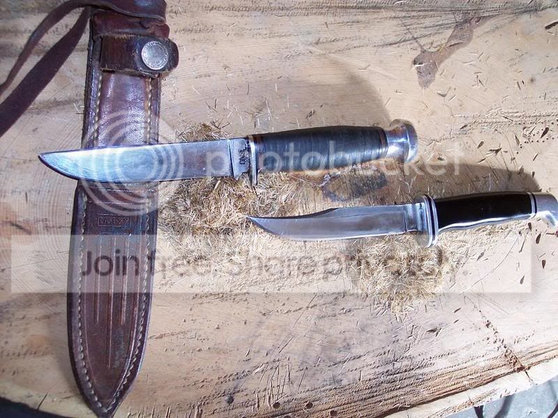

Cutting rope to compair knife ~ knife has some value.
For a maker, comparing your work to earlier knives, factory or other custom knives can give you a personal assessment of edge retention.
Pictured are a couple factory hunters, and a custom knife, I know how they stack up to each other. Maybe just me, but that has a personal importance.
