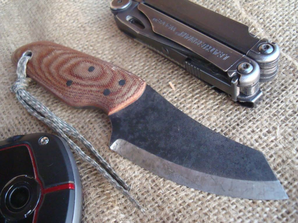

Always having been a knife enthusiast, I found Bladeforums to be a fascinating place to see what was being made in the world of knives. In short order, I found Andy's forum, and realized that his style was what pleased me most - both to see AND to use. The Grace Kelly handles and Gary Cooper blades were the spark that got me wanting to be able to create something that was so sexy, but capable at the same time. Then Dylan came along and we watched him go from apprentice to full-time knifemaker (and recently, rockstar) seemingly overnight. So I saved up and got the KMG built, some 01, and some handle materials and went to making dust and sparks about 6 months ago! They are far from perfect, but I have fun and I'm improving. Still haven't worked out a maker's mark...and I'm only on my second "batch" since I have a family and day job that takes most of my time, but it sure is rewarding.
Up to now, they've all been 1/8 thick 01 tool steel, 12.5 degree scandi, heat treat by Peter's, micarta pins, and a blue/bleach etch followed by a final blueing.
I haven't posted any pics in Andy's forum until now, because...well..it's Andy's forum. But he said I ought to post a few...it's all his fault, anyway! :)

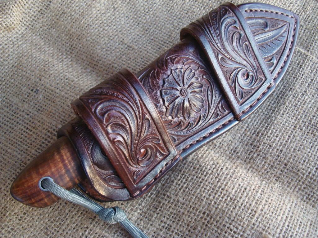

The first few were a quick lesson in handles, primarily pin placement. I wanted to do an angled scale on the front of the Koa Nessmuk variant, but it didn't work out and the pins ended up too close to the front! It turned out too pretty to chisel off, and it was the first - so I kept it and got my cousin to make a horizontal sheath for it.
I did a WIP thread on it at the time.

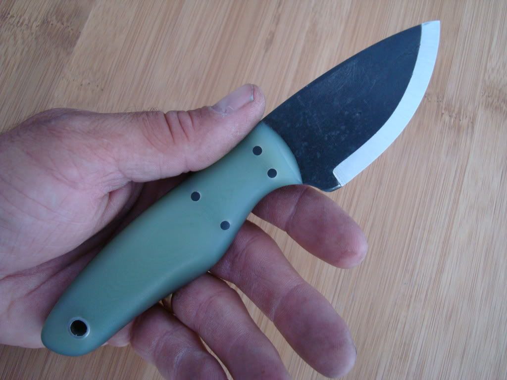

Jade G10

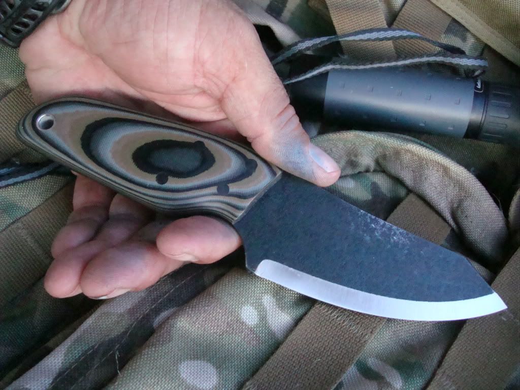

Then I tried a few...non-Fiddlebackish designs, for fun!

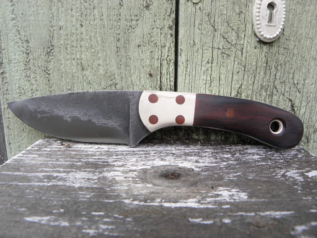

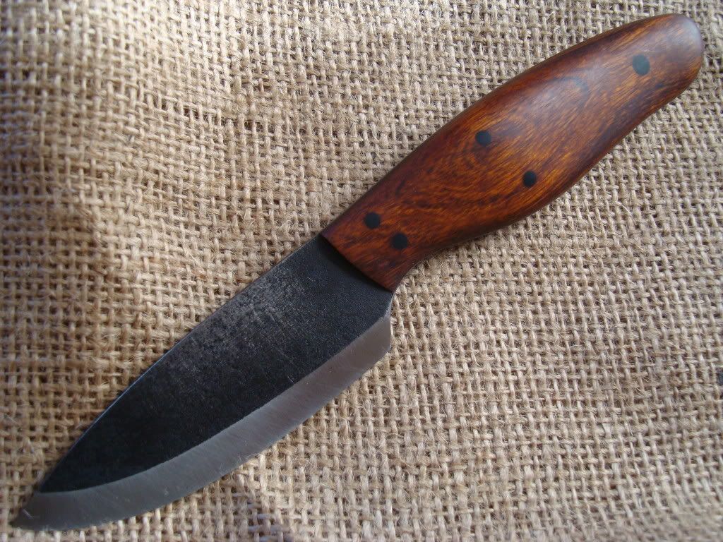

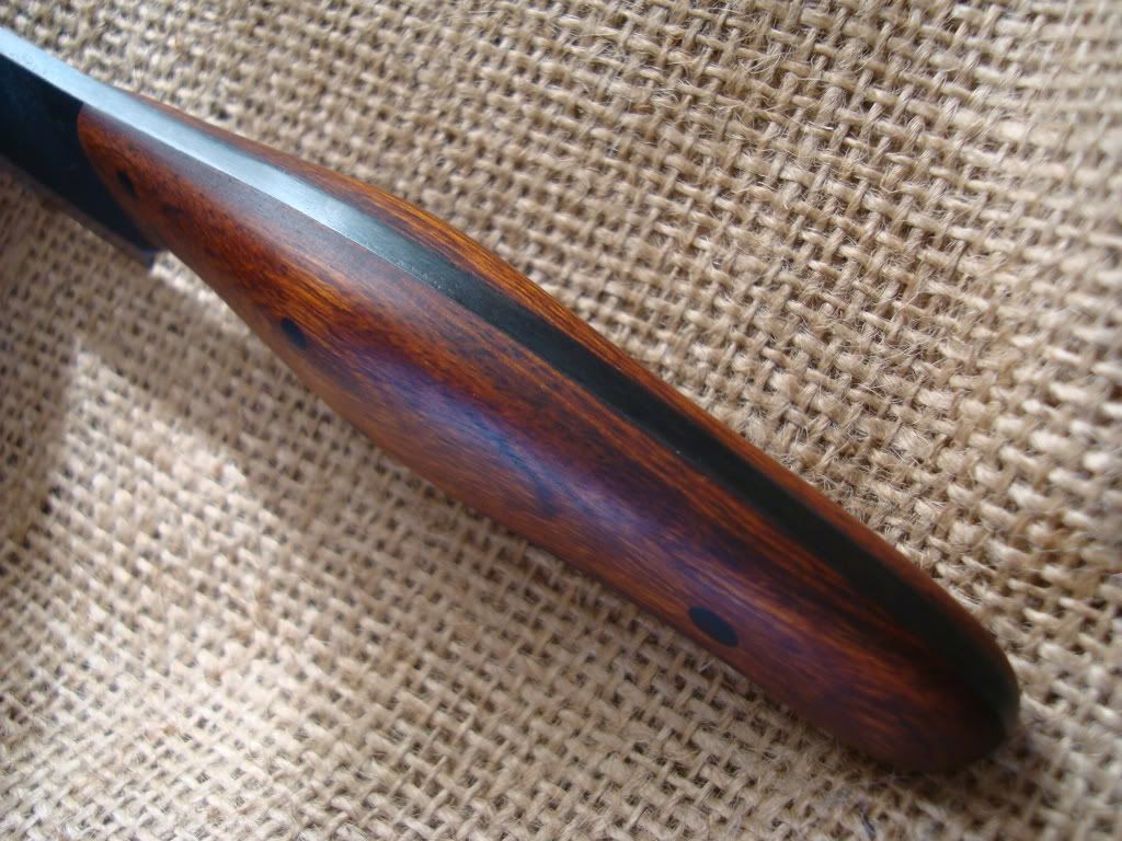

Then back to something more traditional, with ironwood. This was a slender prototype with an inside-the-belt kydex sheath for my cousin to try out for awhile and then send back...he hasn't sent it back yet. :)
He sent me a cell-phone pic of it a few months ago...I guess it's still working for him!

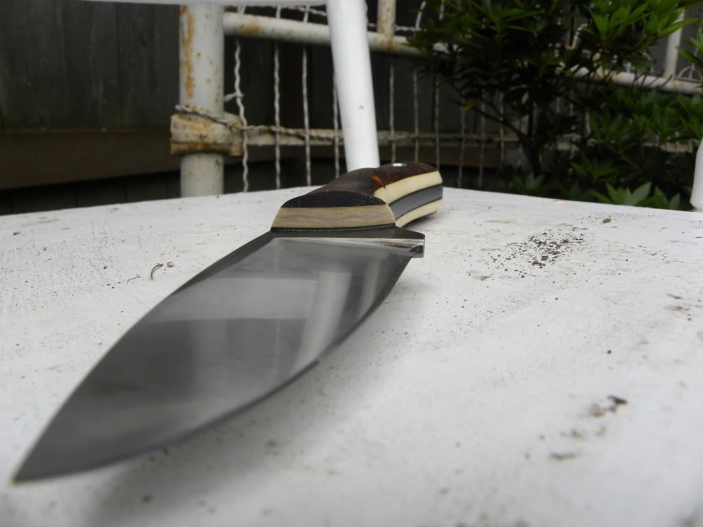

Here's one I made and kept. Carry it daily. This first pic is before sharpening, almost finished sanding the handle.
And my first attempt at liners...still sanding this handle, and the other knife is a Koster that I'm putting a handle on for a friend. Both Osage Orange.

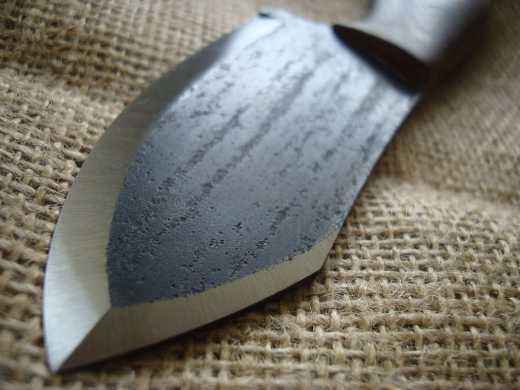

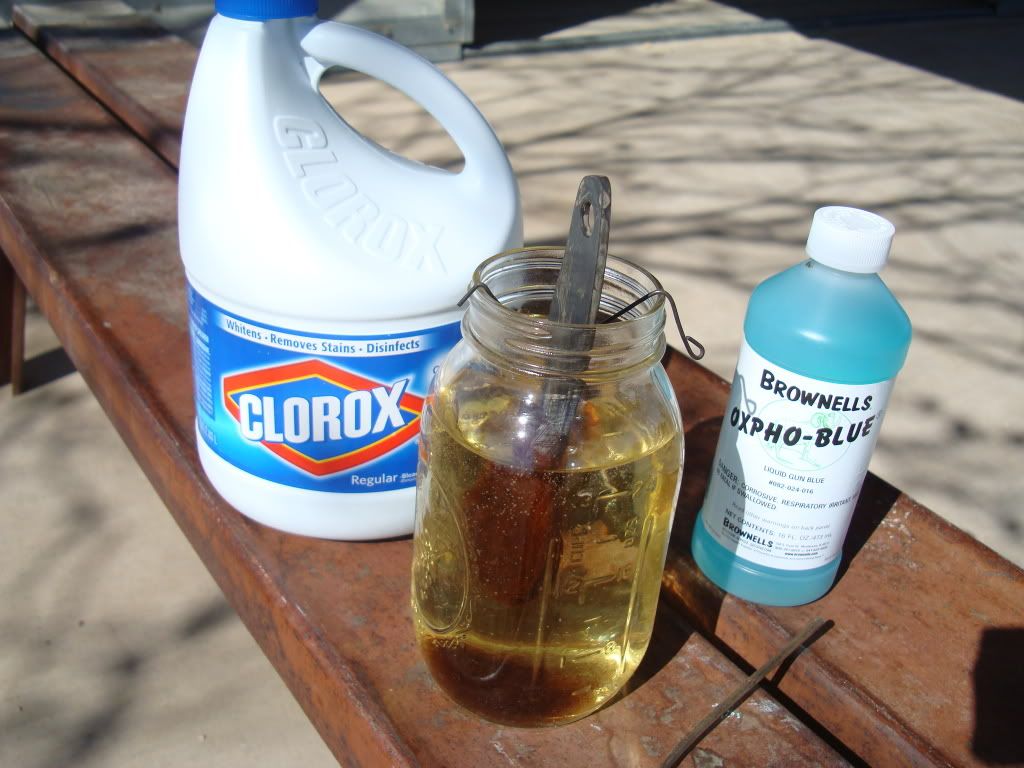

And most of the current batch that is waiting for handles...got a closeup of the blueing/bleach etch on these. I've decide that the secret so far is to etch them BEFORE heat treat, for a much more even and controllable pattern. I like it, anyway! That one on top is getting Walnut.

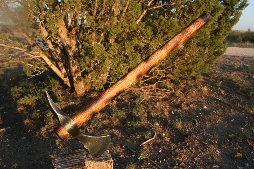

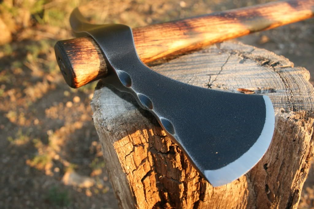

And on a side note, I've had a blast pimping two Cold Steel Spike Hawks! Gave one to a buddy, and the other went to an LE salesmen at LWRC after a Ferric Chloride etch. Now I have to make two more like it for another of their salesmen and for their SHOT booth. These are fun to do, and the hardest part is getting the factory black paint off the head! :)
A few more in progress, along with an old fire axe I'm fixing up for another buddy..

Love the big Nessy with the tiger maple and that blade which has osage with red liners. Also is that swedge sharpened on that one or is it just a false edge?
When you get your convex grind down me and you might have to talk about one of them there EDC's, very practical looking blade my friend. NICE!!!!
