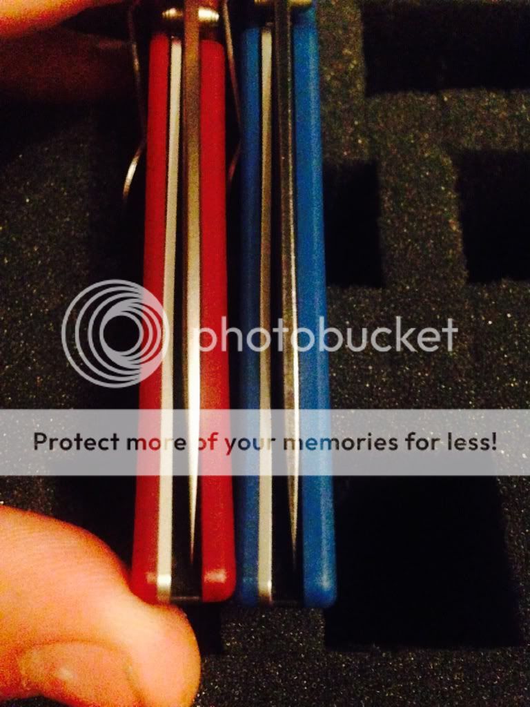

Several posters have commented on a price point at which they would accept an off center blade. My point was not about materials; it was about craftsmanship. If it is possible to get centering and quality control right for $10, price is not really relevant. In other words, if it can be done right for $10, then it can't be an expensive process. When I look at the two photos I posted above, there is a 12x price difference, but I don't see 12x the craftsmanship.
But thanks for your comment about my 'crap' knife; just for the record, the lock is fine (as I said) as are the rosewood scales. I accept that Chinese stainless may not be as "good" as S30V but again, that was not my point.

Picked up an Adamas a few weeks ago and the blade didn't rub but you couldn't get a sheet of paper between blade and liner it was so off! Rather than send it back I did what Keyman said and it's almost nearly centered now! It was about like CJZ's pic before.Of my 3 other Benchmades 2 are off center so for me it's been a 50/50 deal now! Haven't taken the time to work on my new Barrage yet but yes it's about the same! :-( doesn't rub but close!
