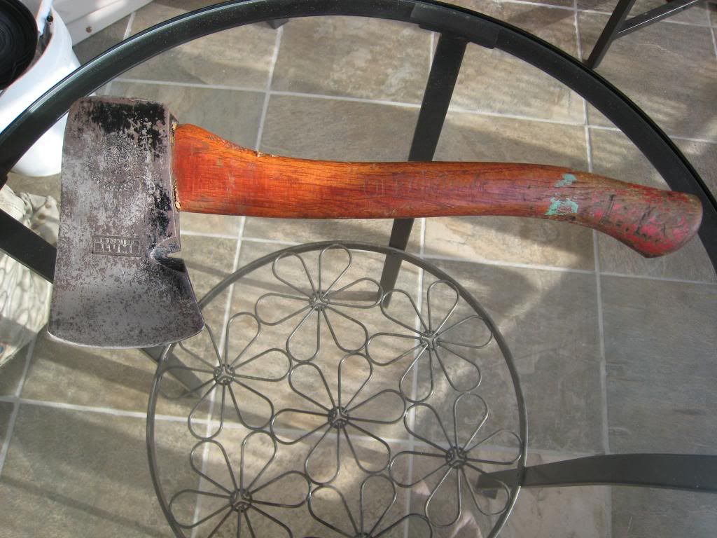

Anyone know any ways to tell how old one of these plumb boy scout hatchets is ? Just curious. I went hunting around for an old project hatchet and found this one. It doesn't seem to need much rehab so I guess I'll just Sharpen And lightly clean it.
That's a nice one, looks like someone has thinned the edge already too.
I have one from my Scouting days, (early 70s), and it's a Plumb too.
I think the ones with the nail remover pre-date that, so at least you have
a general idea.
If u go on the Boy scout website they have the years on there. I think plumb had a wide range of years though.

Indeed they did, and only this model - the first model - had the BSA First Class badge opposite the nail pull

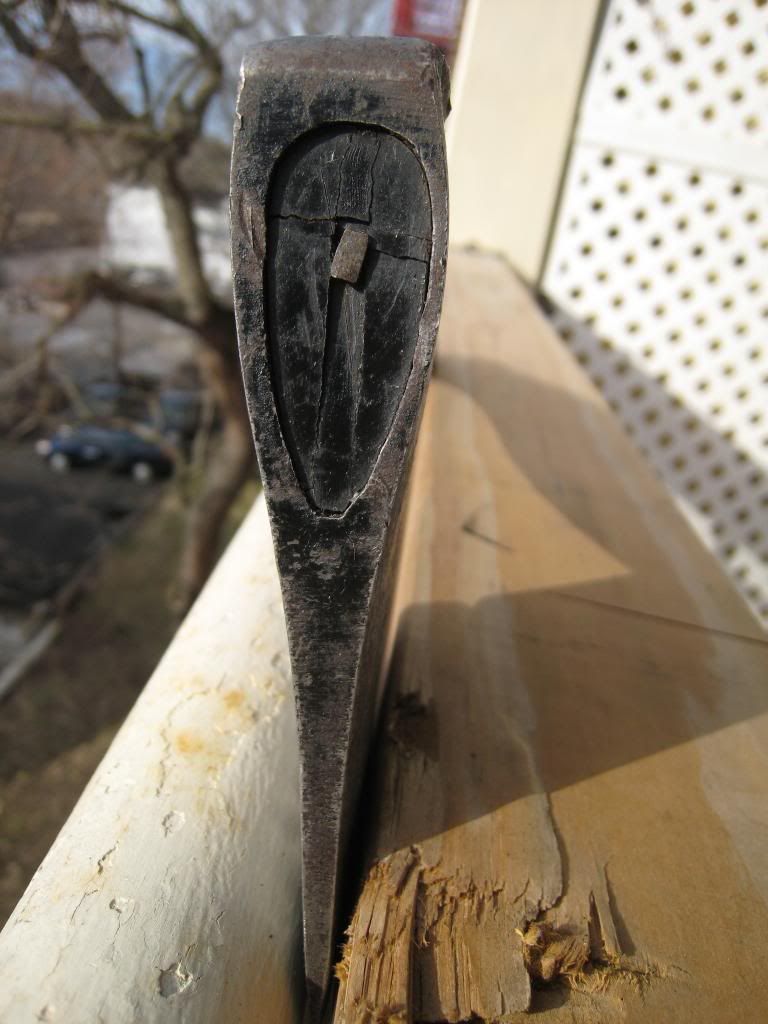

As originally made, the wooden wedge is pulled down into the handle, tightening the hold on the head. You picture does not reveal if that is still the case.
Kids were and are hard on equipment - especially impact tools.
When I found out about that construction I thought it was a really clever, but was it functional the way it was made?
Yes. I have several with the "take up wedge," and the heads are very secure. I have done quite a bit of chopping with one in roughest condition.
I'm glad to hear about the take-up screw. If I'd ever come across one I'd have hacked it out as an improper wedge.
It appears that there is s brass wedge in there behind the screw and possibly a bit of wood toward the blade side of the screw
I am sure you are correct. Perhaps a simple wooden wedge, or later the "Permabond" was a cost-reducer for Plumb.

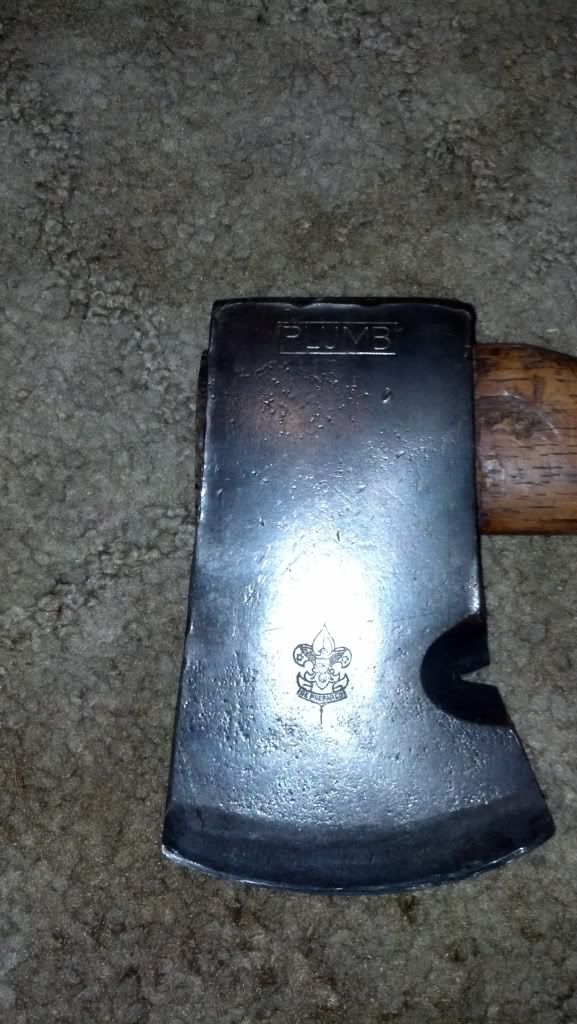

OP's axe is BSA # 1002.

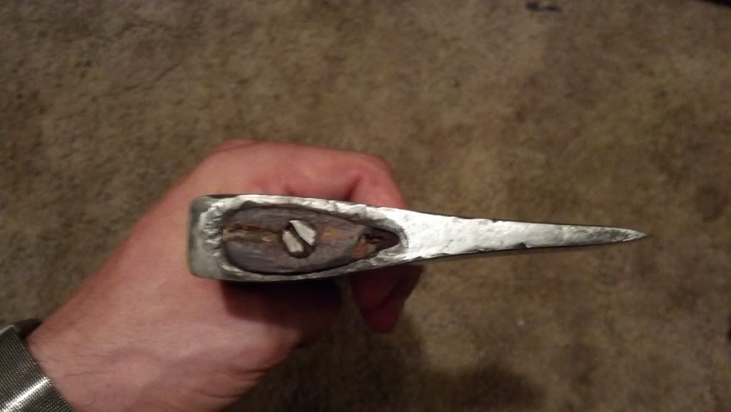

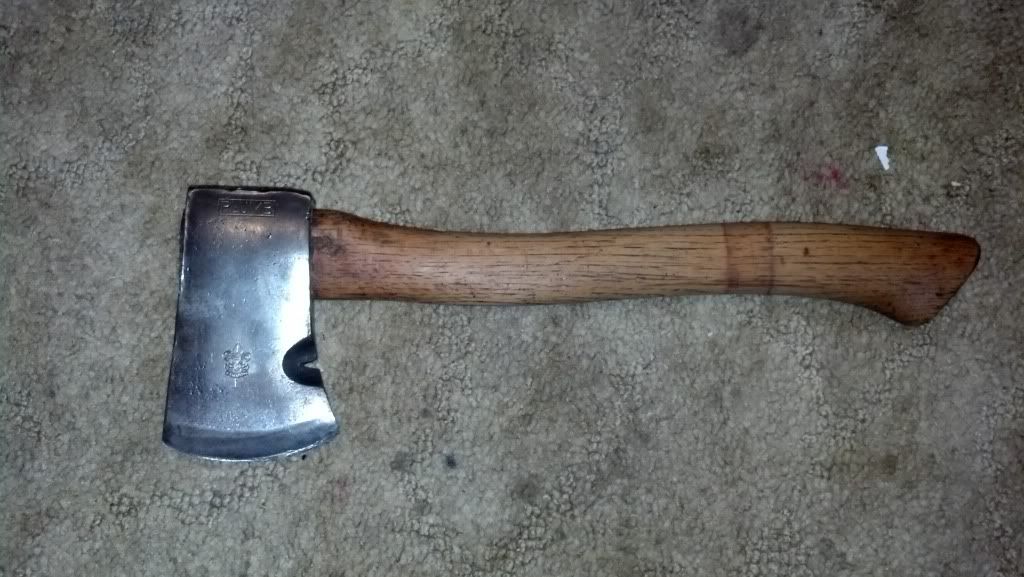

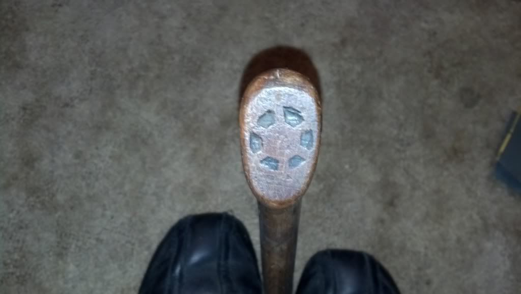

hepclass, you have a BSA # 1510 sold during the 1930's - with remains of original paint job on the original handle. Pretty full head.
Thanks Thomas L, I do not have the take up screw in mine but what looks like a masonry cut nail? thank you for the date and # .
