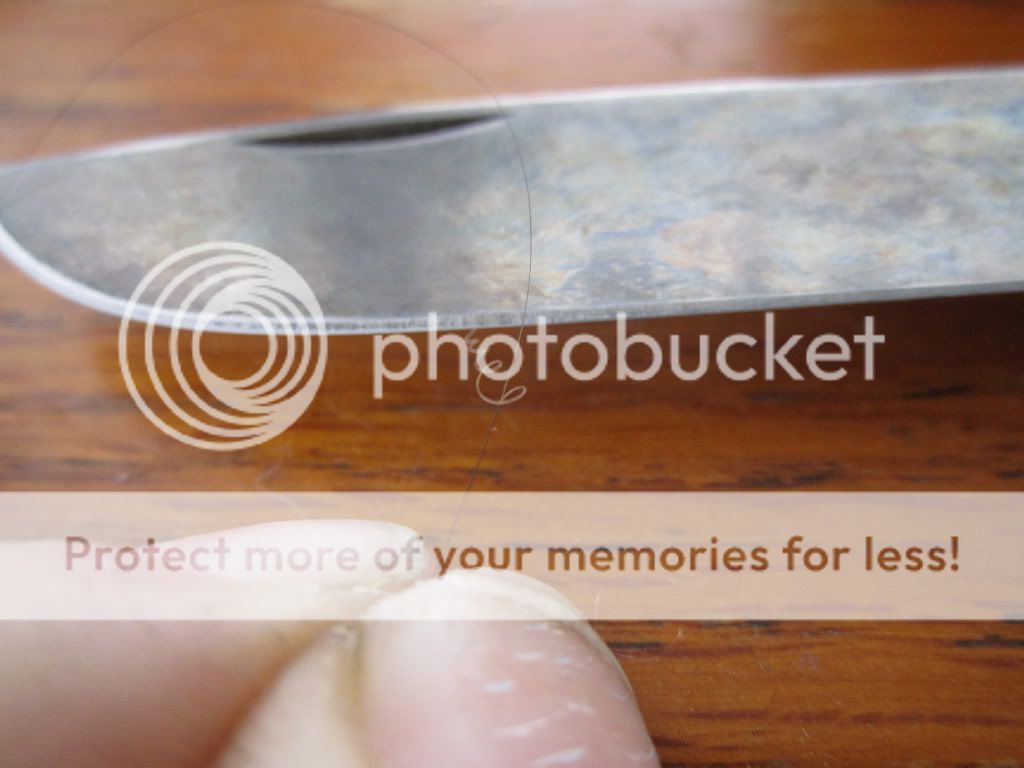

Everything except a large double bit axe are hair popping sharp,that includes tomahawks,large/thick kukris and all the thick knifes,the sharpest however are my kitchen knives,got 2 cuts yesterday as i was trying to see if they would pop hairs,they dug into my forearm leaving some nice cuts,they push cut soft tomatoes.I use Japanese water stones,rough/medium/fine/very fine and then strop on newspaper,1 fine and 1 laminated(not sure the term,but the extremely smooth one).I only put the crazy sharp edge on the kitchen knives however,the use isnt anywhere near as intense as my field/work knives so the edge doesnt see any abuse.I dont think its necessary to have such a scary sharp edge on most knives,i think its just my OCD kicking in when i combine a knife and a stone.

I just recently got to a point where I can split hairs with a stropped edge, green compound on a bench strop.

You can shave with all mine, Thats just my thing if i cant shave hair with a knife i wont use it.
