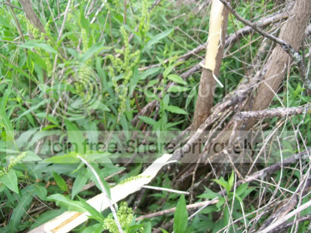

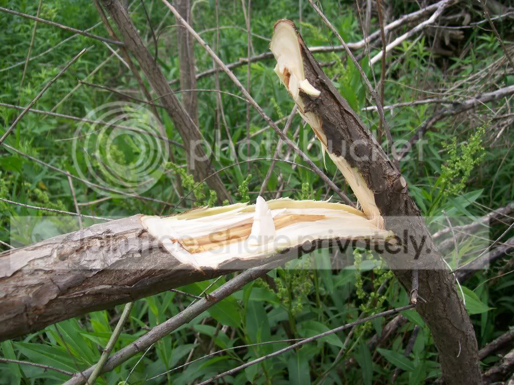

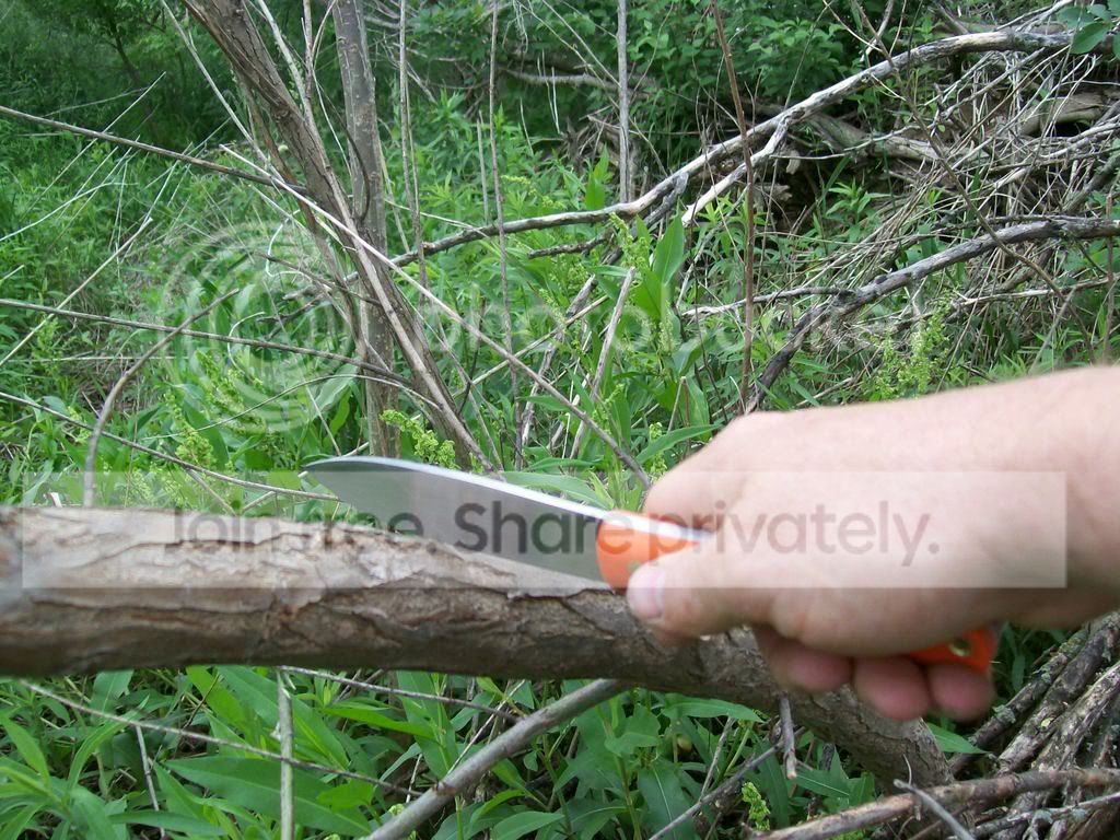

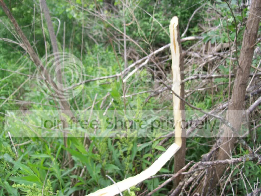

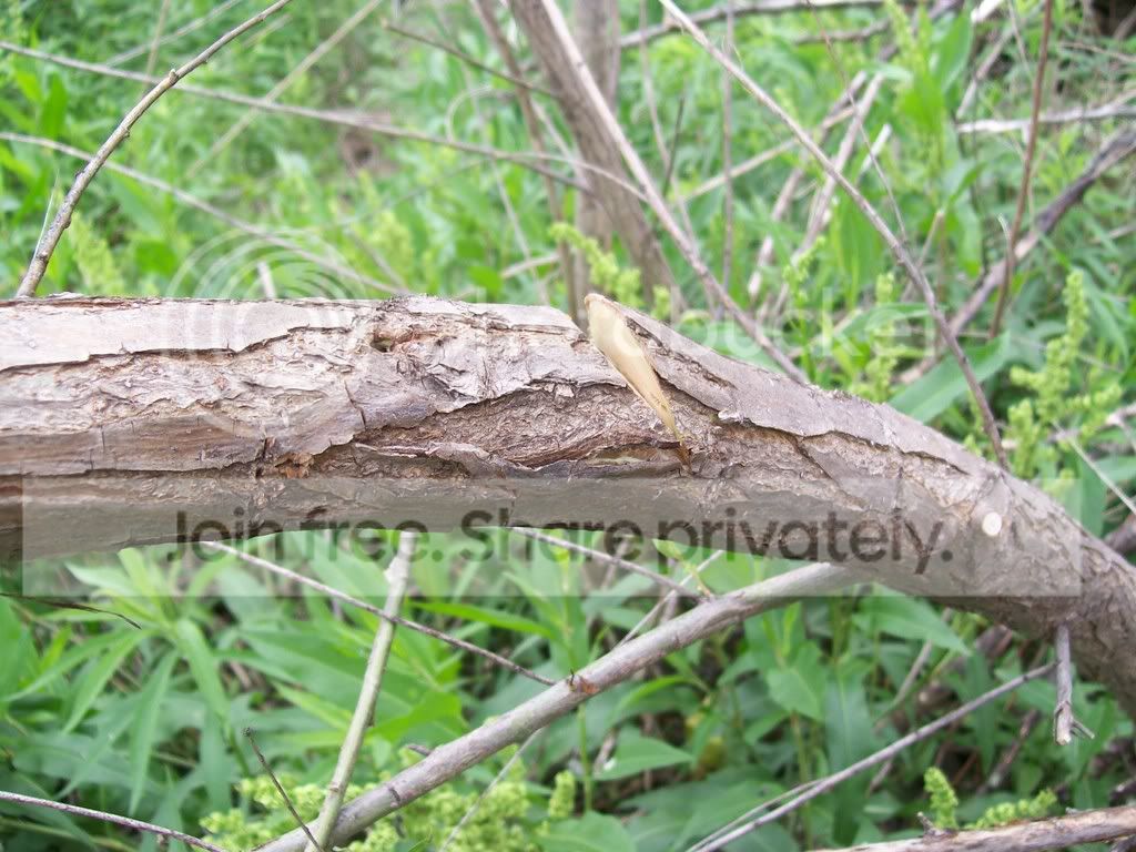

Hi all I took a new 1/8" Pathfinder with a 5" blade length out to do a little cutting today on a
willow tree it took four snap cut chops to cut through it. 3 chops really did
it but the last one cut the strip of bark off that still attached to the
trunk. Here are some pics:D
In the first pic I bent the small tree over and then placed the Pathfinder
where I was going to make the first snap cut.
Then the first snap cut went down into the branch about 3/4" of an
inch or so.
This is the second snap cut.
Then the third snap cut.
And finally the last snap cut.

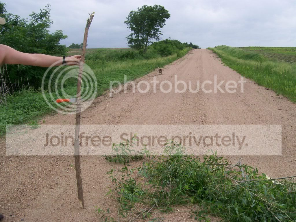

The next pic is of the branch that I cut and de limed.
One thing about a little longer blade is it makes snap cuts easyer to do.
