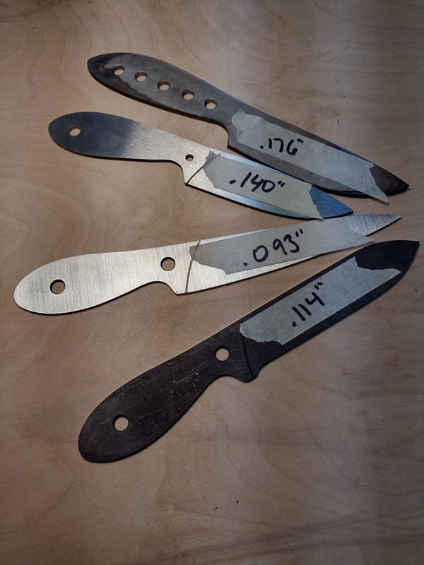

.095" for a blade used outdoors as in camping or bushcraft is an absolute NO go in my opinion. I personally would not want a blade thinner than .18 on a knife with a blade over 6 inches. If it's a 4-5 inch skinning knife than I would probably not want anything less than a .15 blade thickness so it can take a hit against bone with minimal damage
Anything less than .125" is a no go for fixed blade carry knife in my world. A blade this thin could be sat on and bent. I've bent my Tops Al Mar SERE and that's around. 15". It's all preference but I wouldn't even want a folder that thin. A paring knife perhaps but I feel robbed with blades so thin. The only thing I would buy at .095 would be a folder with a blade length less than 3 inches.

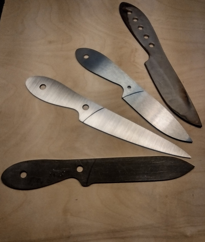

I haven't even started grinding on these knives, and they are Way thinner than what people are talking about....😂
And here I thought the top one was going to be Chunky? ;P
The bottom one is going to be a 5" Kephart. CPM Cruwear ....62-63HRC with a state of the art heat treatment. Thin.
It's not going to bend, or be delicate.
But it Will cut!
