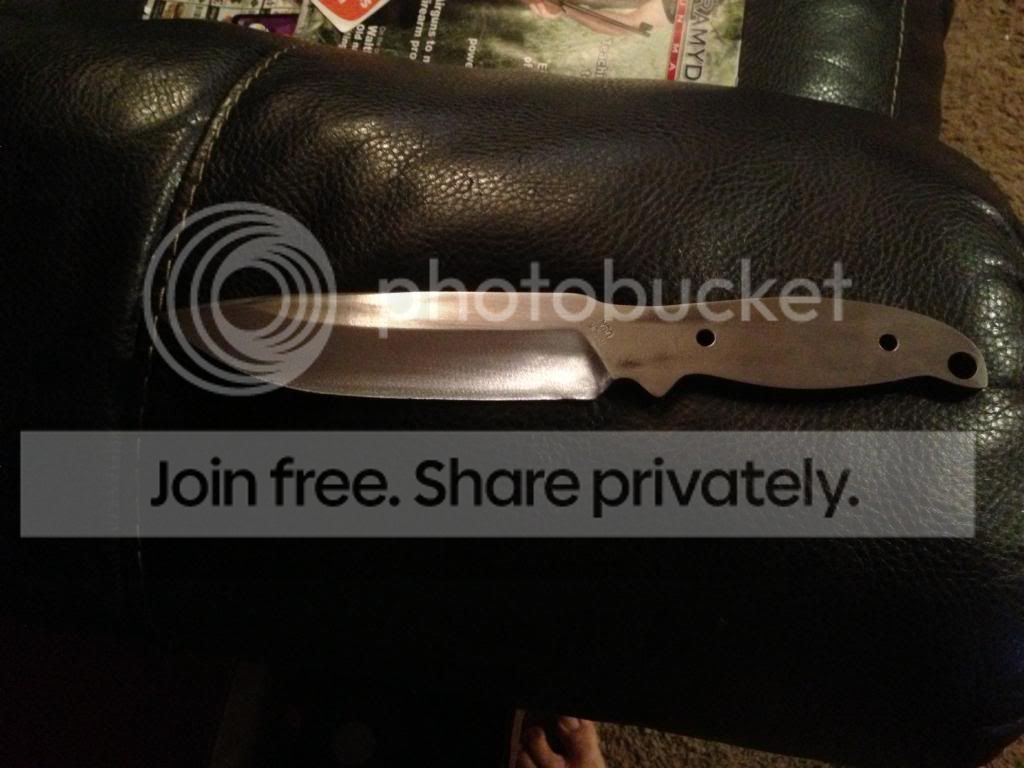

I got the results back from the hardness test today. The good news is, my files were pretty much spot on as far as what I was guessing they were telling me. The bad news is, what they were telling me was not what I wanted to hear. The blade tested at 54-56 RC. Thats after 2 hours at only 325, a 1 hour acetone/dry ice bath, and 2 more hours at 350. I am very dissapointed. Its a somewhat useable blade still, so I may just finish it and give it away to someone. I am going to try a fresh blade tonight in a much larger quench tank and see if that makes a difference.
Here is a picture of my failed mission. Fortunately I have 5 more just like it to practice on. LOL
