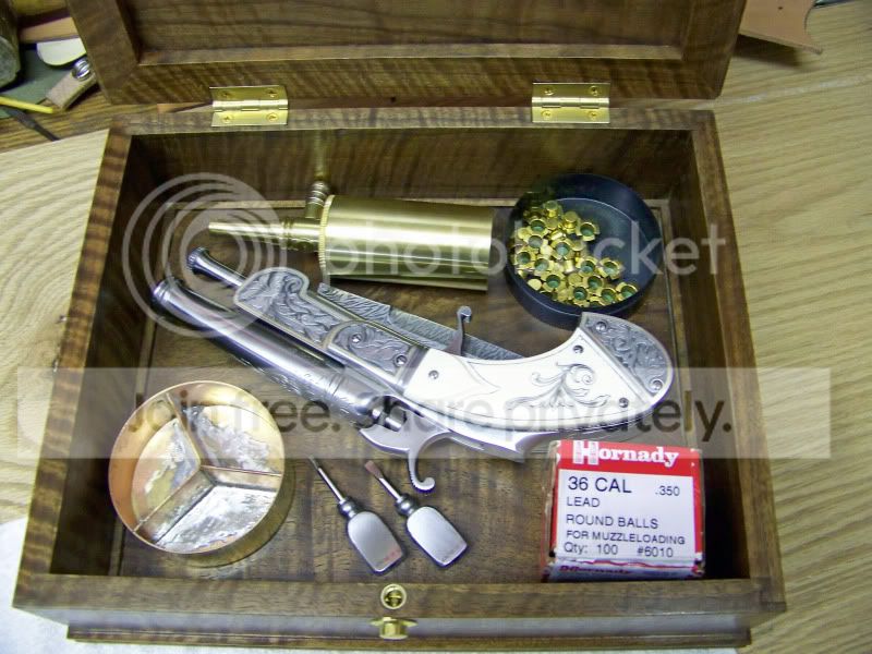

There is no end to this gun/knife project. Now I need to make a storage/display box for it. I had the black walnut box made here in town by a custom cabinet maker. I just need to make the interior to hold the pistol, powder flask, 2 screw drivers, and the bullet/cap box.
There are other ways to do this but I do it this way and it works for me. This one is for "Liberty" gun/knife but a nice bowie can be stored and displayed this way. I have done these with a glass top too.

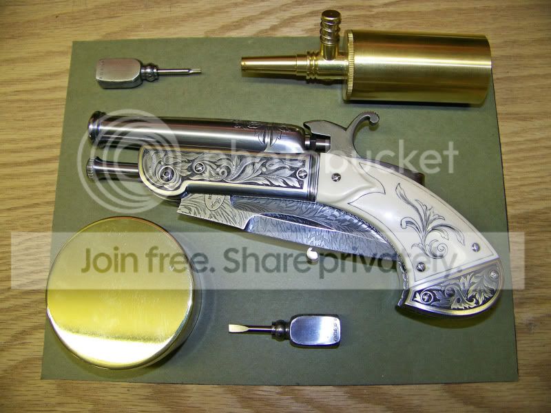

Here are all the parts that will go in the case

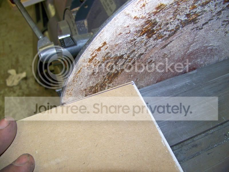

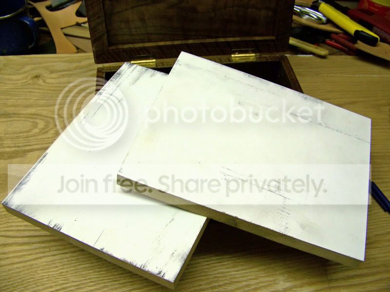

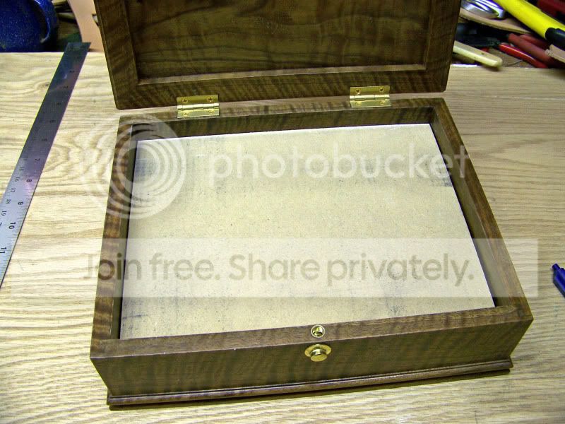

This is MDF from Home Depot. It looks like particle wood but is compacted saw dust and for interior use only. I like it because it shapes, sands and finishes easy.
Just saw and sand it to the right size to fit into the box. I like to leave it a tad smaller for easy removal. It gives a nice place to store the certificate of authenticity and ivory affidavit or origin underneath too.
I make two of them. The top one will get cut up so the parts will nest down into it.

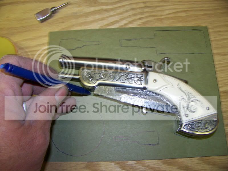

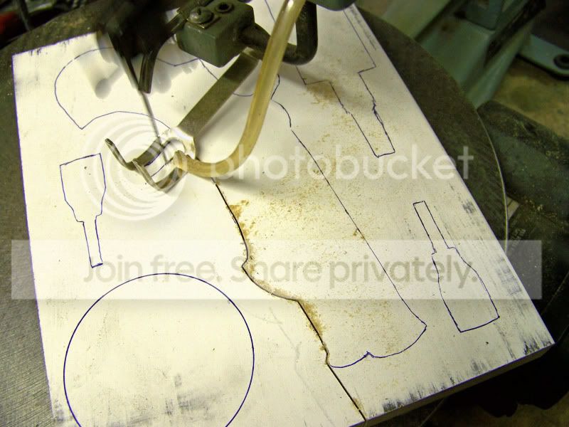

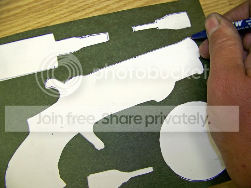

On a piece of heavy paper I place the componants and arrange them the way it looks good and fits best.
Next trace around everything leaving some wriggle room and cut out them out.

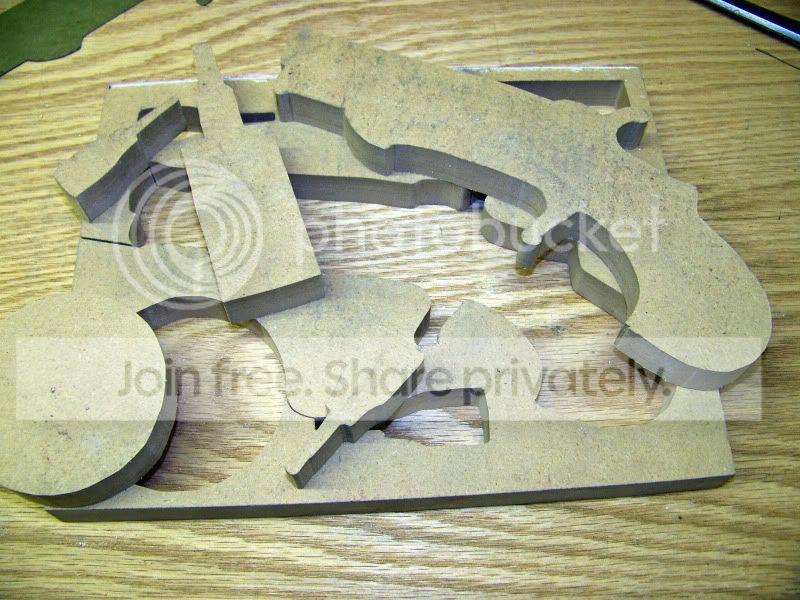

Next simply transfer the paper template to one of the MDF boards and cut them out on a jig saw.

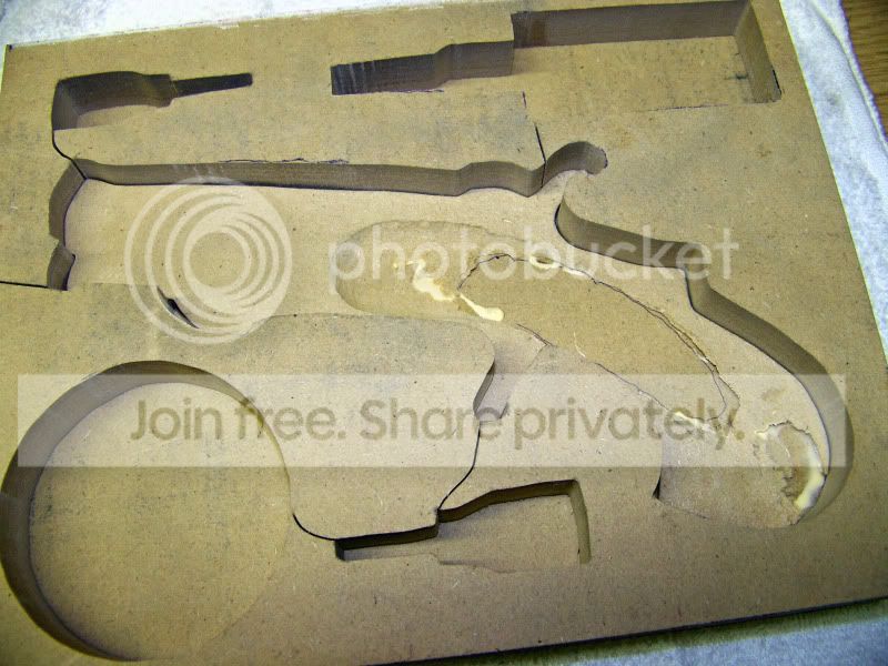

Place the components into the openings and make minor adjustments around the edges so there is space around them.

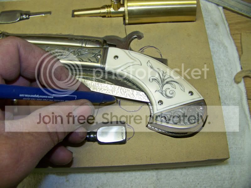

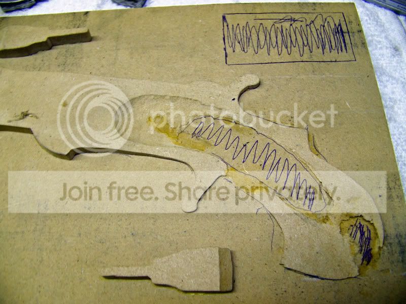

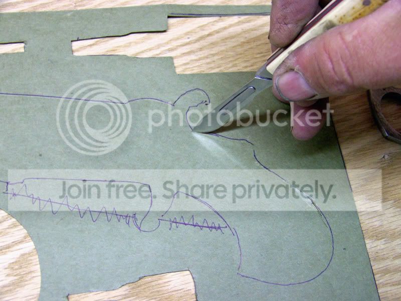

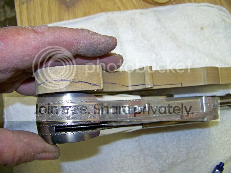

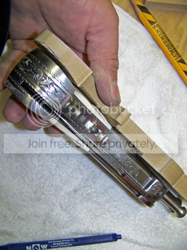

The parts that are cut out will be used to go back in and modified as spacers. Here I have rough drawn the shape of the side of the gun. The goal is to contour the spacer so the gun sits level and doesnt rock around.

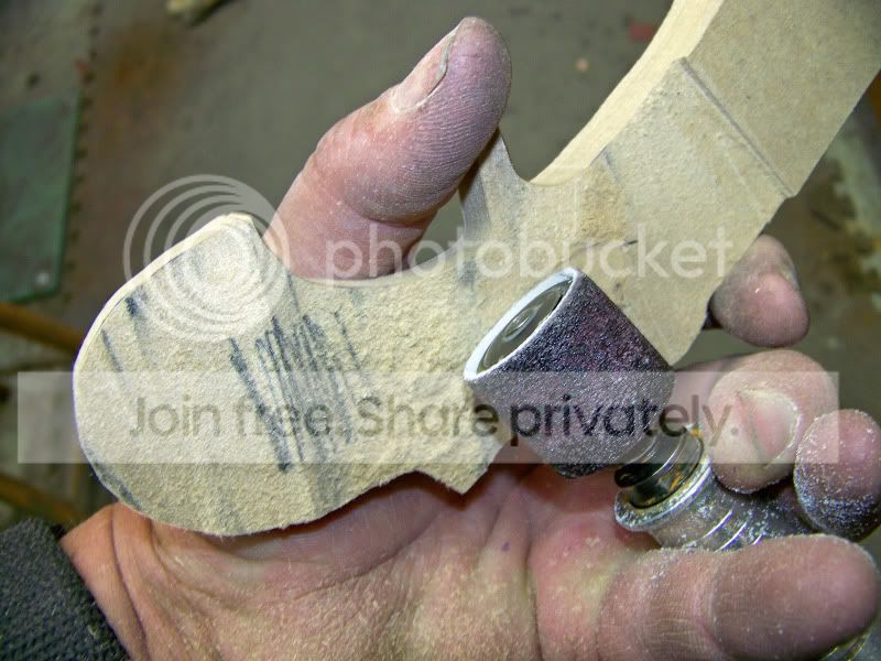

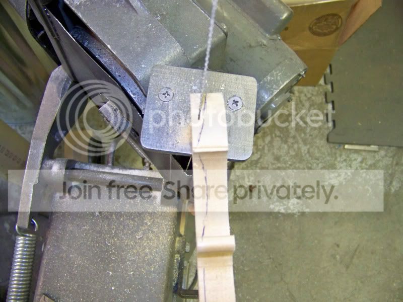

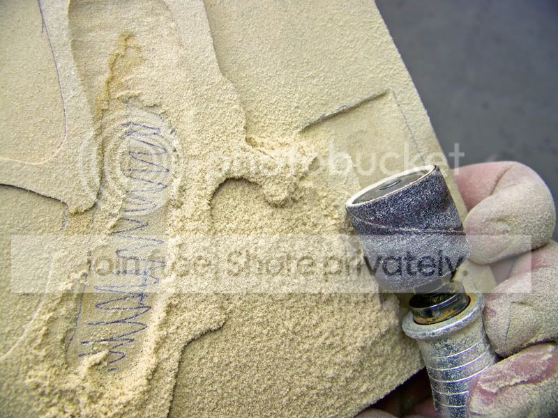

I use a foredom to contour and sand the spacers.

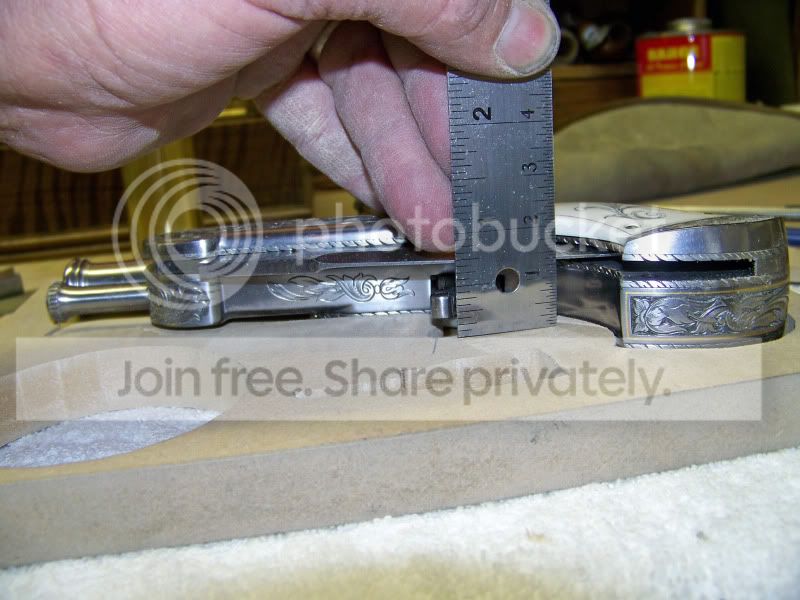

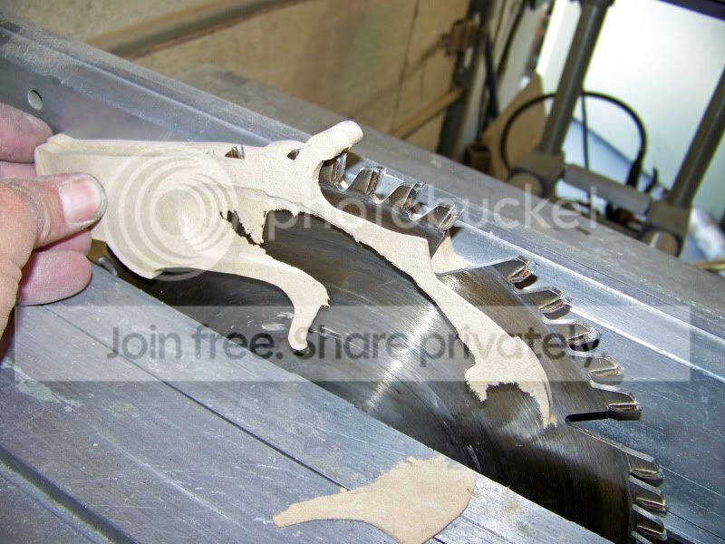

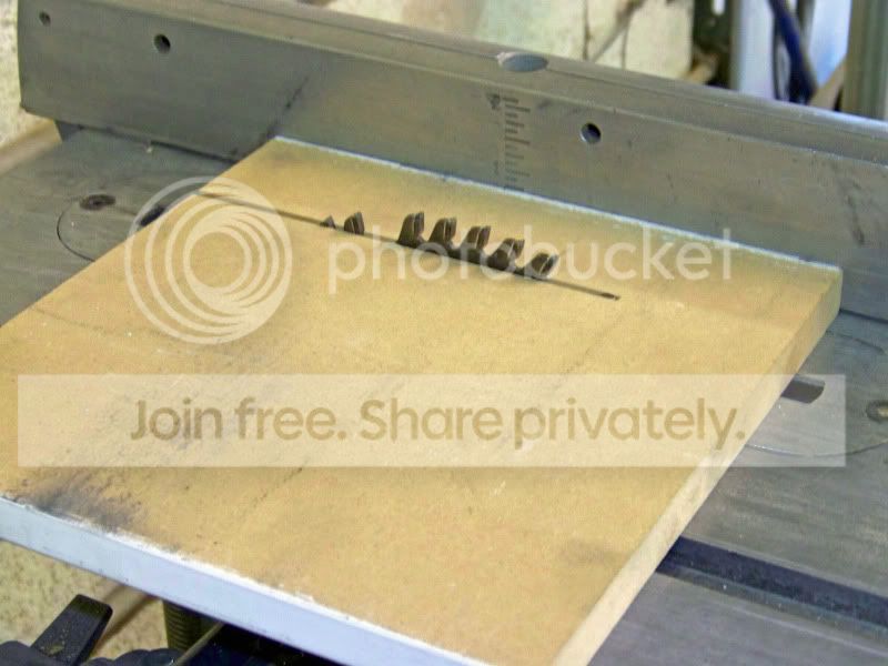

OK it fits good but is too thick. I measure it to see how much I need to saw off to lower the gun down. I use a table saw and cut off 3/8".
I know, dont worry it cut through some of my contoured piece. Oh and the saw isnt running so my fingers are not about to get cut off.

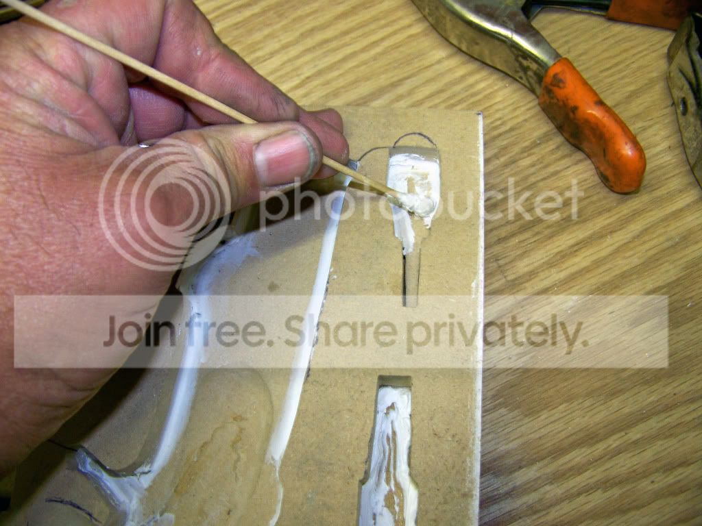

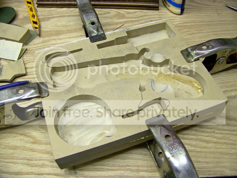

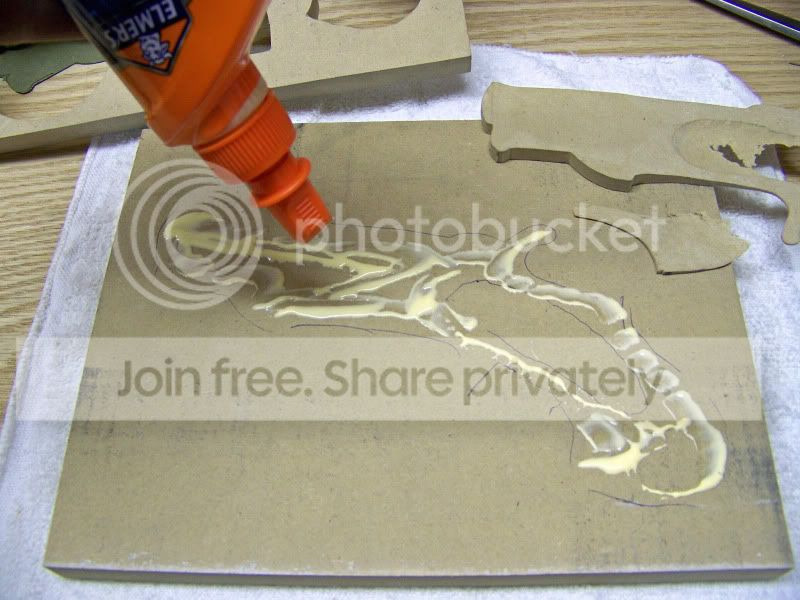

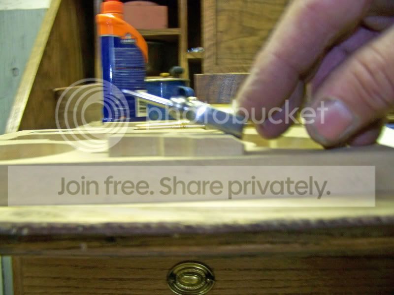

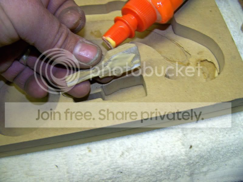

Ok so I just glue the pieces inside the cut-out.

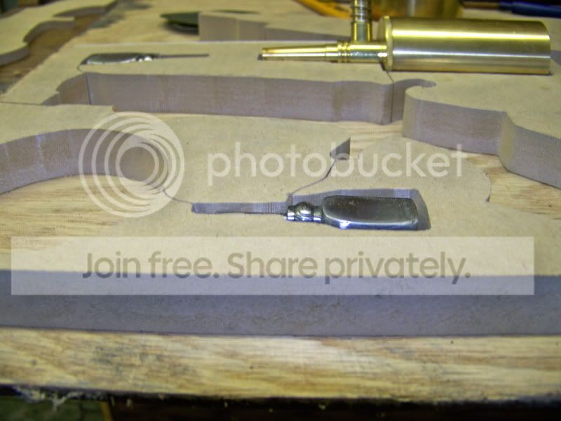

The screw drivers get the same treatment. The idea is to keep trimming the spacers so they are about level with the top surface.

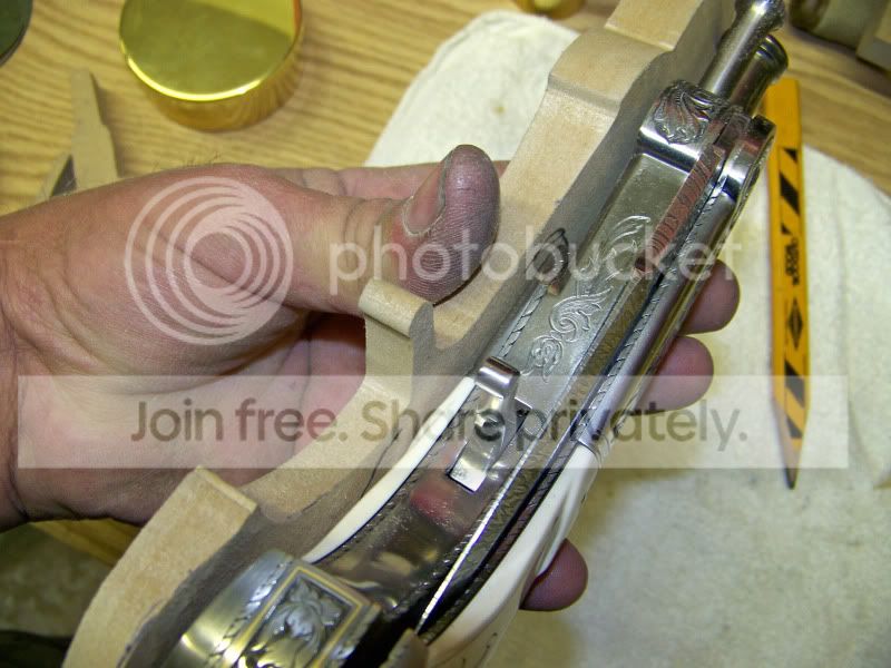

Here is a little trick I use to get them out. Simple sand a bevel off the end so you just push down and it pops up.
Now glue both screw driver spacers in place

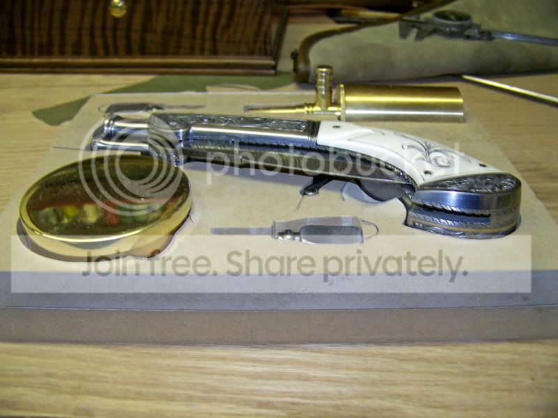

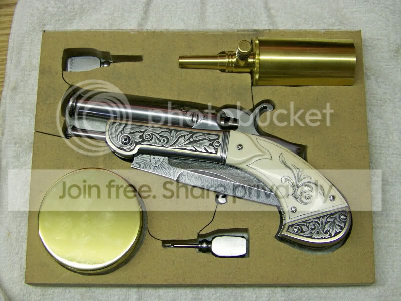

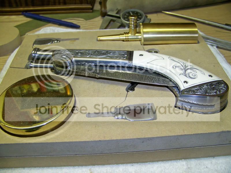

Assemble the parts to see if other height adjustments need to be made. I see the powder flask is too high so I will grind away wood under it until the spout is about the same level as the screw drivers.
These shaded areas need to be ground away and sanded to the correct depth again so things all sit level.
To make it easy to remove the components I make some finger grip recesses.
Everything looks to be the right height now. I didnt do anything to the bullet/cap box spacer as it was OK if I just left it out.

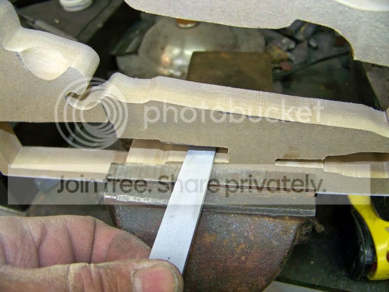

Now I touch up the side walls with a file and sandpaper.
Now simply glue and clamp the top onto the base. I use Elmers glue. This is where I am at the momment. Coming next is beveling the sharp edges and filling gaps and saw kerfs. Stay tuned for the Flocking. Thats my favorite part.

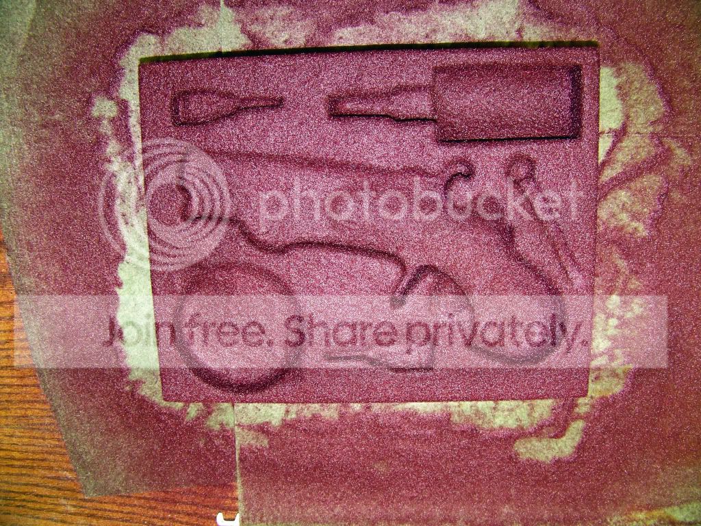

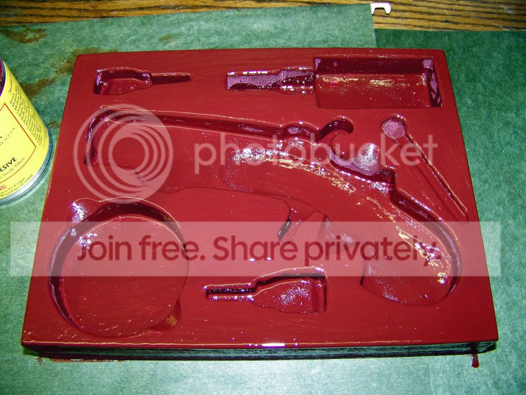

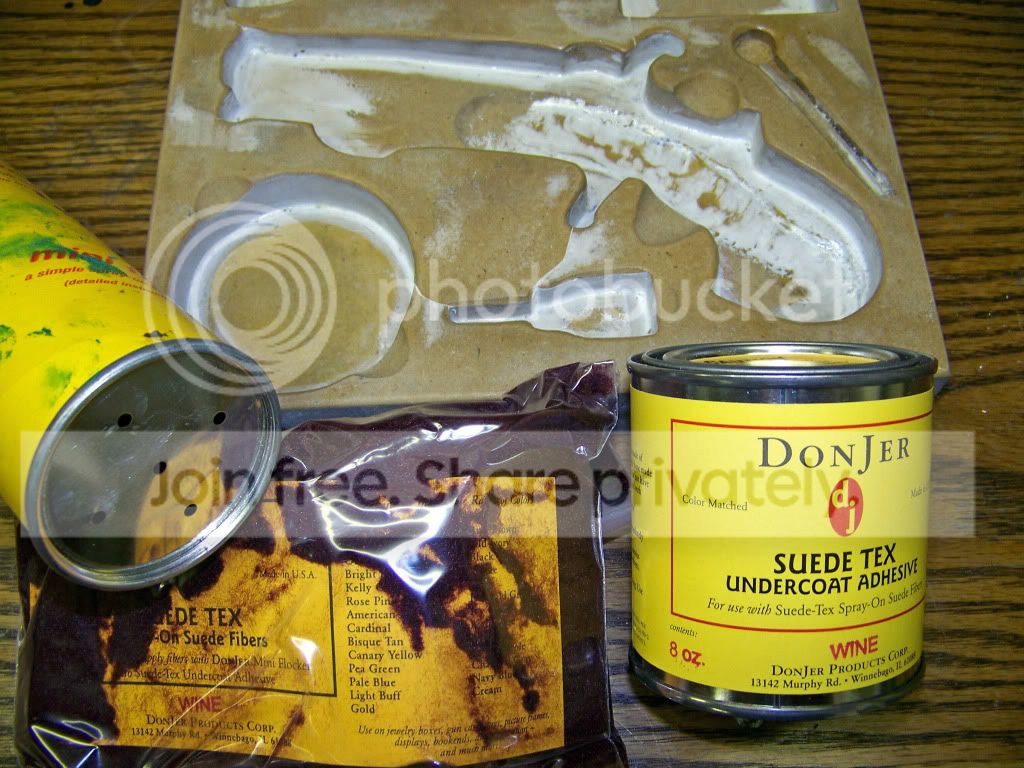

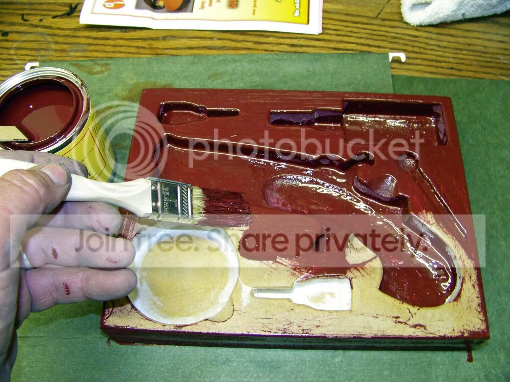

I had to order the flocking in the right color "Wine" and it came in today so I can get back on this project.

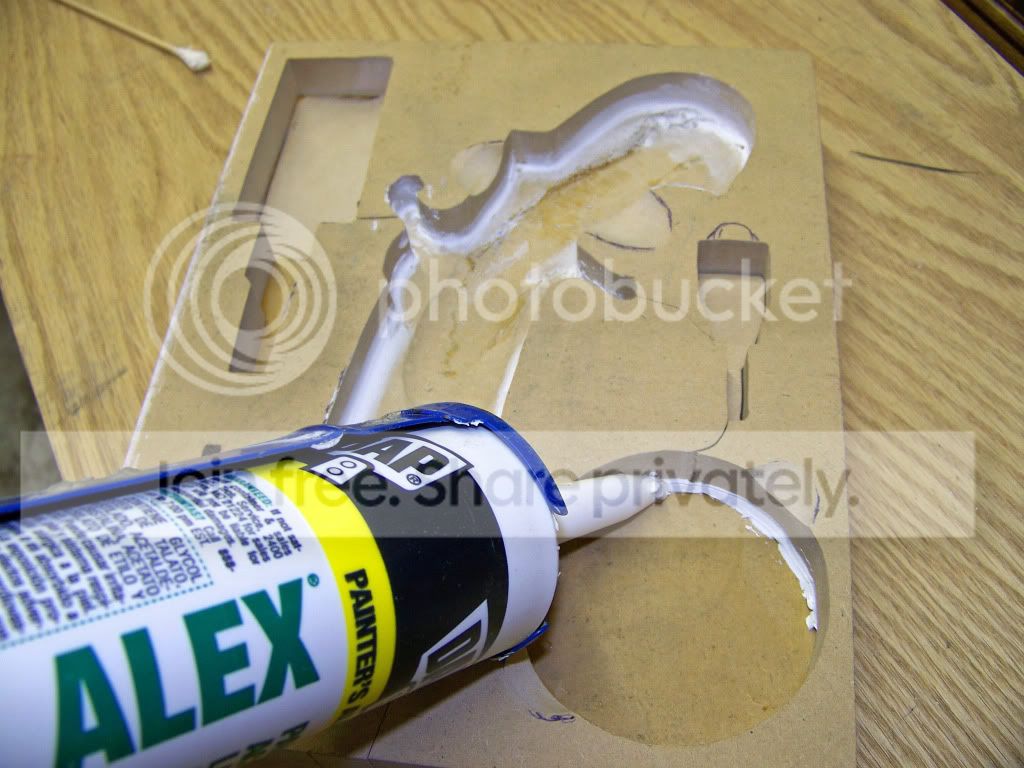

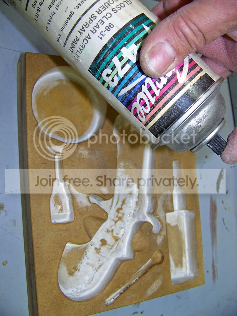

Here I am using painters caulk to fill the gaps around all the cut out inserts. Next I rounded all the sharp edges with the dremel and hand sanded them. Next I spayed the entire thing with spray laquer. Two coats to seal the wood.

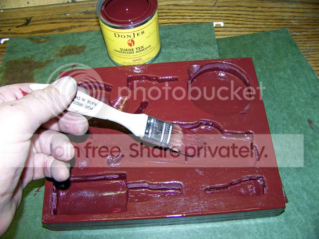

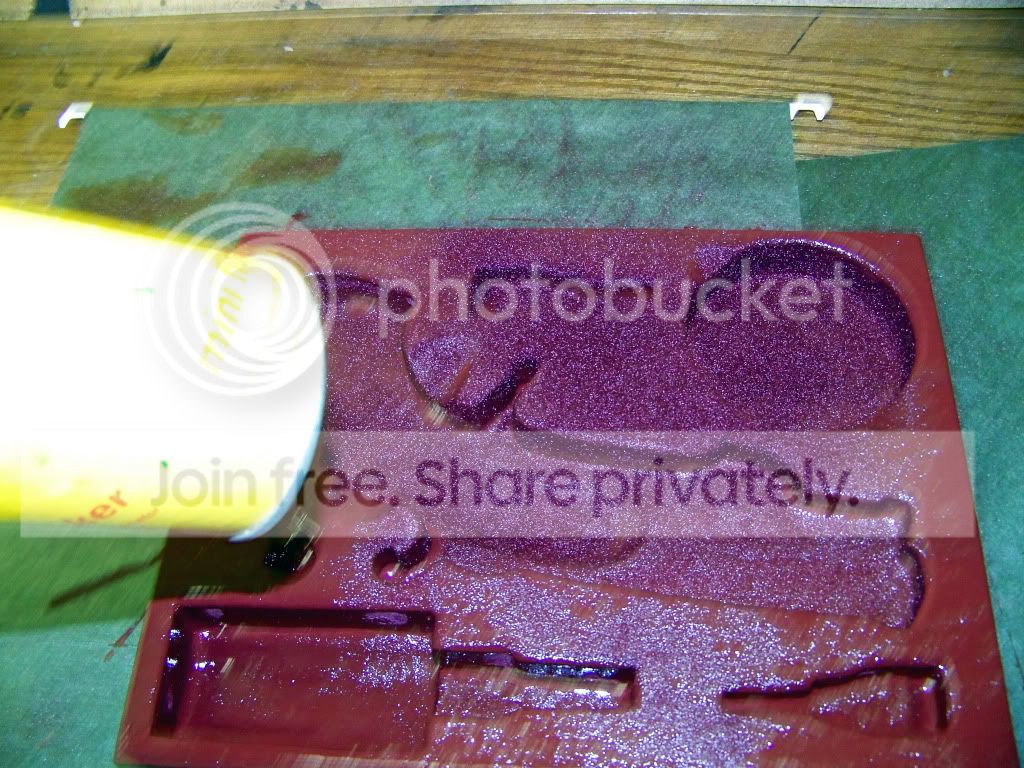

Here is the flocking kit. Its made by Don Jer and it works pretty good. It has an adhesvive (lead based paint) in the color of your choice and the same color of rayon fibers. The fibers go into the cardboard hand pump and get pumped onto the wet paint.
I painted it on as a primer coat and will give it the real treatment in the morning.
See those dry spots? Thats no good, the flocking wont stick there so I'm glad I'm giving it another coat.
I know it looks like hell right now but just wait until you see the flocking.
I had time today to flock the block. Here I'm painting the colored adhesive on thick and even. Next pump the colored rayon fibers onto the wet paint very thick because the excess will dump out after the paint dries. I forgot to flock the inside of the round brass bullet box so I will do that too.

a suggestion to you, for your glue, titebond 2 or 3 works worlds better than elmers
the bond of the 2 pieces of wood is stronger than the wood itself,

I dont think the elmers will let go with this kind of project.
