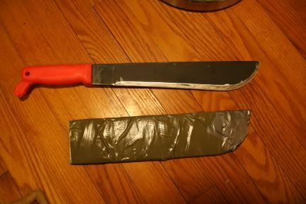

Could also make a cost effective machete sheath instead of the duct tape and carboard...hmmmm..

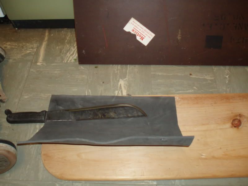

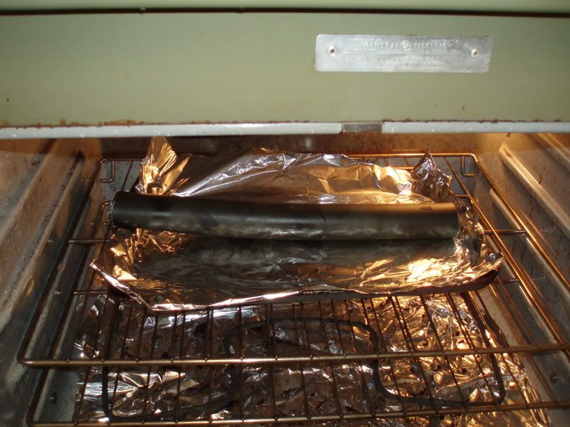

Ok. So the duct tape one I have won't do for tomm. I needed an upgrade and [color:red]QUICK.[/color]
Luke, remember that camo didjeredoo I brought to pwyp?

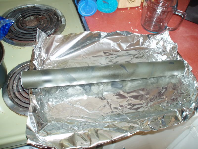

275 degrees, 20 mins
prep. It didn't work.
first run, used foam. DON't.
It didn't form well. We want quick and dirty... so I put the sleeve back and took the foam out.

Polyethelene (most laundry and milk jugs) doesn't take paint well either so that would be out as a UV protectant - there is always your good friend duct tape there to provide some UV protection, or a layer of ranger bands.
if you wipe HDPE down with acetone or give it a light flaming with a propane torch, this will leach out enough of the surface oils that it will accept paint - especially primers designed to stick to plastic.
another option is to hit the finished product with some 3M #77 or #99 spray adhesive and wrap the sheath/scabbard with a piece of fabric as a UV protectant and a way to hide the hideous and unnatural colors many buckets come in.
