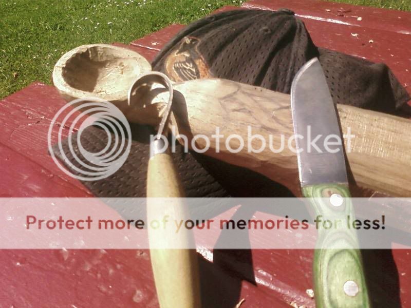

I am a recent convert to the ways of spooning. I've done it with just a regular knife, but having a bent knife for the bowl is definitely easier. The tighter bend bent knife from Frosts on Ragnar's forge is what I have been using. It works very well, but I'm planning on getting a better one soon, probably from Pinewood Forge.
If you are planning on just using a regular knife, I found the score and pry method works best for carving out the bowl. Score or trace around the edge of the area you want to remove, then use the tip of the knife to work into the wood and slice little pieces out. The scoring will prevent any accidental chipping from going too far and messing up the walls of the bowl.

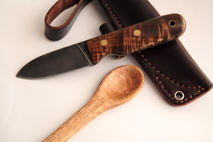

I carved this spoon just using my BHK Bushbaby.
I finished the inside of the bowl by scraping it with a rock. Then I immediately put it to use eating chili. :D

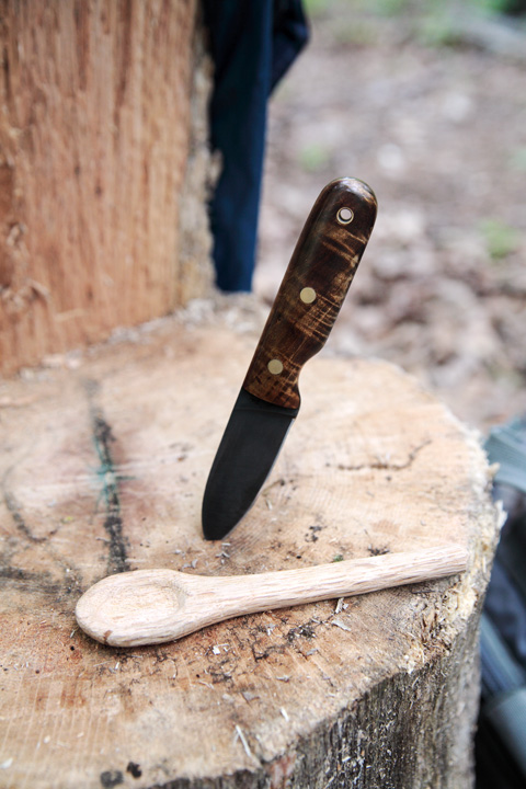

As you can see, once I got it home it finished up just fine:

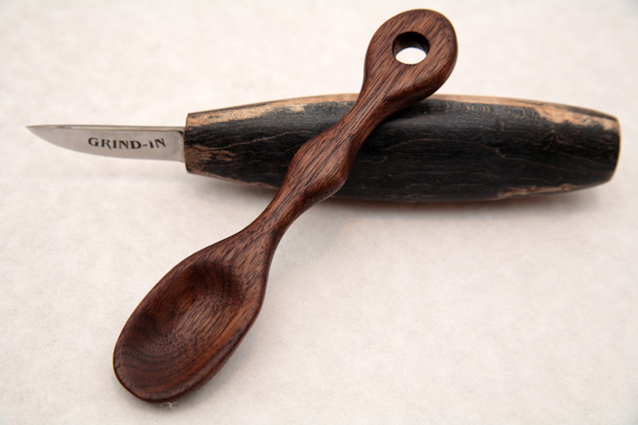

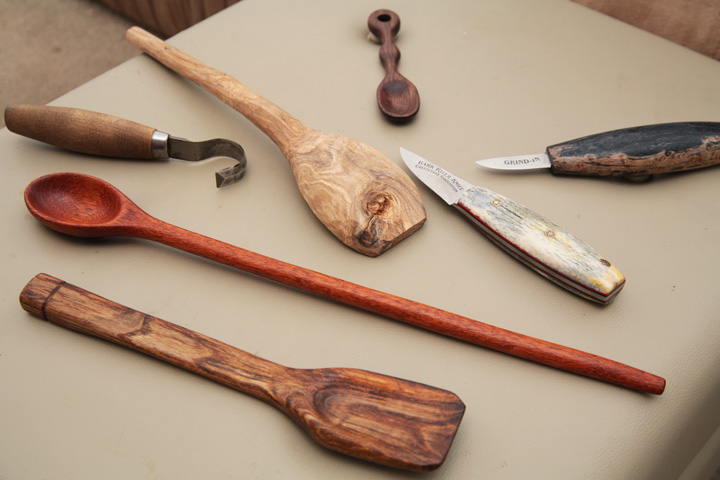

Here's a few I made in the past couple weeks:
This one took me about an hour to carve (not counting sanding or finishing):
I'm so stuck I even carved another one last night while Iron Chef was on!
Spooning is rather addictive. :D
Simms65, Nice spoons! What's that little carving knife with the red liners? It looks really handy.

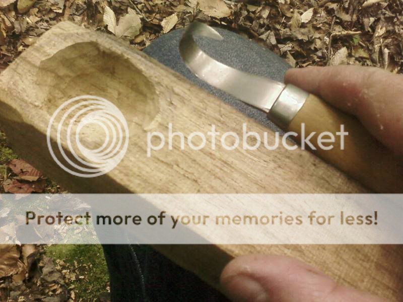

Oh, and to answer the OP question : I like to start with the bowl of the spoon first, as seen in this picture.
Then, go ahead and start shaping the rest of the spoon.

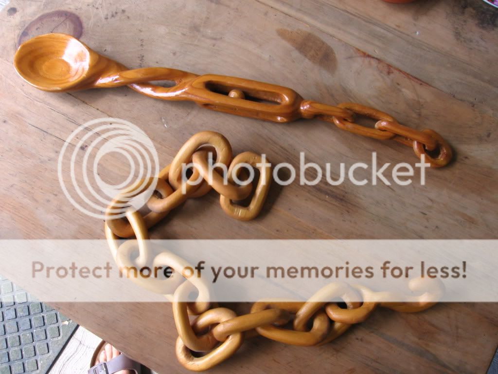

Here a quick pic of two of my dads pieces.
