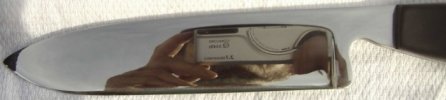

Alright guys here is the tutorial I said I would do. I did make a mistake. On this full flat ground blade I should have started with a 320 grit sandpaper or something, as I had a few light grind marks in it. Live and learn. Thanks to all who watch, and to those who have subscribed. More stuff to come.

good stuff. I have a dremel so it'll probably take me a bit longer. hopefully I can find the right grit sanding wheels for it.
good job! where'd u pick up the discs from, lowes?
I get them from work. My Dad works in a body shop at a Marina and he gets them through Ridge Napa. The paper costs about 1$ a sheet but like I said, 3M makes the best stuff IMO and my Dads. So its worth it.

There is not enough surface area on Dremel accessories to give an even finish.
You can hand sant to 2500 grit or higher, and then hand polish with Simichrome or similar polish
it may be difficult but it's not impossible plus the blade I'm planning to do this to has a very narrow profile unlike the spyderco in the vid, roughly the size of my index finger. I have a handful of crappy stainless 1911 mags laying around that I'm going to practice on first and if it really is that hard to do then I'll try it by hand.
You won't get an even surface finish.
I have been using rotary tools and polishing metals for almost 40 years. Try the hand sanding.
steel130, when you come down i'll show you how i put the mirror finish on kalama :D kalama.jpg
anyone else can send me an email with your phone number and i'll tell you how i done it. (i dont feel like typing it out :D) its hard work with or without power tools and it can be aggrivating but the knife will look good when you are done. it will take a little longer without powertools and a buffer to put the final polish on.
