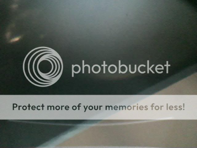

I honestly don't think it's a microbevel. I've been using the Magna-Guide system for the DMT Diafolds for all my strokes, so I'm pretty sure the angles are consistent. When I'm stropping I'm probably raising the angle a bit, but not enough to make that significant of a microbevel.
Here are the pictures:
50 strokes per side on Fine Diafold.

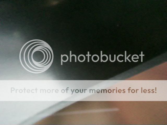

50 strokes per side on EF Diafold.

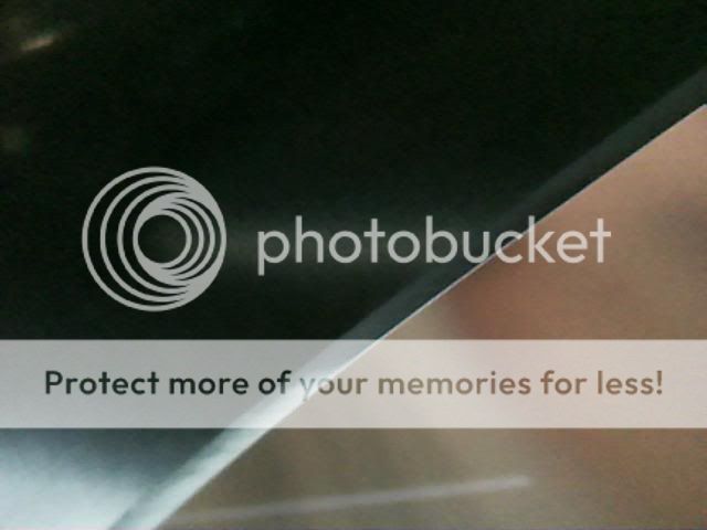

50 strokes per side on 6 micron DMT diamond paste strop.

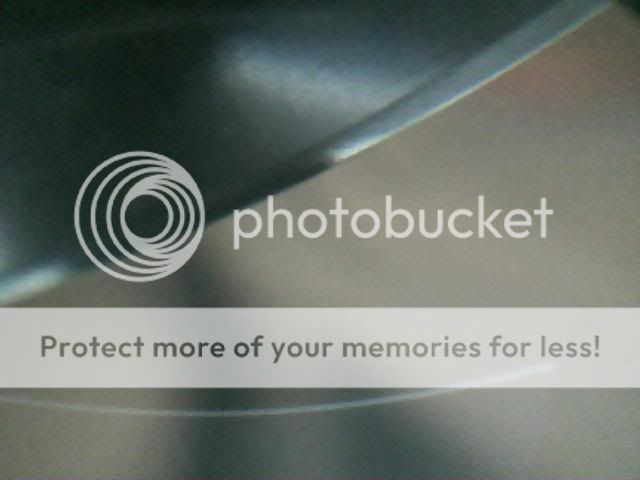

25 strokes per side on 1 micron diamond spray strop.
I know I sound like a broken record but pressure is of extreme importance with diamond products. When using your DMT stones feather weight contact and less is what should be used. I sometimes use decreasing amounts of pressure and with a single abrasive can create multiple scratch patterns.
Also when you use strop compounds your progress will run in stages and is similar to the stages of the stones.
In the first few strokes the edge will usually become sharper or seem so and the burr if any seems to go away. In the next stage the edge will actually feel duller but exibit a change in finish and sometimes this is where a burr comes back. last but far from least is when the edge is showing nothing but the scratch pattern from the abrasive being used and the sharpness has peaked out, or can't get any sharper. If your blade is 154CM this should take 30 to 60 minutes to do depending on how fast or slow you like to strop. harder steels will take even longer.
A microbevel is something else that could be a issue. Look close at the edge, a single wrong stroke on the EF stone could be thhe cause of all your problems.
You also might want to use the 1 micron to brighten the surface, this will help too show all the mistakes at the previous grits.

Yes without a doubt you need to work every grit longer. When you finish with 1 micron the edge should be a mirror and nothing less, not even a scratch pattern.
Your doing it right just not doing it enough. And yes use even lighter pressure.

This answer is correct... everything you've posted says you don't have a burr... you're stropping higher than your sharpening, which is why the very edge is shinier than the rest... and probably dulling your edge. Read Twindog's recent thread....
http://www.bladeforums.com/forums/showthread.php?t=750008
You're not going to create a burr that big that you couldn't easily tell it was a burr with the other ways to detect it described in this (and other) threads.
Follow knifenut's advice and strop it on a harder surface (or at least mount your leather better), and I'll bet your problem is solved.
